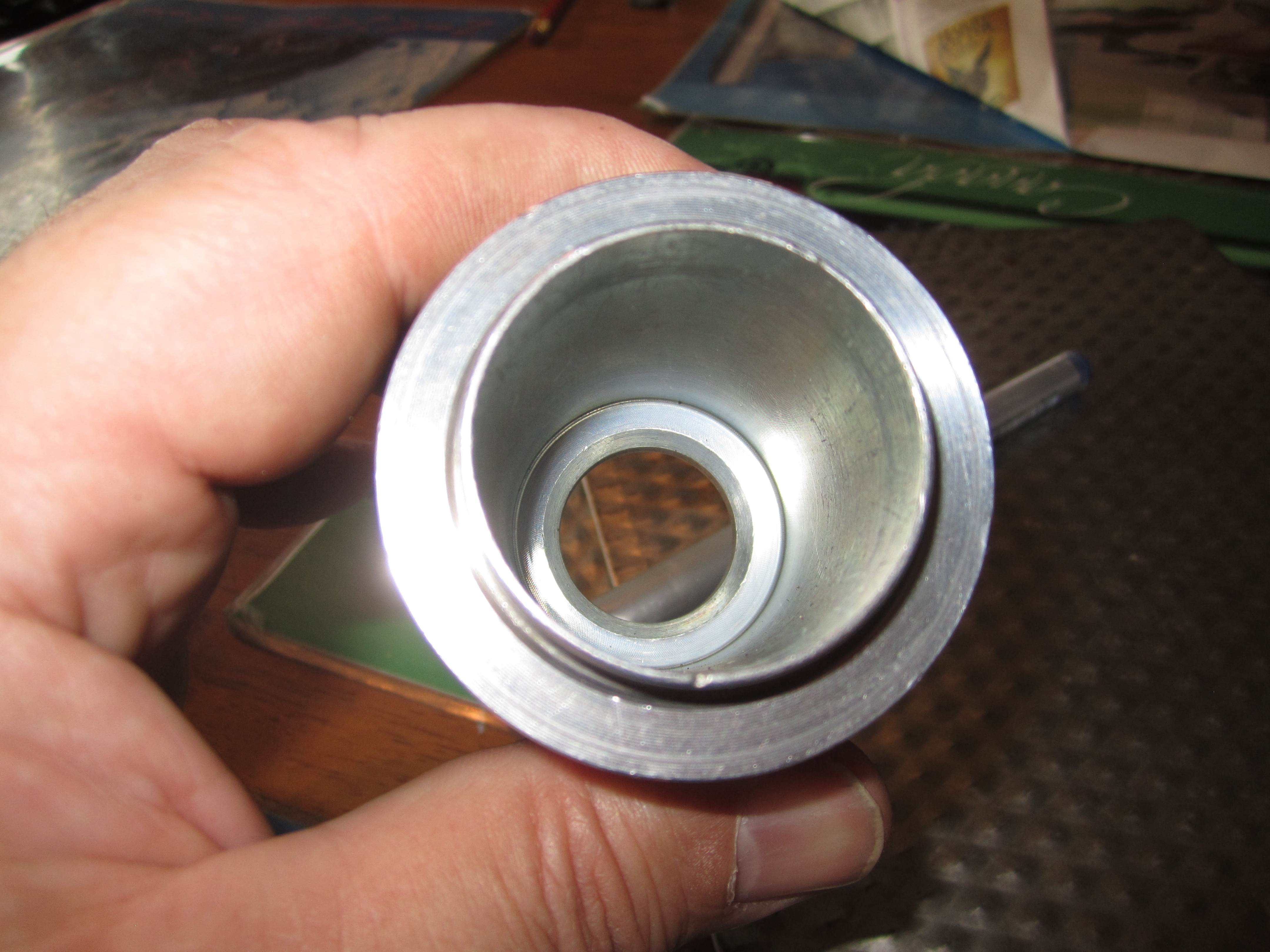

As mentioned I had a full set of the tools make out of aluminum. I'm having the crank tool tweaked so the seal can be driven in with the crank pulley nut. The ones I had made for the crank were to long to drive it in with the nut. A Volvo mechanic I met with said that driving it in with a washer and the nut is the safest way to do it.
I'll probably make a video later today and post it tomorrow sometime. (I'm having serious back issues now, ouch! Spend 7 hours at the VA hospital yesterday). You can use the seal dimensions to manufacture the tools. The ones I have seen were made out of a plastic (at 2 different shops).
Engine seal press
Engine seal press
