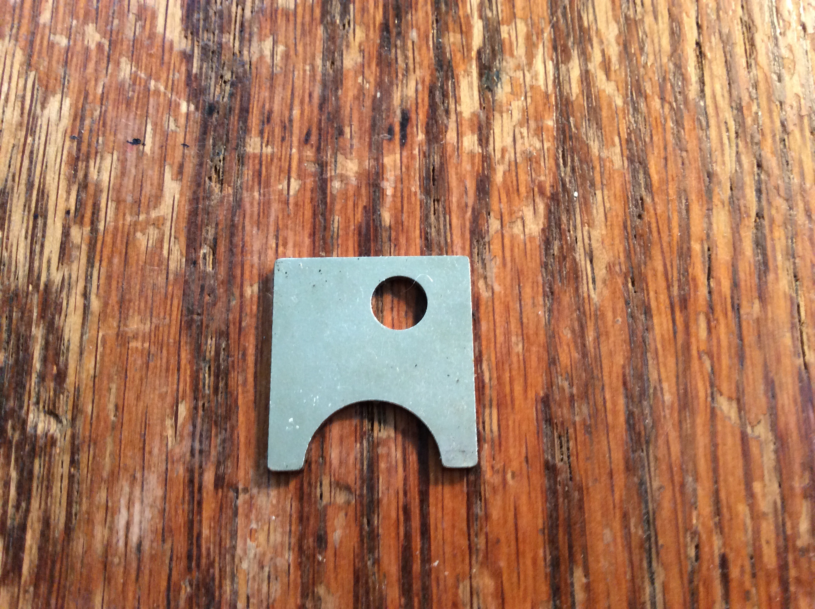

To remove the fuel line from the fuel rail remove the T25 screw. Then the square bracket plate comes out. The fuel line is pulled out. "O" rings on the tip of the fuel line should be shot with WD40 hopefully preventing the "O" from tearing. Here is a picture of that square plate.

Would anyone happen to know the particular name of that little metal piece? I dropped mine into the abyss (behind the intake manifold) and have been trying to find a replacement, or alternative means of fastening to no avail.
