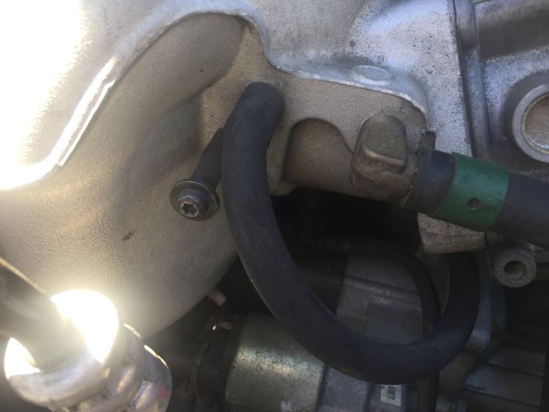

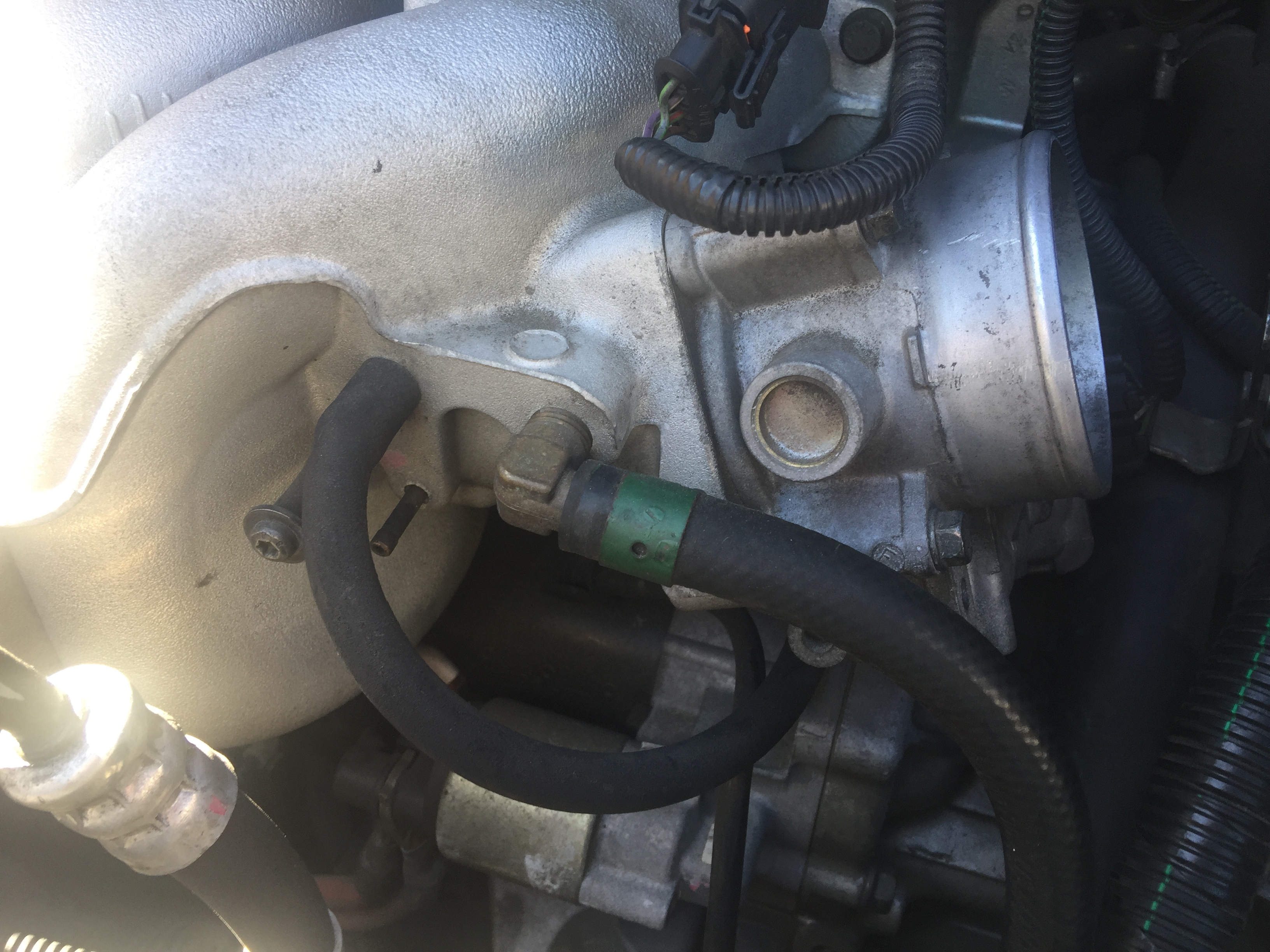

I found the map sensor and the hose going to the plug after the throttle body was disconnected so i looked and connected everything. Now i have to source the pieces and hoses that go to the air filter box.. could the disconnected hose on the map sensor cause weird inconsistencies while driving?
- Posts: 36142
Yes. Enrique. You also have an open vacuum port on the manifold in.The picture above. That needs either a hose or a plug.
Find the vacuum hose picture under the hood to see what's missing.
It might be the air cleaner thermostat vacuum motor

My air cleaner box is missing the thermostat and intake pipes that take fresh air from the grill, so the air box is basically just sitting there pulling hot air from inside the hood
On a positive note, after connecting the hoses to the map sensor, the car starts right up even when cold and pulls much better

The car runs better now but it's now getting obd code p0106 which is for MAP sensor out of range.. is it safe to say that this is related to the missing pipes that go to the air filter vaccum plugs?
enriquepr21
- Posts: 51
- Joined: 15 Nov 2016, 20:58
- Year and Model: 2003 S60
- Location: Guatemala
What's weird is that there was no codes when the map sensor had the hose disconnected. Really strange i think
