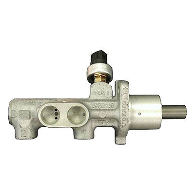

I noticed fluid leaking around the plug at the bottom of the fluid reservoir is there a gasket that can be replaced or am I looking at replacing the module?The plugin on top leaking around that pretty good

Hi, are you talking about the brake pressure sensor? If so, yes, there's an o-ring there. I don't believe that sensor is available new anymore. So you would have to get one from a junkyard if you want to replace it. I'm sure just the o-ring goes bad on that. Make sure you have a bunch of sizes on hand because you don't want your brake master cylinder to dry out because you took that switch off and drove around for hours (days...) looking for a suitable o-ring!tom4342 wrote: 14 May 2017, 19:43 brake.jpgI noticed fluid leaking around the plug at the bottom of the fluid reservoir is there a gasket that can be replaced or am I looking at replacing the module?The plugin on top leaking around that pretty good
Robert Spinner has a video on taking that thing out https://www.youtube.com/watch?v=rhDAgSJmjAc
There are also o-rings around the base of the brake fluid reservoir.
What I'd do to try to isolate your drip is to really stick your finger with a napkin on it and try and touch where exactly you're leaking from. Touch different parts throughout and see what you find.
I don't know how to fix that cap... I don't think mine has ever been dry on the outside...

Make sure you aren't leaking from above. It's really hard to accurately pinpoint these leaks (hence using paper to see what's wet and what isn't). I have come to believe most of these leaks are probably master cylinder leaks... And man, is that a doozy... Good luck.

Definitely the switch leaking go figure I wonder if this is why the check engine light is staying on? I ran my scanner and showed no codes and the brake light is staying on even though I filled the reservoir.

It's definitely connected to something so I would imagine it could trip a check engine light.
I might try to pick up some o-rings, take it out the sensor and clean the electrodes with electric parts cleaner and put on a new o-ring on it and hope it doesn't leak...
Seems like the used MCs on eBay come with the sensor. So maybe you want to go that route...
http://www.ebay.com/itm/99-00-98-volvo- ... IA&vxp=mtr
Make sure you find some o-rings that are compatible with brake fluid...

The again, Harbor Freight says these nitrile o-rings are compatible with hydraulic fluid... https://www.harborfreight.com/225-piece ... 67677.html
You're looking for something you could roll onto something smaller than a pencil.
