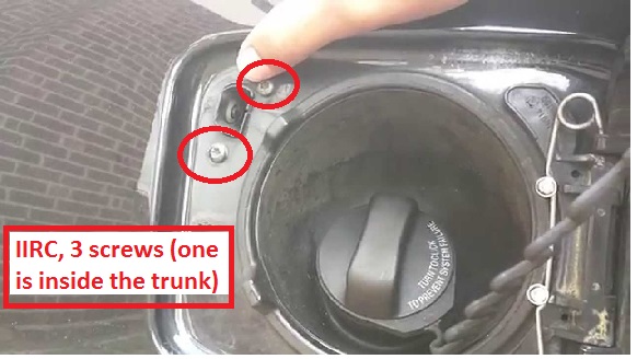

Sometimes car is driven by my kids/wife, so I make it easy for them by installing an emergency pull in the trunk, WITHOUT having to remove the side carpet trim. Here is how I do it:
* Undo the release mechanism (3 Torx screws, IIRC).
* I used RED electrical wire (the solid copper wire used in household wiring).
* One end wrapped around the tip of the electric motor, the other end sticking into the TRUNK (with a loop to pull).
This way when I can't open the fuel door, all I have to do is open the trunk and pull on the RED wire, no need to peel off carpet trim.
* It is a 10-min mod.
