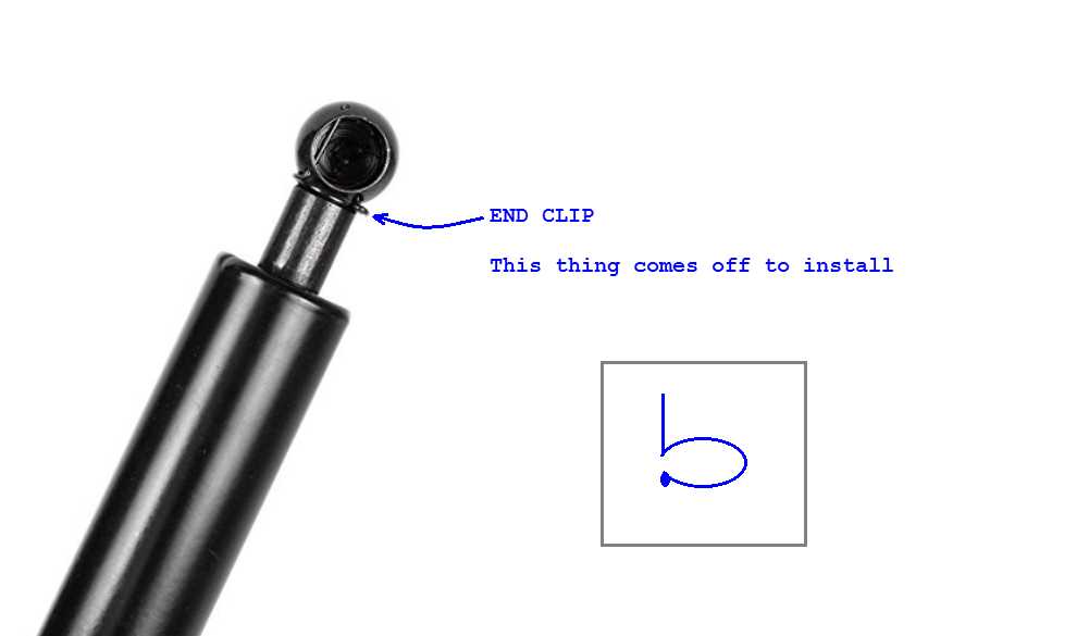

Hi there,
The end clips are tiny pins that push though the end of the gas spring. They came with the gas springs.
The gas springs have tiny holes about 1/16 inch diameter at each end where they fit onto the ball. The end clips have one straight part that goes though the holes. Once the clips are in place, it is impossible or nearly impossible to pull the gas spring off of the ball. Without that end clip, the ends of the gas spring can be pushed off of the ball.
However, the old gas springs had the tiny holes too but NO end clips installed.
The instructions that came with the gas springs say that we should remove the end clips, install the new gas spring, then put back the end clips AFTER the gas spring is installed. That obviously helps to keep the gas spring on the ball joints so that it can never come off.
Since the old one did not have the clips installed, i had to wonder if they were really needed or not. The tunny thing is, none of the videos i have seen so far do not even mention these end clips.
I will try to get a picture of one of these end clips, one loose and one installed on a gas spring.
Here is a picture of the end of the gas spring. The clip is shown fit around the body of the end. It also has a straight part that goes through the tiny holes in the ends of the gas spring which is not visible in the pic, but is visible in the approximate drawing. Oh wait, i just looked again and i see the straight part showing though the ball hole in the end.

Hi,MDK wrote: 04 Jun 2018, 15:00 Yes Mr Al...on 98 xc70 ... I used a push broom to hold rear hatch open and do one side at a time. I used a big flat blade screw driver to "pop off" shock and then pop off the other end at roof point. Clips should be internal on those. I place the shock on roof pin and pull...real hard ...and then put other end onto the lift gate. I've done it a few times. Just make sure that the black part of it goes to roof point.... hope this helps
I am sorry i dont completely understand what you are saying here.
The clips on these are removable and you have to remove them to get them on. Once on, they can be put back on.
They are tiny pieces of spring steel wire that fit through the tiny holes at the ends of each spring. So there are two clips per spring, four in total for both springs.
I show a pic and approximate drawing in the previous post.
