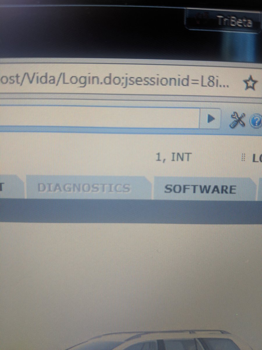

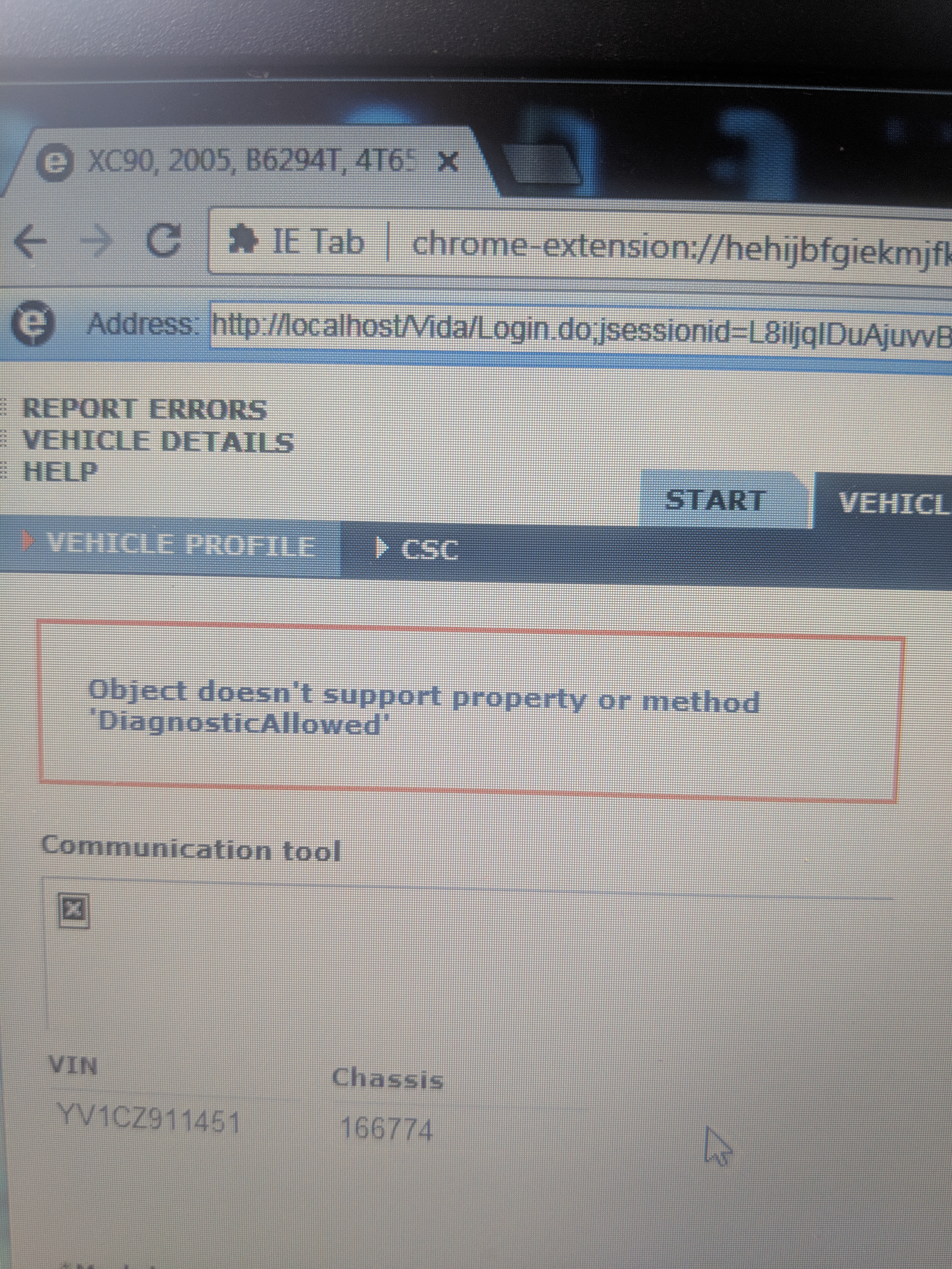

Thanks for all the info guys!! I have a used CEM. I have Vida now , but I keep getting an error message (object doesn't support property or method "diagnostic allowed". . I'm not finding any concrete thru searching.

Talk with Xemodex and explain them the whole issue. They know these things in and out. And I think it can be fixed if you still have the original CEM, fried or not.
