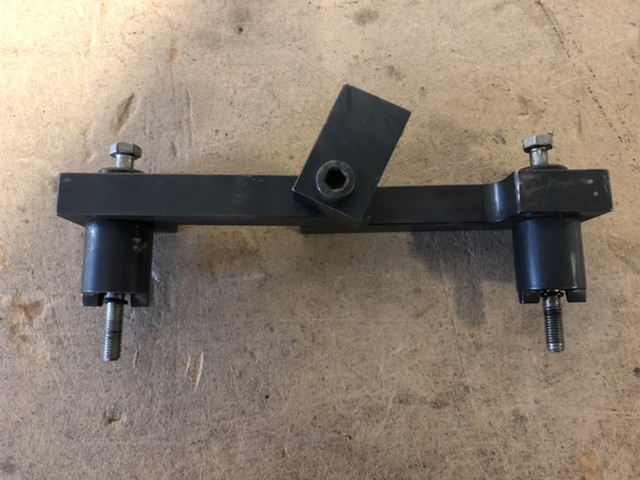

Sorry to overpost yesterday. Was kind of freaking out.. cooled down and collected my thoughts. So I borrowed the tool to lock the cams.. but it’s the short version, doesn’t have the extensions I see on some of the options online. Does anybody know if the 06 S80 requires the extensions? I’m not sure I need it since I have marks I just wanted to use it as extra precaution. What I’ve surmised is my intake cam is dead on.. its clockwise rotation stops on my yellow timing mark I painted at the beginning of this nightmare. My exhaust cam is still out 1/2 tooth, the clockwise rotation ends in the valley just to the left of the correct tooth. So I need to tweak that cam the 1/2 tooth and I’m ready to move ahead.
Anybody want to confirm my analysis?

Just to put a bow on this.. car is back together, runs great no CEL.. all the doom and gloom was me over-reacting.. locked the cams in the rear, crank on the mark. Put the belt back on using my original marks, like CN90 had said I believe in a tbelt guide all the cars cares about is that the teeth are x many teeth apart.. 62 teeth (yours may be different) between the mark I made on the rear side of the crank pulley and 18 teeth between the intake and exhaust cams.
