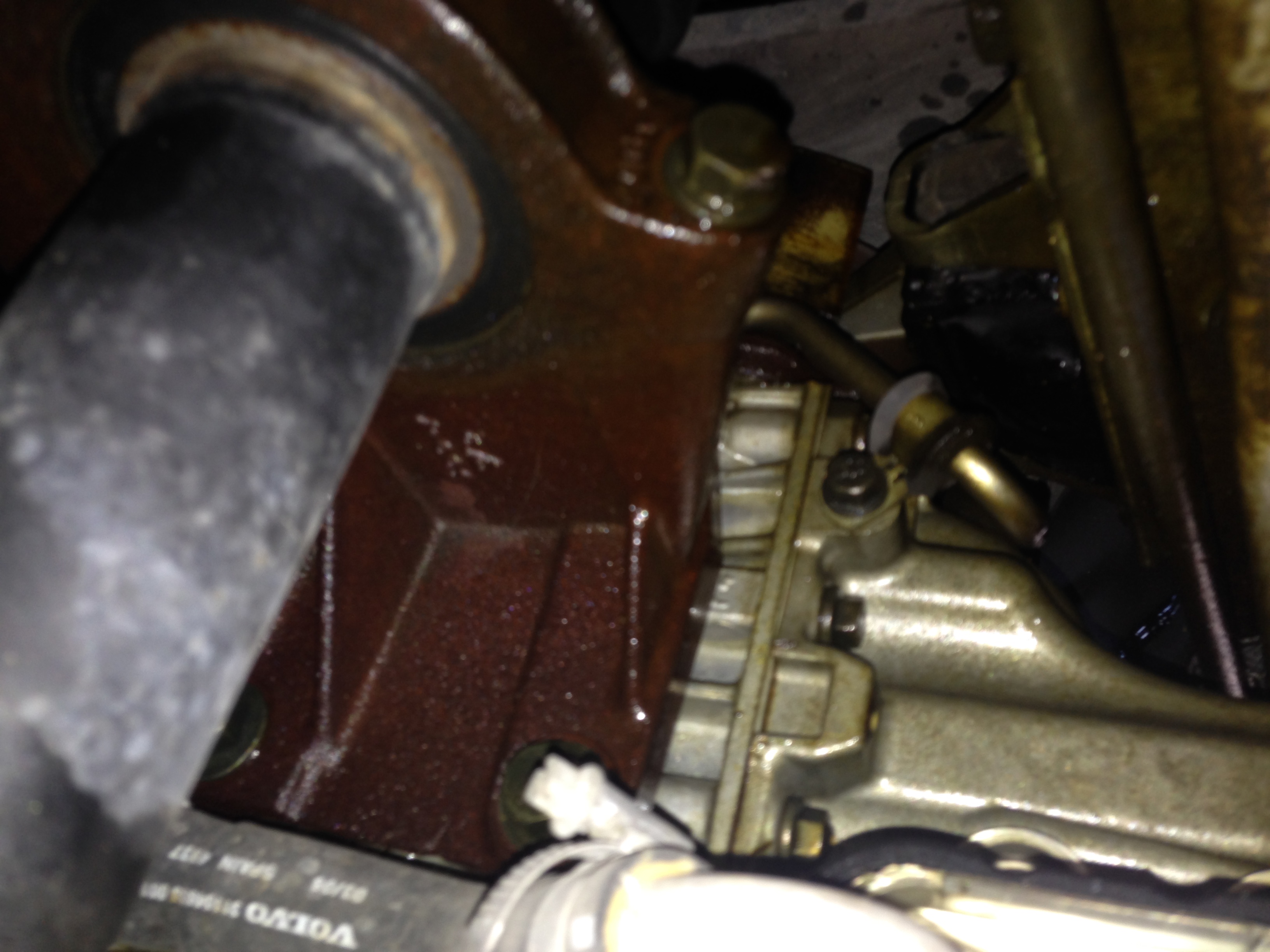

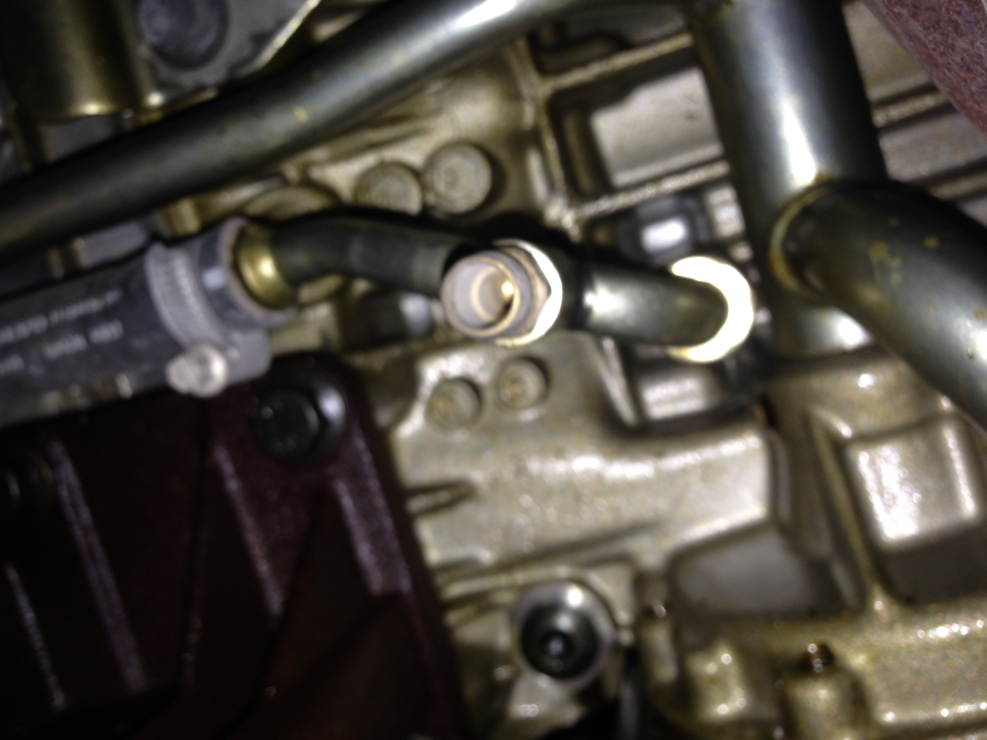

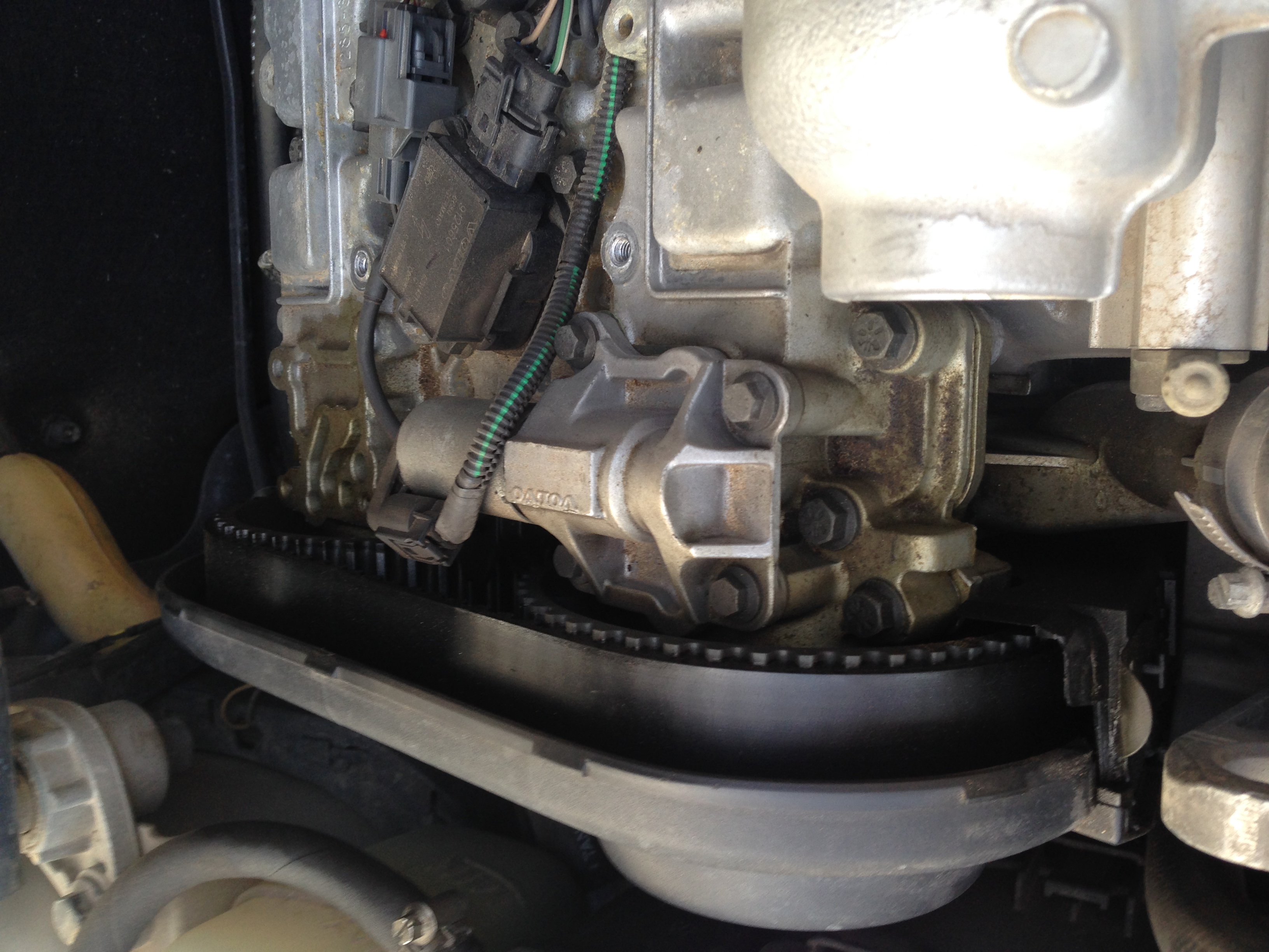

I noticed an oil leak on the passenger side of the engine, near the time belt area, at the backside of the engine.
I took one part of the timing belt cover off and could see some traces of oil in that area, but I was not able find the oil leak just by a visual inspection.
The car has 160k+ miles on it and the timing belt has been replaced at 100k miles.
Here some pictures of the timing belt area, where it looks like the belt somehow picks up some oil:

Looks like a possible exhaust cam seal? Seems to be above where the waterpump housing is so could also be valve cover?
More pictures from above on the firewall side might be helpful.
