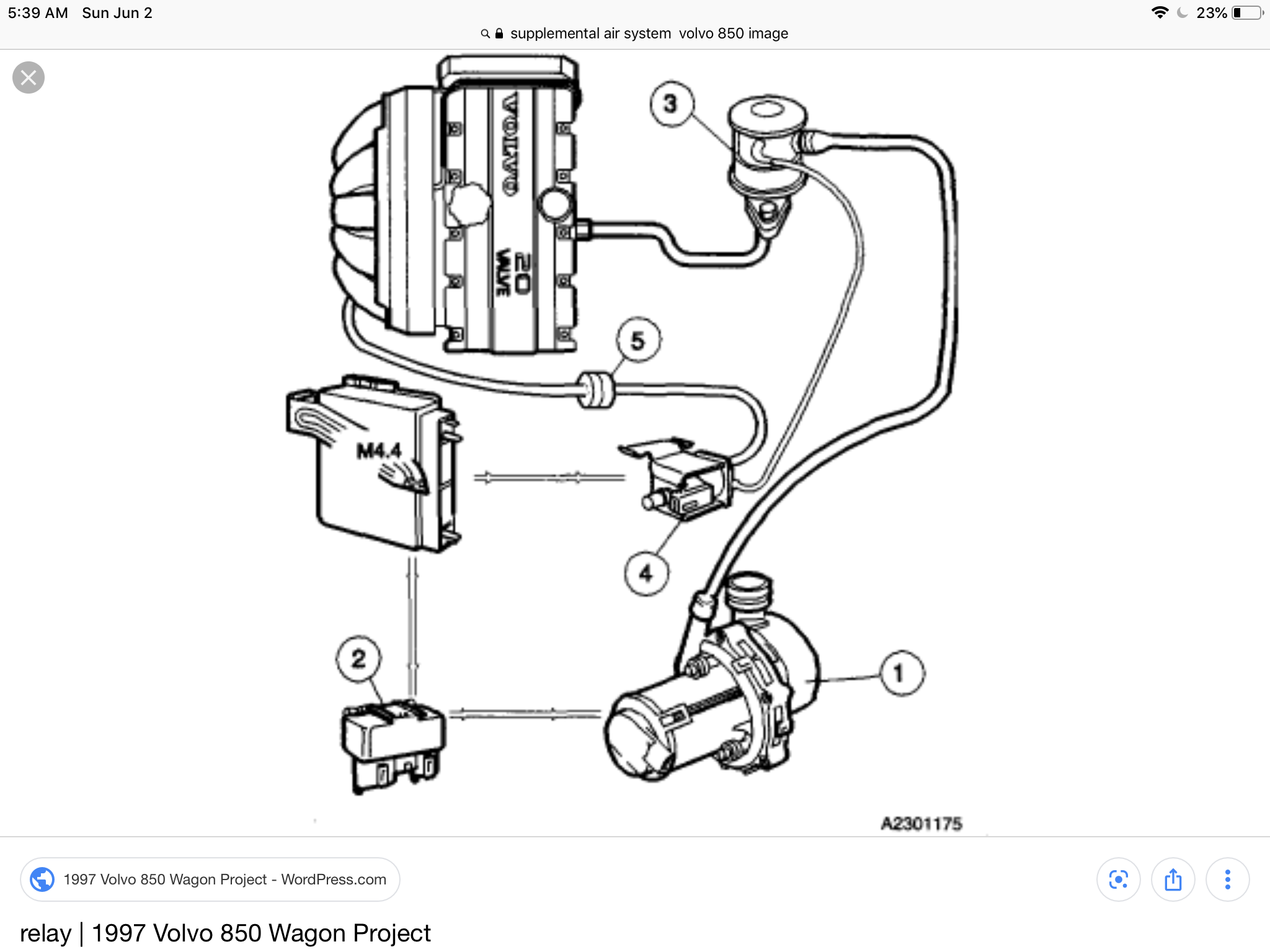

You can confirm the presence of SAS by the tube running behind you’re engine with a domed valve connection.
Erik nailed it above, as usual.
Google search “supplemental air System Volvo 850” returns.....

Volvo has been sending out airborne bulletins for years trying to inform people of what that sound is - you just have to be aware..
- Screen Shot 2019-06-03 at 9.26.11 AM.png (460.66 KiB) Viewed 1996 times
