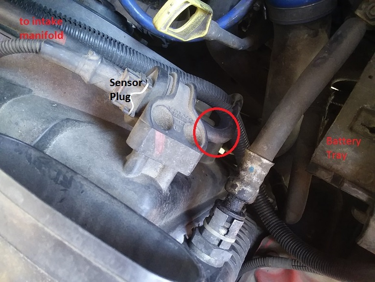

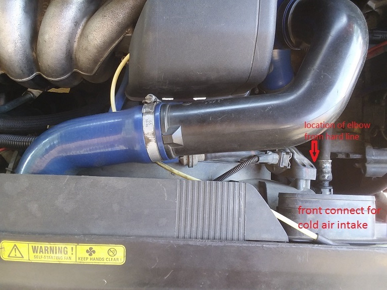

Here are a couple of pics of my 1997 850R. I have removed the cold air intake that fits from alongside the radiator to the air filter housing. This connection is the evap purge valve in my car. Of course this is a USA spec car and these parts may not be the same as yours. The elbow is not visible in the top photo and circled in red in the second photo.
Gary

You should consider just replacing all vacuum hoses, the 25 year-old rubber is probably disintegrating in many places.
Look at the white sticker on the underside of the hood for your car's particular setup, but overall all turbos 95-98 have the same vacuum line routings: viewtopic.php?t=63615
If your car has EGR that makes for a few extra lines under the intake manifold to pay attention to.
