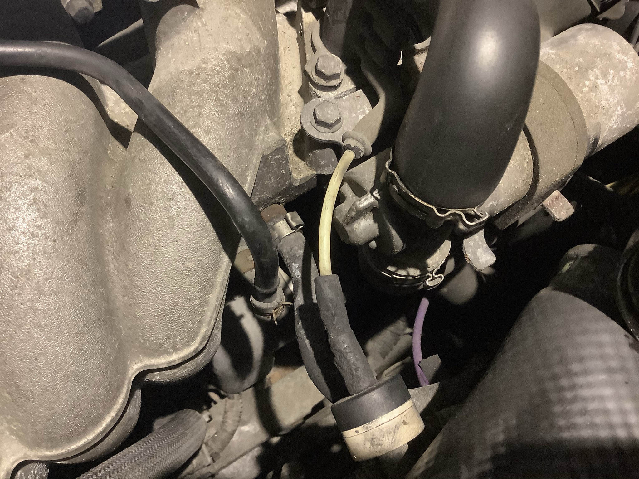

Does a ‘98 S70 GLT come equipped with an EGR?
If I am not mistaken, I did not see an EGR tube. I could be looking incorrectly.

Look on your emissions sticker under the. Hood. Models in a given year are equipped differently but the aticker and vacuum hose diagram will tell you what was put on your cAr
That purple line looks like SAS hardwarw
