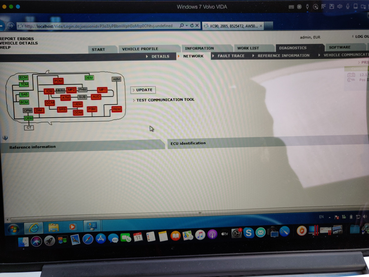

Background: I've got a DICE unit off eBay and the tests for DICE diagnostic passes. Installation of VIDA has been all good. Reading car Vin and details works fine.
Issue: When I go over to the Vida diagnostic tab, I have run into a wired issue where certain modules at the front of the network diagram reads and everything else (middle-back) has a no communication message.

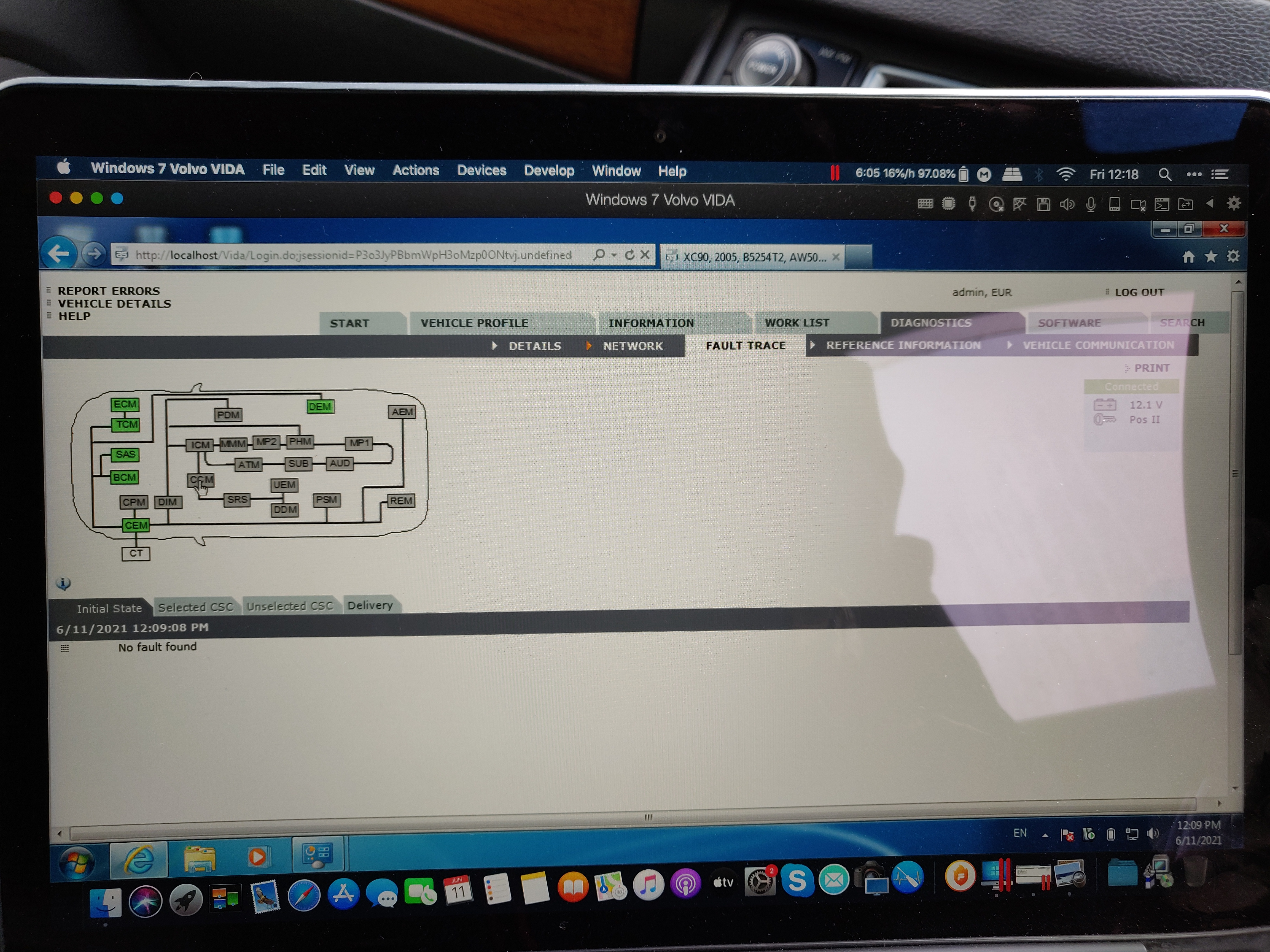

Fault tracing shows no issues on the ones that communicate with DICE/VIDA. The ones that do not are greyed out. I am not sure what the problem is and what I can do, so I am hoping someone can shed some light on the problem.
See attachments for my explanation above

Thanks for the reply @RickHaleParker. I will make some time to do the visual checks.RickHaleParker wrote: 10 Jun 2021, 22:10 Pull the CEM out and check for water damage. Clean all the electrical connectors and reinstall.
A noob question though: I used an Autel scanner (Maxdiag MD 806 pro) which I have used/borrowed in the past to see if It can scan all modules and if there faults recorded (or a no communication message). It scanned through and gave a pass result on all modules; so I'm wondering if the comms link to the rest of the modules is via CEM; how is a third party scanner able to establish a link and VIDA via DICE is unable to achieve the same?

The person I borrowed it from had gotten this particular unit as he was having some weird issues in the past. This unit gave him a no comms message CEM of his car ( showed me the screenshot). So I watched this scan on my car and it did go through all the modules which are the ones VIDA was trying to connect to as well. Fairly certain this model is quite specific with which modules it looks at, as it connects to the vehicle model after a VIN pull just as DICE.RickHaleParker wrote: 14 Jun 2021, 02:05Are you sure you are interpreting the Maxidiag MD806 pro correctly? Cannot find any faults without communication.chrisjack wrote: 13 Jun 2021, 20:14 It scanned through and gave a pass result on all modules; so I'm wondering if the comms link to the rest of the modules is via CEM; how is a third party scanner able to establish a link and VIDA via DICE is unable to achieve the same?
Vida knows what modules could be there. Does Maxidiag ?
Quite confused.....

One note that may be helpful: All of the modules that are working are on the High Speed CAN bus, and the ones that are not working are on the low speed CAN bus. The DiCE can communicate with both, through the CEM. (DiCE has wires that go to each bus.) Thus, something is suspect on the bus, or one of the modules causing an issue.
