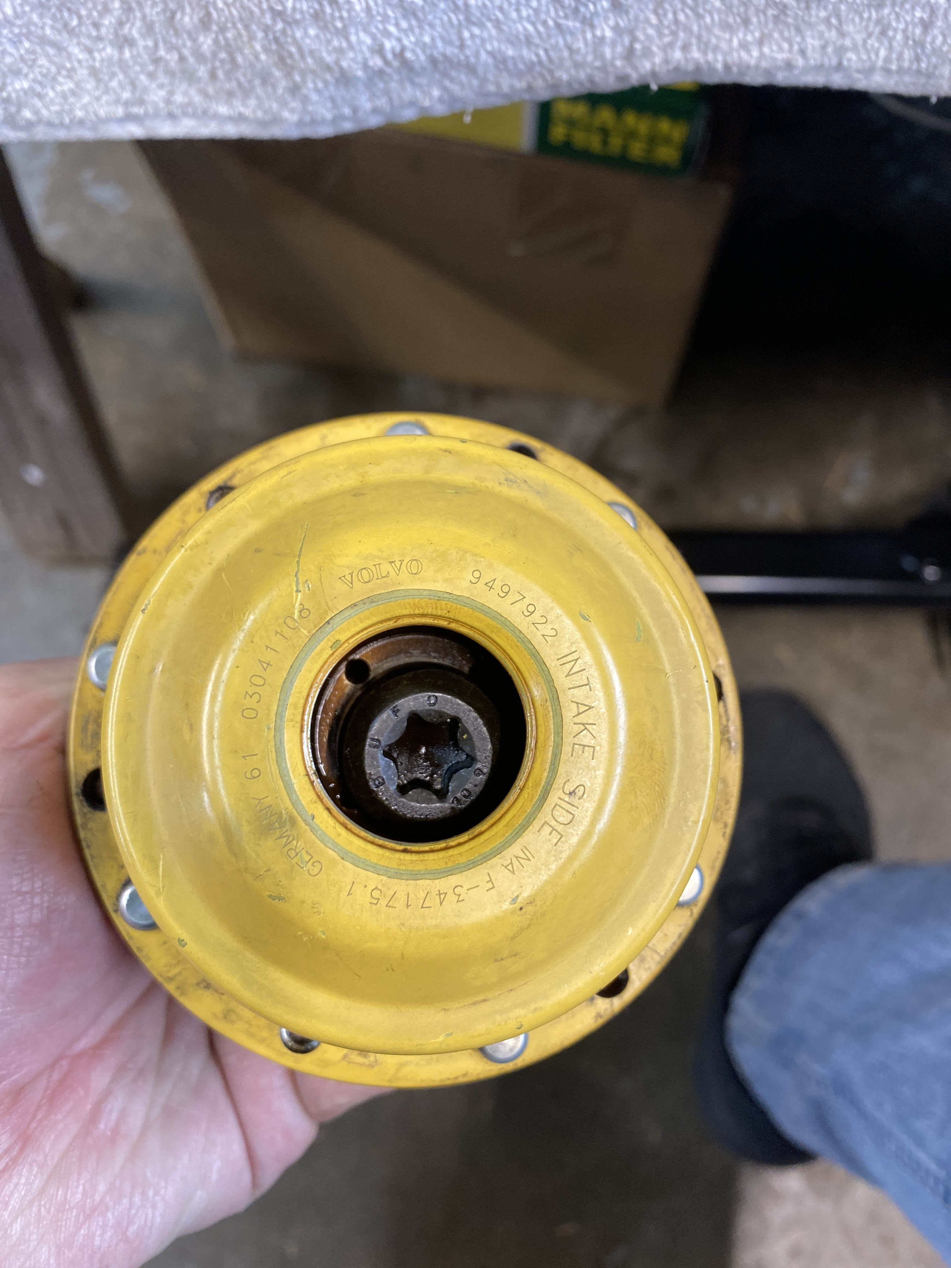

Valves are good. Looks like I didn’t have the timing gears torqued down so the cam wasn’t moving. The rear was but not the intake. Whew!!!
Does anyone know how he torque spec for the variable cone on the cams?

Center bolt torque is 88ft lbs.

I have pulled the cam cover and cams. I will boroscope the valve positions again to see if they are closed or open. I will place the cam cover back in and set up the VVT according to what I’ve researched. Making sure I get that 88flb. Then turn it over a coupled of times as I have someone watch the backs.
