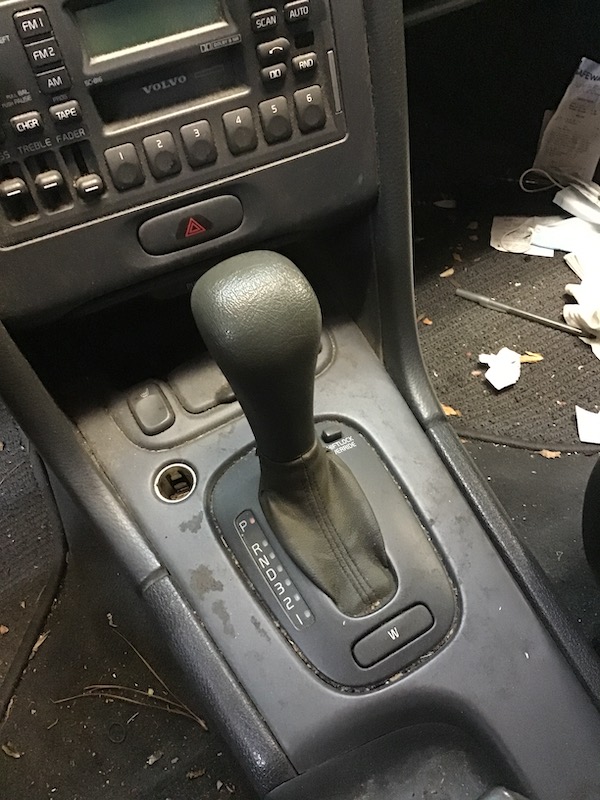

volvo shifter.jpeg (143.65 KiB) Viewed 1250 times
Engine running perfect
This is AW50-42LE transmission
Owners manual is equivocal on wither it is 4 vs 5 speed
starts from stationary real real slow, then seeming normal above 5 or 7 mph
I wonder is it stuck in winter mode with sluggish moveing from stationary
After collision:
no more vertical arrow on dash while in postion 3,2,or 1
no more horn
the posted gear shift lever ..... P N D 3 2 1 robert says it is 5 speed
can anyone comment or verify, is this 4 spd or is it 5 spd?

Posts: 35293
Has thanked: 1503 times
Been thanked: 3817 times
It’s a 4 speed. Aw55-xx denotes a five speed.
Look at the plate in the transmission to confirm. Don’t rely on paperwork and internet for point info like this
If you used an aftermarket pnp, they suck
Try this test. Drive the car with and without the W button depressed. It should be noticeably different on driving from a stop.
If it isn’t, you are stuck in W mode

inspecting trans label, on top of trans along mating with engine: its AW50-42 LE, my understanding is 4 spd, thx for confirm
PNP is from Volvo
The W button does not seem to change the way is operates far as I can tell, button does not light up,
Posts: 35293
Bit sounds like you are stuck in W
My daughters dog likes to push the W button on her Car on the highway. You don’t notice it until you stop , then go to restart and have no power ( your car is in 2 or 3 gear and torque is reduced )
