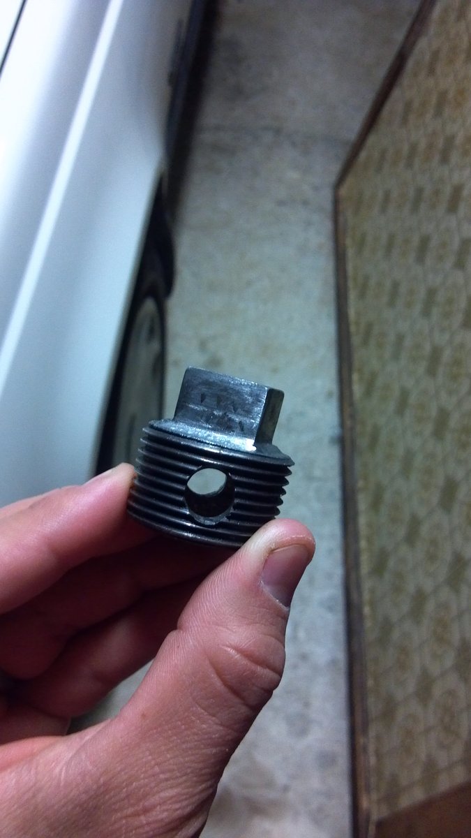

Found a post from someone else on how to make a serpentine belt tool. For a 1.99$ get a pipe cap, grind it with a metal grinder ( duh
) and then drill a hole through the thread area and use a metal bar to give it some force, I used a big drill bit i had around my garage. It worked just fine. Thanks to the person who came up with this idea, just thought I would spread it and save you 30 dollars as someone else did to me.

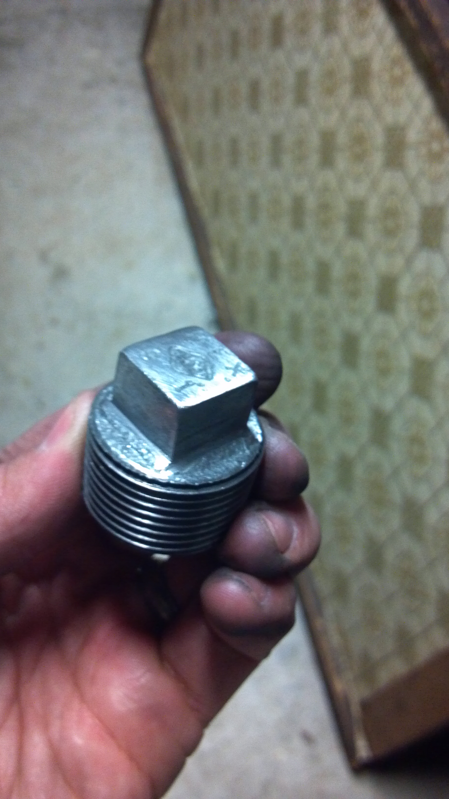

No need to drill the hole.
1. Grind opposite sides of the threads flat with either:
- Bench Grinder
- File (yes you can file by hand)
- Belt Sander (turn the belt sander upside down for ease of use).
2. Then use this tool with an adjustable wrench.
It works every time for me.
And the fit is perfect in that square hole.
Here is what it looks like. Hope this helps:
- Bench Grinder

thank you for sharing the original idea. very much appreciate it
I guess i didnt have to make the hole hehe
