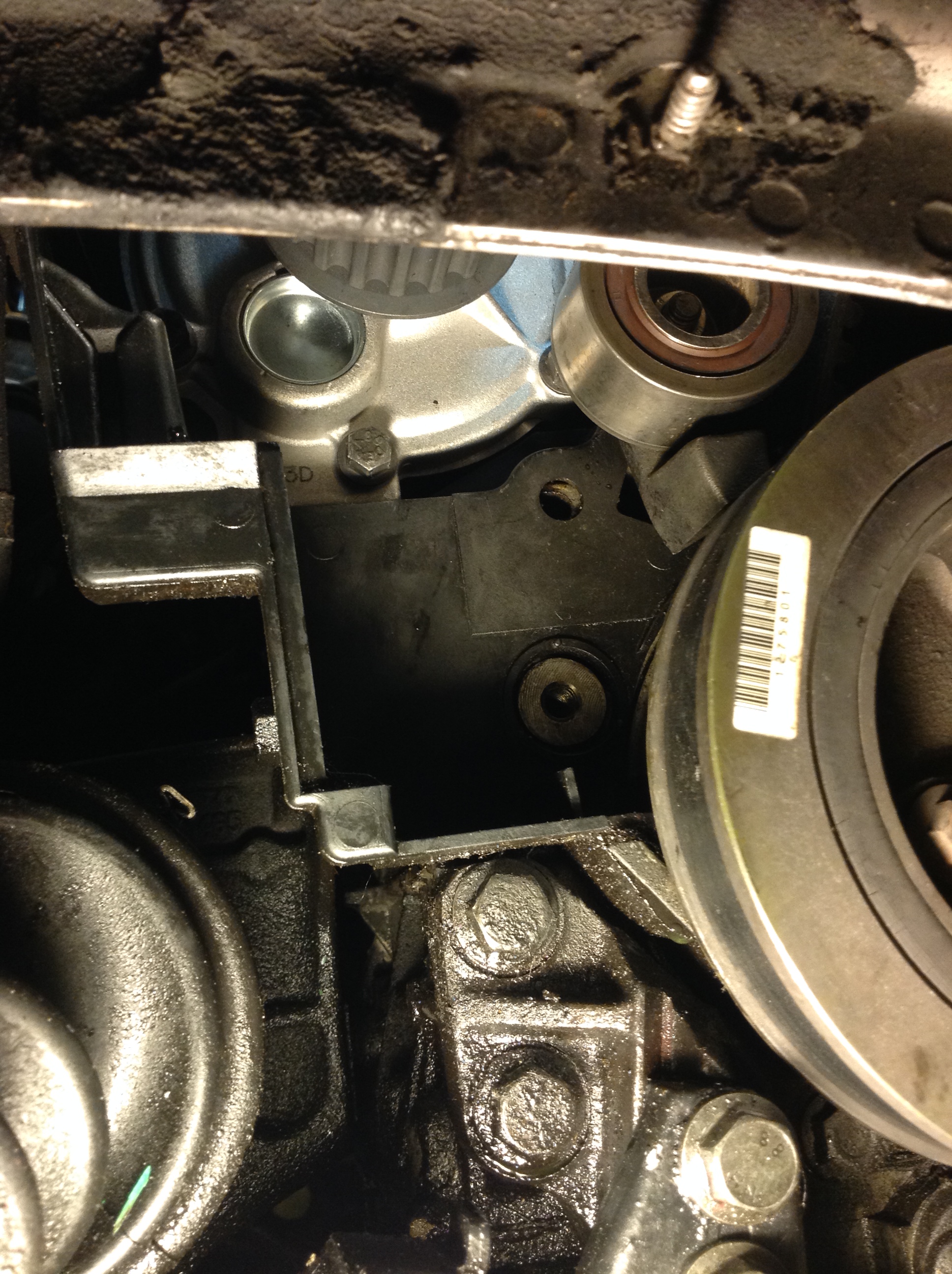

Perhaps this may be obvious to the seasoned DIY'er's or even some regular guys like me but after mulling it over and with the help of a couple of links I decided to tackle the Water Pump replacement by removing only the Hydraulic Tensioner. There were many other excellent links in the various Volvo forums (this one included) that some may find to be more helpful but the following provided me with the larger picture of what I needed to do.
The first picture in this site provided a clear view of the location of the Water Pump though the motor did not use the Hydraulic Tensioner.
http://wakingupthemoose.blogspot.com/20 ... chive.html
This helped expose the entire assembly and showed that only Tensioner removal was necessary to get to the Water Pump
Good full picture of the job. The bungee cord was helpful for Tensioner removal and re-installation

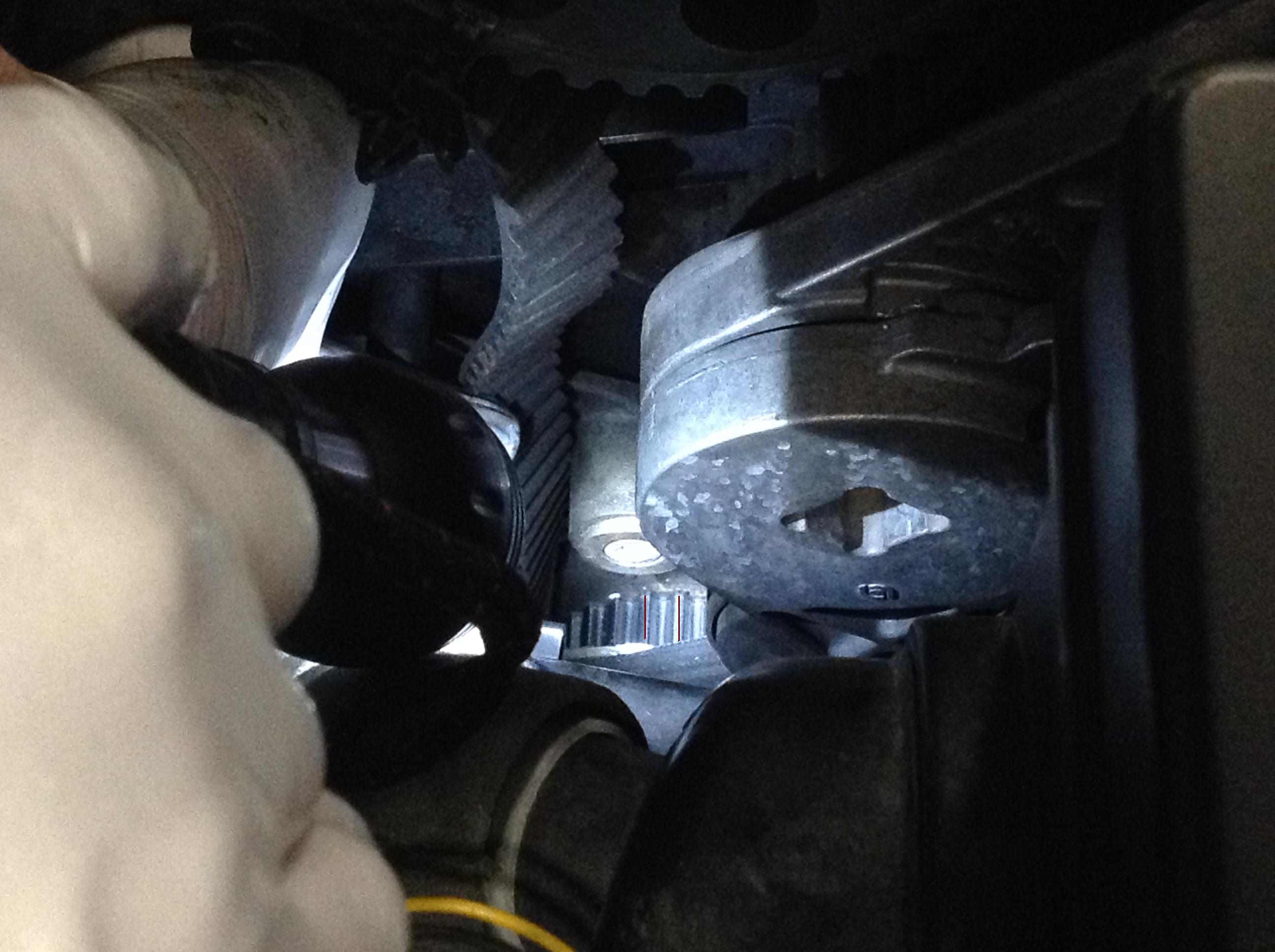

Volvo Timing Belt Replacement, S70, 850, V70 (Part 1 of 2) – Robert Spinners video at 10:47 gave me a clear picture of the timing marks on the Crank. I could not find it at first even after going over the various Forums. Then, with the Crank in my car being aluminum in color, regardless of the lighting or angle I still could barely make out its existance even after knowing where it is suppose to be or look like. There was one other issue and that was the white markings left on the Timing Cover and Crank by the previous Timing Belt job did no match the Notches in either location. I finally decided to trust the info in the various links or what the factory specified and so went ahead and repositioned the Cams and Crank accordingly and reset the belt. Thank God it fire up the first time around!

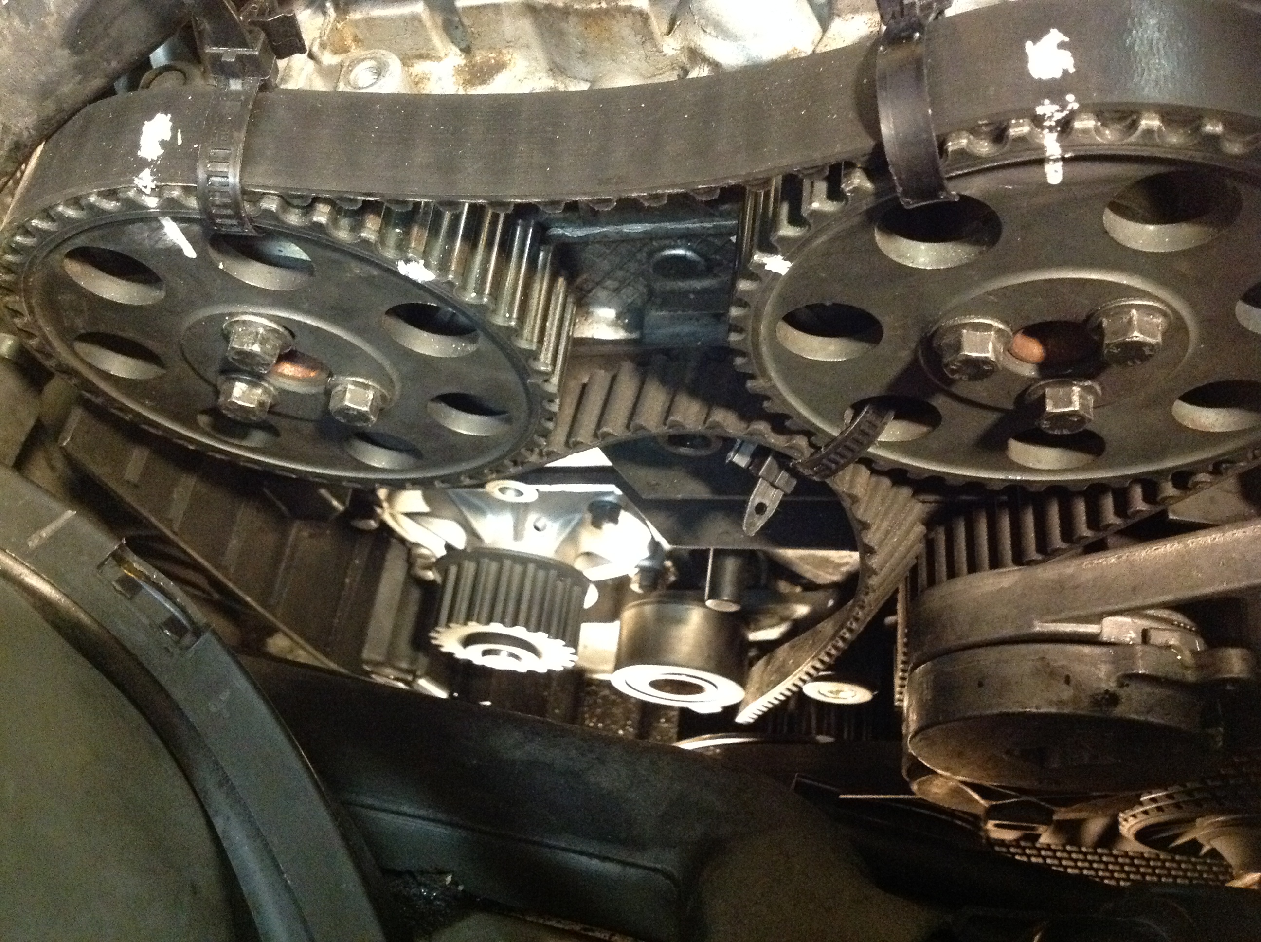

Here are some of the pictures:

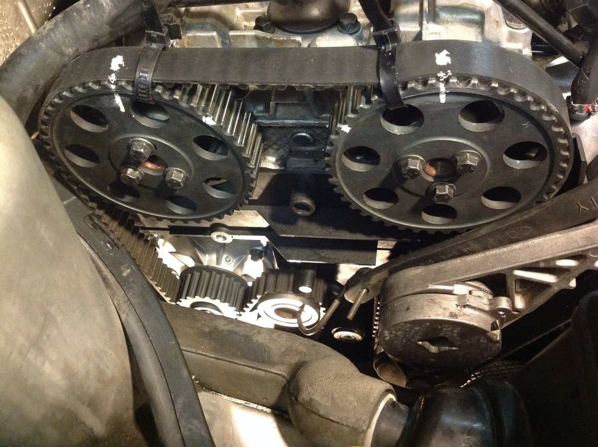

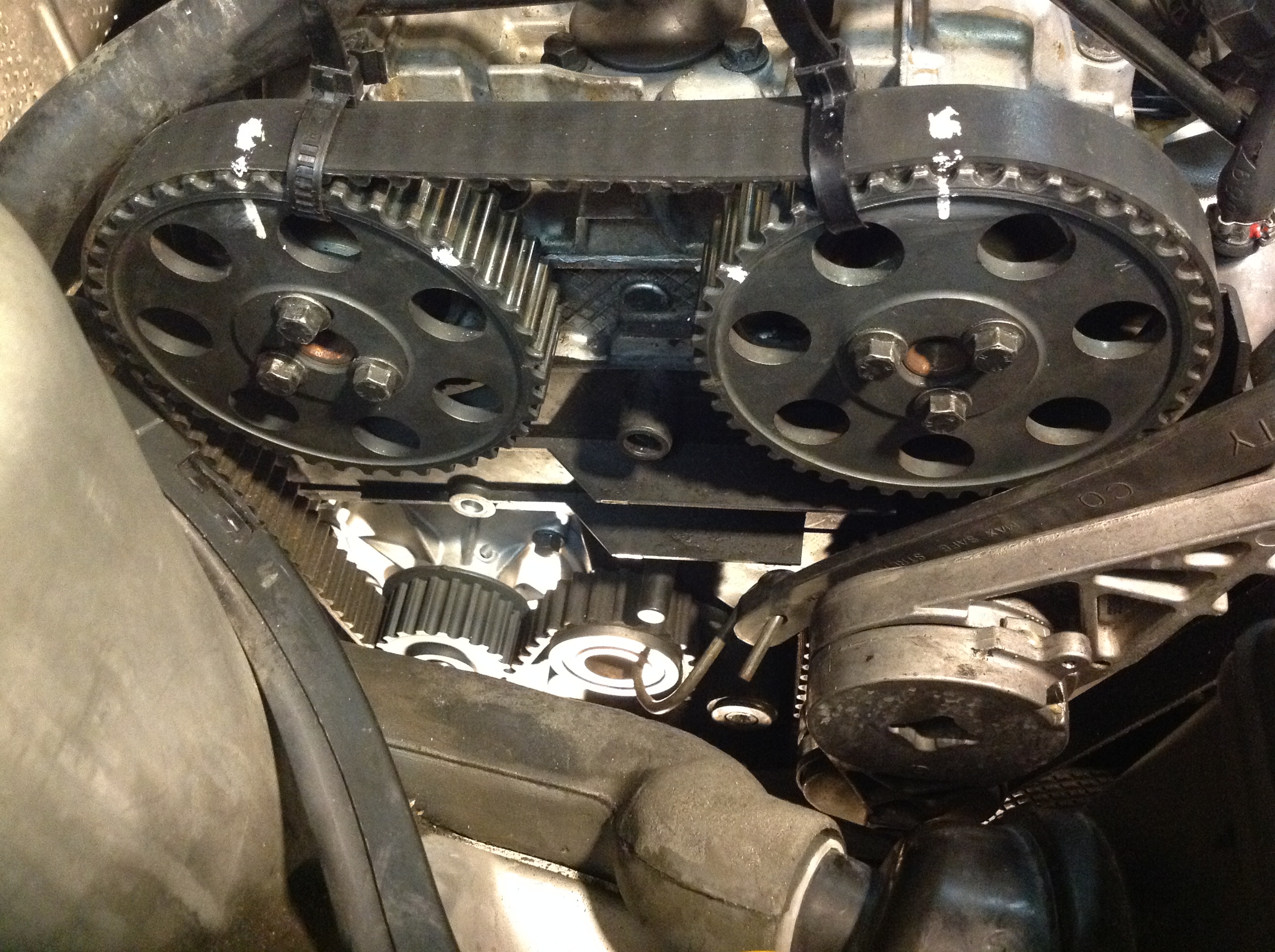

Initially used previous white marks to keep timing than discovered in “rspi’s” video where it should be. Not sure why the car ran or for that matter fairly well. Now seems to be running even better in E Mode whereas the car only had pep in S Mode for the last 1½ year.

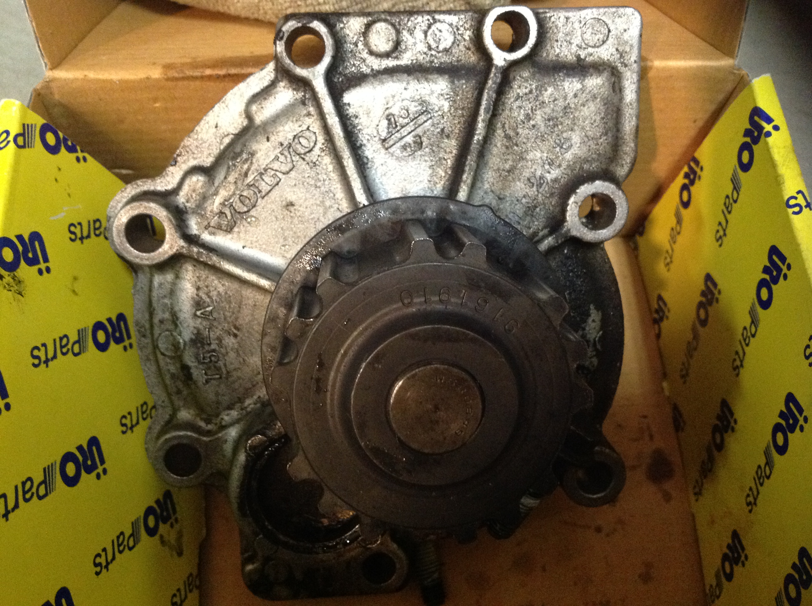

This leaking pump is from the first owner and seemed ok but the gasket were in half a dozen sections. By deducing the Carfax and tow company information the first owner had all work done at the Dealer and the second owner did nothing but trashed the car as indicative by the state it was in when I acquired it.
Old Tensioner Re-used
New pump from bottom – Tensioner still out
New pump from top
New pump from top – Tensioner in or was that going in - The bungee cord hard at work
The hardest parts of this job were:
1) Yes, locating the 2 Crank Timing Gear marks on the back of the tooth
2) The Notch on the Block where the 2 Crank Timing Marks were to fall between
3) Cleaning the surface on the block of old WP gasket
4) Making sure the Water Pump gasket had seated properly as the Pump got held up on the back Timing Cover and you can't visually see if it had seated flush with the Block
So if your Water Pump is leaking, your Timing Belt and the other parts are not ready to be replaced again don't take it all apart just remove the Tensioner.

The photos are really helpful. You forged ahead and got it done.
I have a couple of suggestions based on having done several.
While cleaning up the mating surface on the block (a pain, but necessary), I squeezed a thin bead of Permatex water pump sealant on the PUMP side of the gasket, pressed the gasket onto the sealant and let it set for a while (an hour?). I put a light weight on the gasket to hold it while the sealant started to set up. This step assured me the gasket was sort of glued onto the pump flange so I didn't have to guess whether it was moving as I lined it up and put bolts in.
I torqued the bolts to spec. It was late by then so let it set over night. Re-torqued the bolts the next morning and glad I did. They had a little "give". It has never leaked. And if I should need to replace it, MAYBE the gasket will mostly stick to the pump flange when the pump comes off.
Here's another way to manage the belt during installation.
BEFORE REMOVING OLD BELT: position the crank sprocket on timing mark.
As you pointed out, the crank sprocket timing marks are extremely hard to see. But it's crucial to get them properly positioned at the line on the motor. I think it's on the oil pump case.
If it had been properly timed, your camshaft sprockets would also be on their marks. My first 850 was off one tooth when I bought it.
It's easy for that to happen when a new belt is installed if you don't:
1) begin with the crank pulley timing marks properly aligned. I pulled my balancer and the crank sprocket, put some whiteout on the timing mark so I'll always be able to see it.
2) get the new timing belt tight from the crank pulley to the intake camshaft sprocket. This is the step some people (DIY'ers and techs too) sometimes skip and end up guessing then letting it be a little off rather than remove the tensioner and start over.
How to get the cam sprockets spot on first time: you need a lever that will allow you to turn the intake (and later the exhaust cam sprockets) with some light force. The lever is just a flat bar with a couple of 1/4" bolts that go through the holes in the cam sprockets.
Thread the new belt from crank up over idler and up and over the intake sprocket. It's loose at that point. If you try to get it hand tight then thread the TB over the exhaust sprocket, again getting it hand tight, then over the water pump sprocket, when you release the tensioner the belt will move, and the sprockets will move. If you guessed right how much they will move when you put the belt over the cam sprockets they will land exactly on the timing marks. Voila, you're done!
Trouble is it's easy to guess wrong how much everything will move when you pull the pin.
Eliminate the guess work by getting the new belt "twang tight" from the crank to the intake cam with the intake cam exactly on it's mark.
Lightly wedge something under crank sprocket to keep the new belt seated in the sprocket teeth (or have a helper hold it in place).
Adjust the intake sprocket CW a bit and slip the belt on. Now use a lever tool to torque the sprocket CCW 'til tight. The TB has no stretch so when it's tight it just stops. It doesn't take a lot of force to get it that tight, but most people can't do it by hand.
Now, holding it there with your lever, is the intake sprocket mark exactly on the notch? It will be close or a tooth off. If it's a tooth off, back off the tension, move the sprocket one tooth on the belt and re-tighten it with your lever. Right on? Great. Now at about 1:00 o'clock on the intake sprocket (not 11:00 as in your picture) use a zip tie (or tiny vice grip with light pressure) to keep the belt teeth seated at that position on the sprocket.
Next, slip the belt onto the exhaust sprocket, pull it tight with your lever. Marks exactly aligned? Great. If not, slip belt back off sprocket, move sprocket one tooth, then belt back on and tighten. Move your tiny vice grip to the exhaust sprocket (about 11:00 o'clock) to keep it seated on the sprocket.
Lastly, for belt installation, thread it over your water pump sprocket.
REMOVE the wedge that's under the crank sprocket. You can do this after you pull the pin just don't forget it's there.
Pull the pin.
If you think about these steps for the timing belt part of the job, they're really quite easy and you'll always get the belt on right first time with minimal frustration. And probably in about 15 minutes with the tensioner preset.
EXCEPT if somebody had the sprockets off the cams and switched them when they put them back on.
Then you need a way to align the camshafts—either from their back ends or see my post: how to replace timing belt without a locking tool.

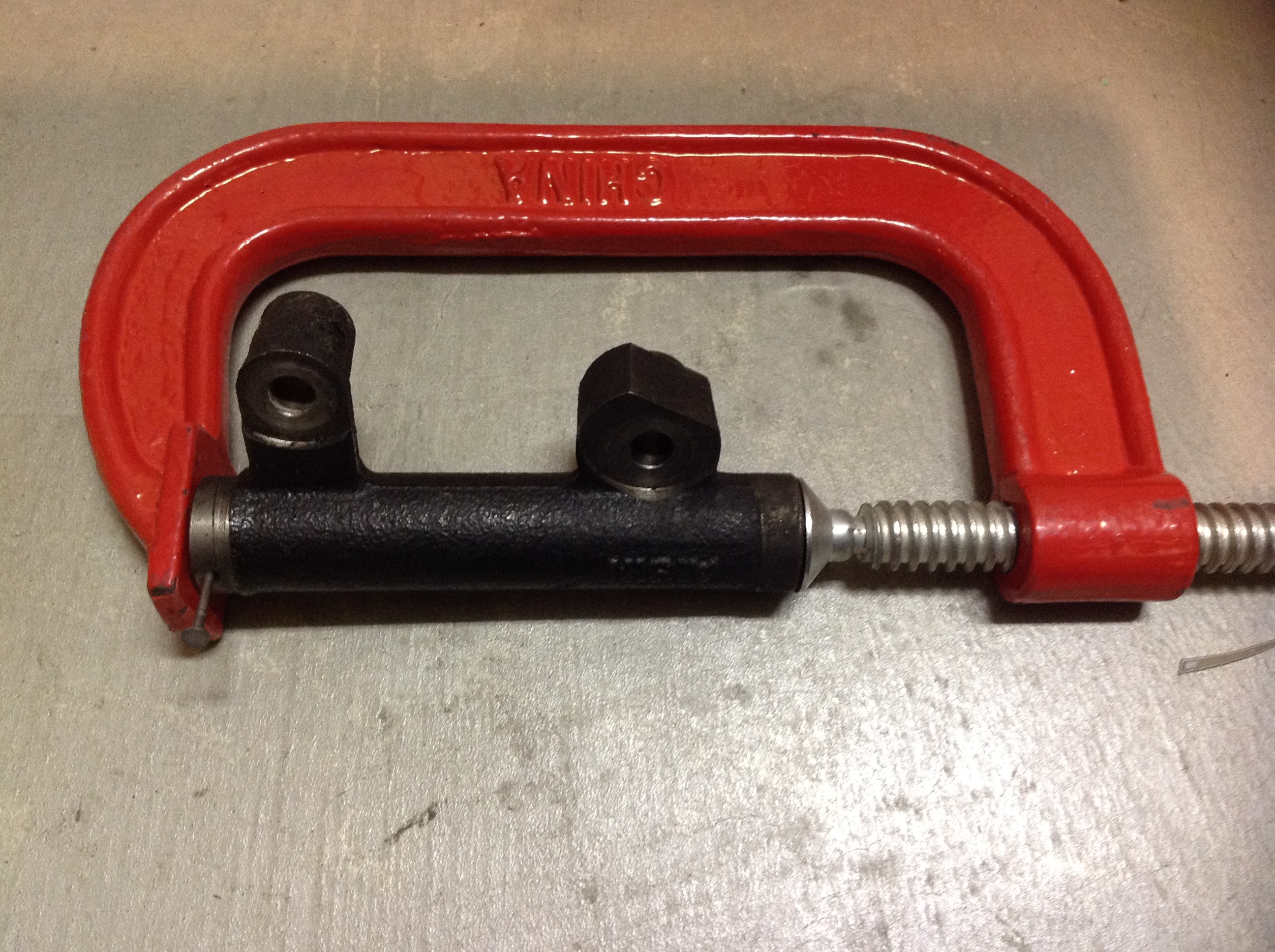

1. The WP issue:
- Yes, clean the mating surface well and smooth
- No, you don't need to use any RTV sealant, which can back-fire on you. If you use Aisin WP (which comes with green gasket) or Volvo gasket ---> no need for any RTV. The car came from factory with Aisin gasket installed dry.
2. The zip tie:
Note the direction of the hydraulic tensioner (RED arrow), if you pull a ziptie in the same direction (BLUE line) PRIOR to tensioner removal, then you will be fine.
2. The zip tie:

Or just pull both rollers anyway, and remove the serp belt tensioner too. That opens up a lot more room to work in there, including for cleaning the water pump surface. And you get to line up all the timing marks fresh when you put it back together.

Nice job. After doing several belts, you really don't mind pulling the belt off. I didn't pull the belt when I did a head gasket job. LOL
I seen one post or video where a guy changed the cam seals without pulling the belt. He clamped the belt on one cam sprocket while doing the other. He did one at a time in maybe 40 minutes.
I really liked your use of the zip ties.

They were leftovers either from the Factory Alarm or AC installs from my short lived 6 month career in 96 at an the Acura Dealership. They are very strong and reusable! Use to have a drawer full now just a dozen or so left.rspi wrote:
Thanks for the tips JimBee. I thought about the RTV but hate cleaning those in case I did not replace the WP correctly the first time.
Your drawing skills are excellent as are your write ups cn90. Very systematic, well laid out and organize. I did use the Rubber Bungee through out the process to keep tension on the entire belt assembly and to help keep the pulley out of the way of the WP. The zip tie would have been good as the Bungee did slip off quite frequently and you really don't need to move that pulley through out the entire process if I recall.

I hate to write this but there have been some bad reviews of URO parts reported here. Did you vet this water pump brand before install? I though Asin was the choice of experience for the water pump.

Not sure how much life is left in this car? Can't sell it for much but don't want to just let it fall apart either so just trying to nurse it along.
As for my first 2 URO experience: FCP is sending a replacement (URO 24 month guarantee) for an Engine Mount (1.5 year). The interior is rattling at idle again - definitely annoying. Hope they will approve/follow through with the warranty after I send it back (shipping on me). The URO Expansion Tank (1.5 year) has fine hairline cracks. URO? Hope the WP fairs better as many other brands I saw online use the same (Stock?) photo so I was willing to give it a try.
URO Parts 30751700 Water Pump $39.63abscate wrote:I hate to write this but there have been some bad reviews of URO parts reported here. Did you vet this water pump brand before install? I though Asin was the choice of experience for the water pump.
