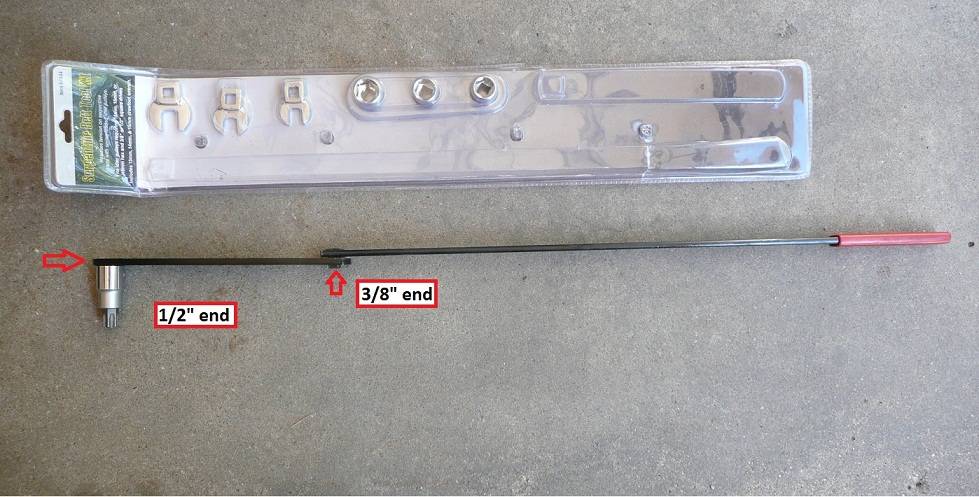

- Serpentine Belt Tool is a must. It is inexpensive at Harbor Freight or ebay.
- The thin-profile levers (3/8” and 1/4") made the job much easier bc you don’t have to remove other parts to get to the rear cam seals etc. The Powerbuilt tool is a great helper.
- Metric wrenches, Torx set (for cam sensors) and Hex metric set (Hex for the TB tensioner).
- For the VVT Torx #55, I bought the 1/2" type. Forums told me 3/8” type T55 is also fine.
Since this is going to 88 ft*lb, I use 1/2” type. After I did the job, I also bought the 3/8” T55 socket, I should have bought this too. The difference of 6mm between the 3/8” and 1/2" socket makes a huge difference. The 3/8” T55 is good for the cap, and the 1/2" T55 is good for the big center bolt. Or you can buy just the 3/8” T55 for the entire job.
- FYI…A 1/4" drive can take about 30 ft-lb, 3/8" about 100 ft-lbs, 1/2" about 230 ft-lb in normal operation. The 3/8” drive breaks about 150 ft-lbs, 1/2" about 300 ft-lb.

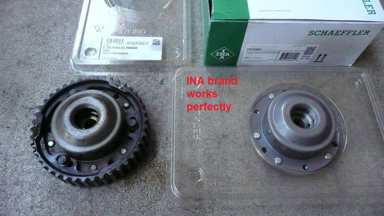

- Good source is FCPEuro etc. I bought most of my parts from FCP. The Exhaust VVT Hub was on sale Ft Washington, PA Volvo dealer for $215 with free shipping.

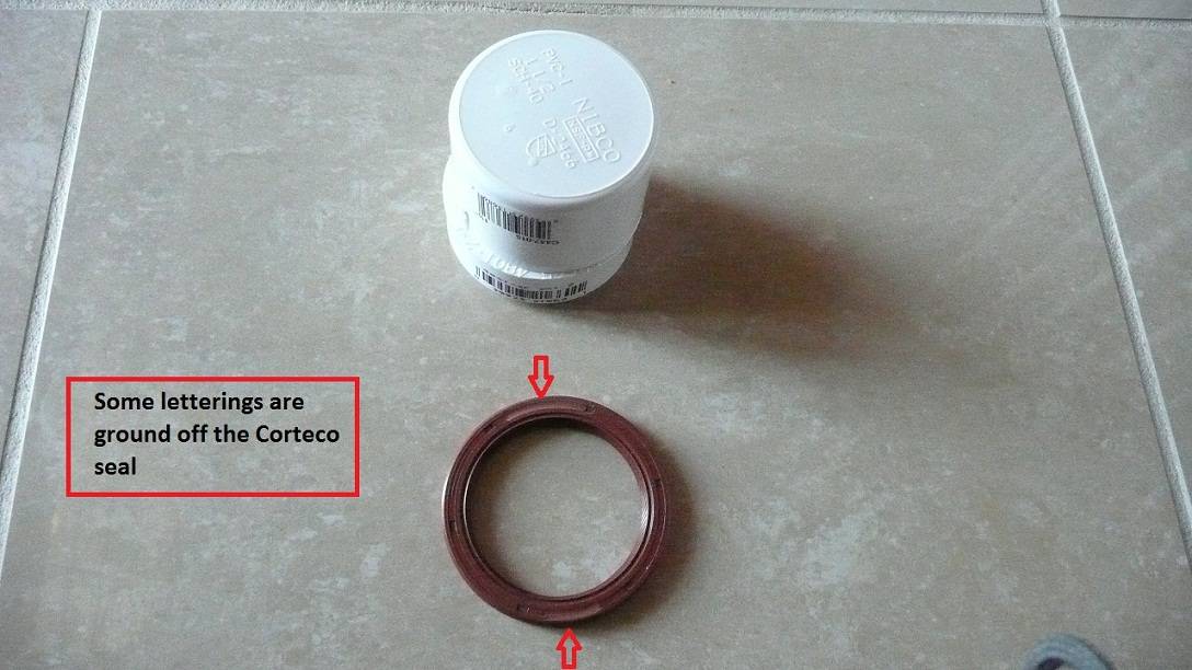

- Cam seals: the FRONT cam seal is definitely Corteco. When placed side by side, the Volvo factory seal is identical to the Corteco (Corteco ground off some numbering system on the seal surface to avoid issues with Volvo). The REAR cam seal: I do not know who made it for Volvo, but my experience using Corteco for the rear cam seals has been excellent.
- TB Kit: I have been using Continental for yrs. Conti is the orig mfg for Volvo TB. Inside the Conti TB kit is INA pulleys.
- Serpentine belt: I use INA pulley and Conti belt. The 2007 S60 uses a shorter belt than let’s say 2004 model (smaller PS Pump pulley diameter in the 2007 S60).
- At 115K, the Intake VVT is still good with minimal play. The Exhaust VVT was still OK with about 1.7 mm radial play (no oil leak at 115K yet) but since this is such a big job with tons of potential issues, I elected to install a new VVT Hub bc I don’t want to do this job again.

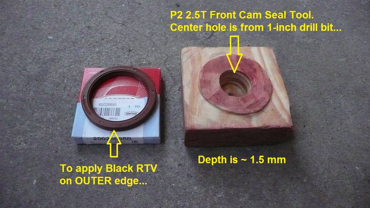

3. Use Permatex Black RTV around the OUTER edge of the seal, so it has less chance of coming loose.
Wet the inner lip of the seal with oil when inserting the new VVT Hub. Permatex Black RTV package says it takes 24h to cure. So best is to do this job on let’s say Saturday but don’t start the engine until Sunday.

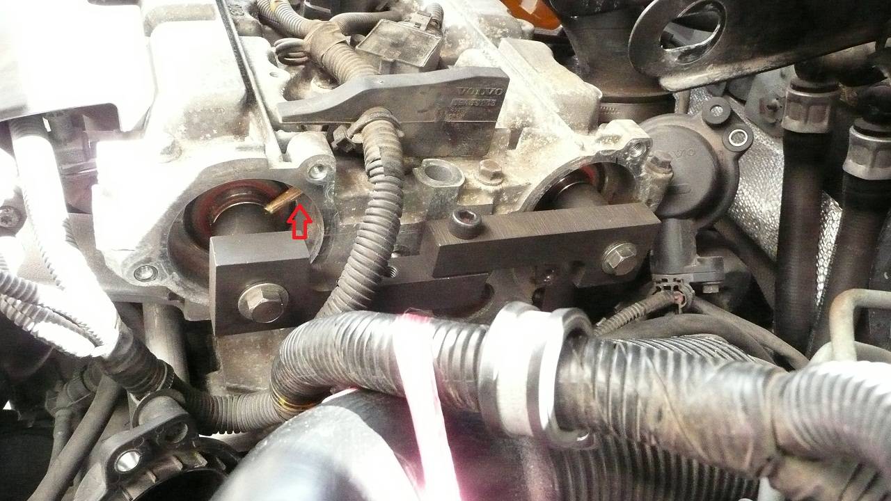

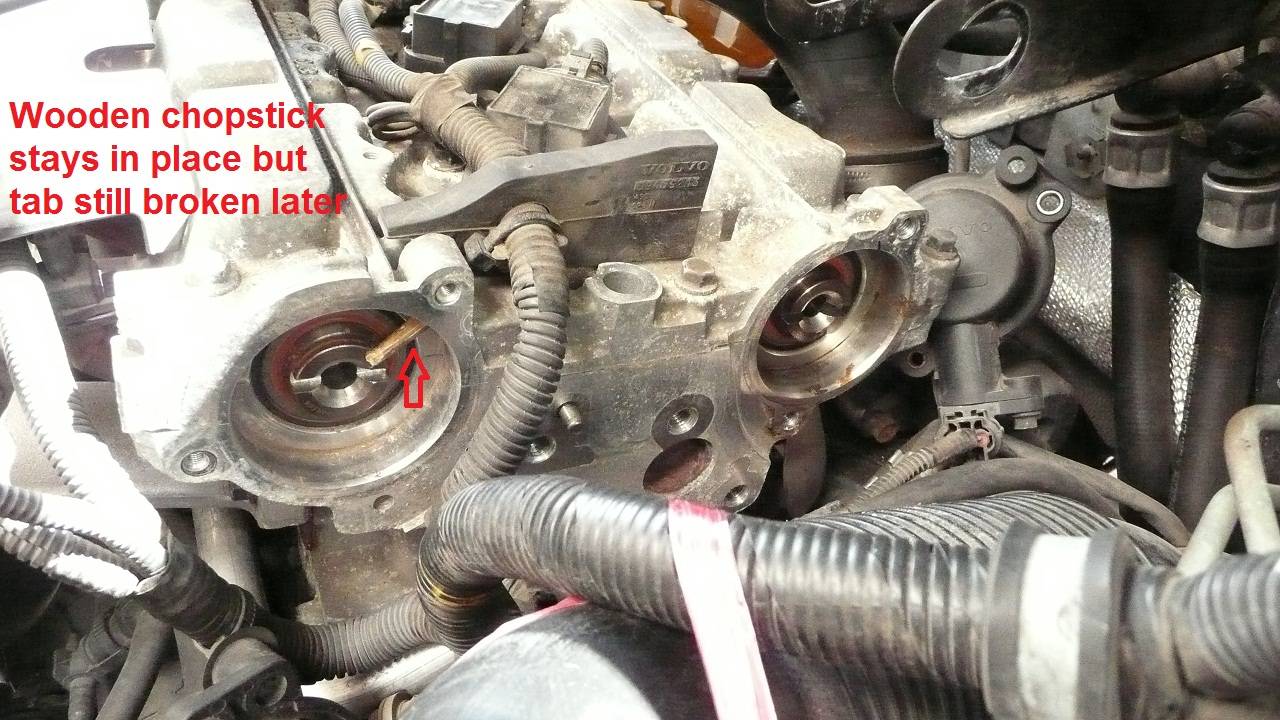

NOTE: the force of removal will break the tiny little tab on the end of the Intake camshaft. No consequence here at all bc the Reluctor will reinstall just fine (install this bolt ONLY after TB is re-installed). However, you might want to insert a tiny woodruff key in that space to avoid the damage to the little tab. I use Red Loctire during installation.
- CTA tool came with no washers, I used some washers on the bolts. TRICK: when rotating crank to get to timing mark, stop the crank about 1 inch before the timing mark, then moved it very very slowly 1-2 mm at a time while checking the rear to see if the Locking Tool fits, just snug them loose and slowly tighten them.
Only when you are happy with the setup, then tighten the bolts, I just snug them then tighten a bit, no need for excessive force, I am guessing 12-14 ft*lb.

13. Here is the factory setup, note the cam seal sits at the very edge of the chamfered edge. I used the PVC Coupler + Sharpie mark, it makes installation check very easy, you are talking 0.5 mm here and there! When you install the VVT Hub, oil the outer shaft first, you will hear a distinct “pop” when the VVT Hub is fully inserted: this is the sound of the sealing edge popping back onto the VVT Hub shaft.
14. If you ever push the seal too far in, such as 1 mm too deep, no worry, use a pair of right-angle pliers to gently pull it back out. Note I use a small piece of cardboard as cushion on the camshaft sides.
15. The REAR cam seal: as mentioned many times in forum, I used a small punch, then inserted a screw dead center to remove it. Do NOT damage the shaft side! I happened to have a plumbing adaptor as shown, this device was perfect for installation in the tight space!

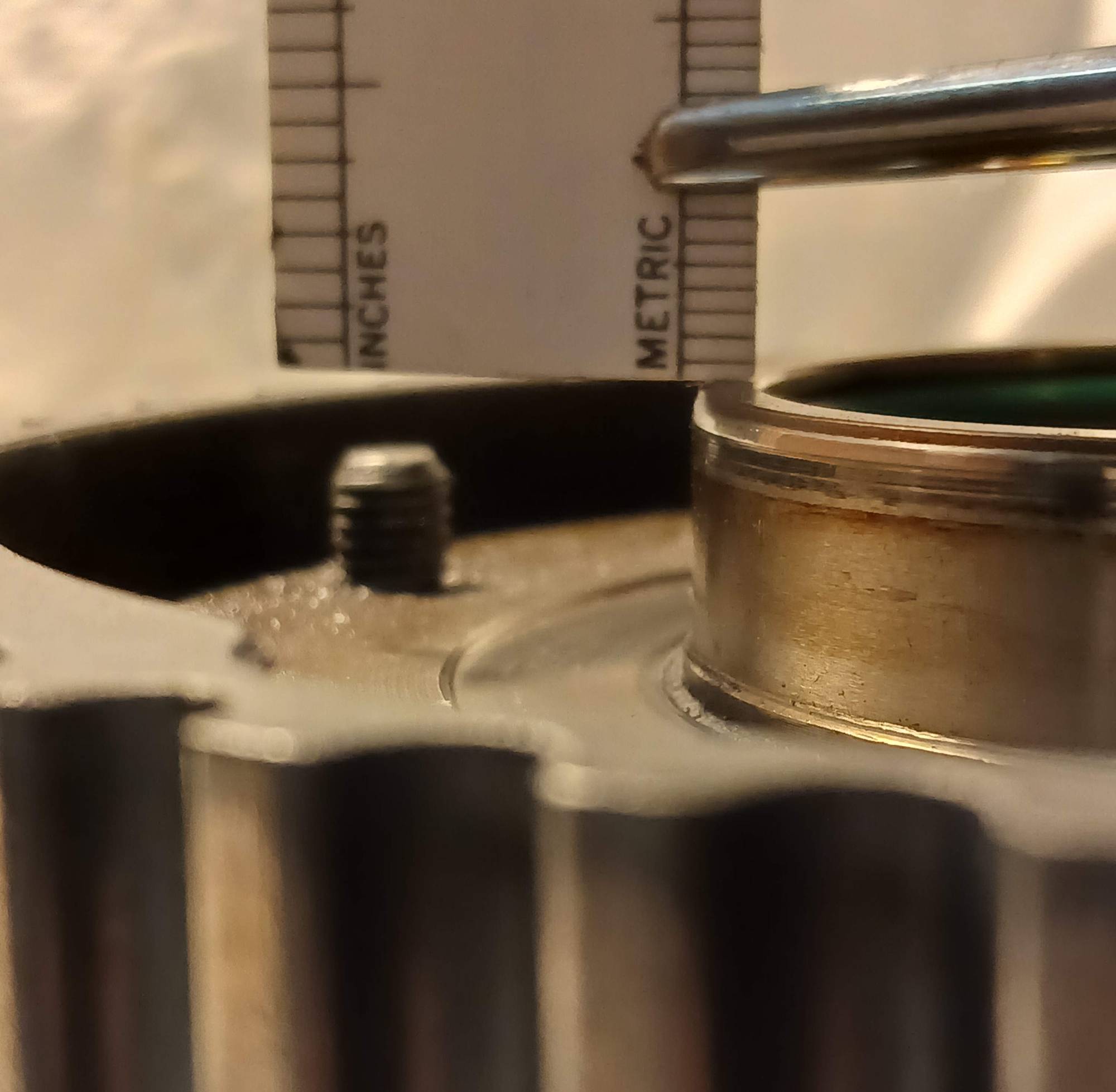

16. For Front Cam Seals, the Engine Bore depth is 7 mm, Seal size is 51 x 65 x 7mm. You can see the old seal is getting tired with sealing edge being dull. The new sealing edge is sharp…
17. Brand-new Exhaust VVT Hub moves in and out axially 1 mm between CCW (cam advanced) and CW (cam retarded). Note the Range of Movements of Exhaust vs Intake VVT Hubs in terms of degrees.
My guess re wear and tear is that: the Exhaust VVT is activated more frequently, thus the wear at 115K.
The Intake VVT probably does very little work during engine operation, thus almost no wear at 115K miles. I do not have the engineering spec’s of angular rotations of Intake vs Exhaust VVT Hubs, but the photos showed what I found…

Anyone have experience with how to avoid breaking the tab on the rear of the camshaft; would it help to crack that bolt loose before removing the timing belt?
I'm hesitant to replace cam seals and VVT hubs preventively because on my P2 cars they are still bone dry at mileages of 190k (07 XC70) and 172k (06 S60). At the 200k timing belt changes I'll have to decide if fit's worth the extra labor savings or if I want to continue waiting for signs of trouble. Checking the axial play on the hub as described here will factor in to the decision, good info.

Regarding my comments above, this summer I needed to do a timing belt on our green 07 XC70 with 200k. Here are some notes from that experience to supplement:
1. Replace the bolts in the cam locking tool before you use the tool. The bolts that shipped with mine were junk metal.
2. The locking tab(s) did not break off the cam, just go about the job carefully you should be fine.
3. I didn't use any loctite
4. None of the cam seals were leaking and I didn't have a lot of time so I didn't touch them; I left all four cam seals in, front and rear. They are the original factory seals. If I get a leak I'll go back in for it later.
5. The exhaust VVT hub was wobbling so I replaced it. Intake cam hub was fine so I left it.

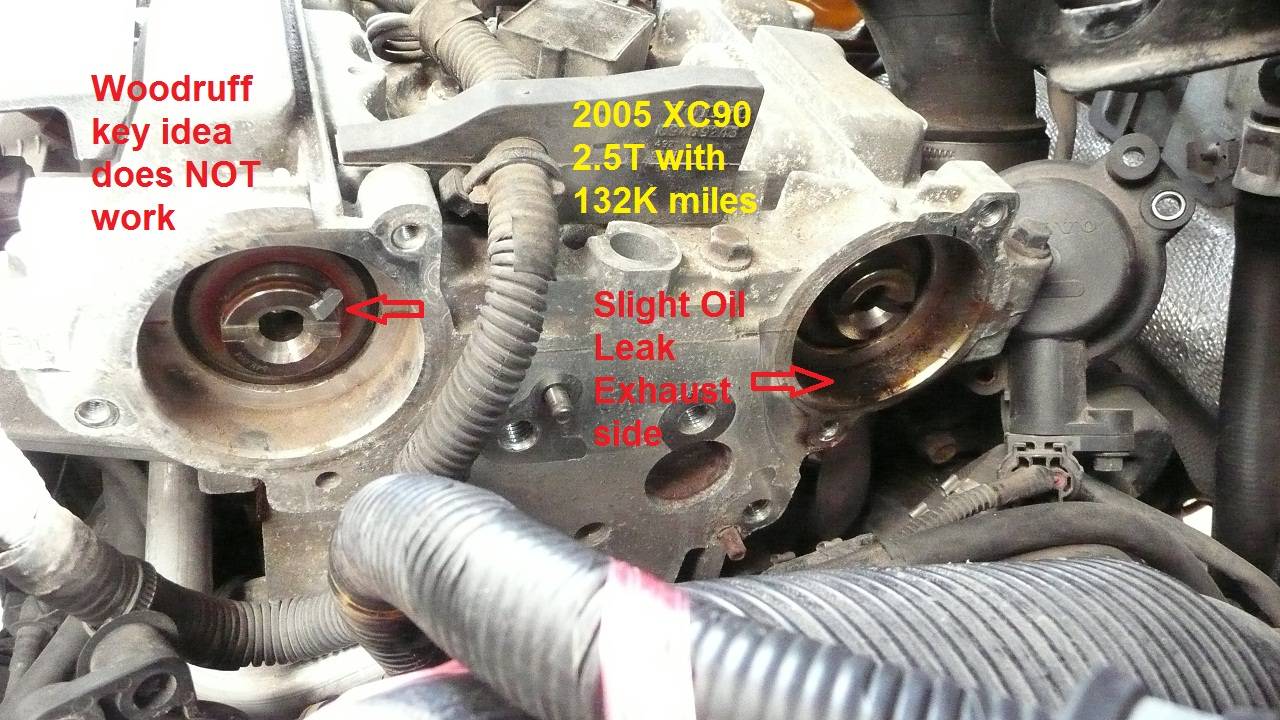

That little cutout on the cams labeled “ woodruff key” is left over from the -1998 models and is used to index the distributor rotor, no longer used on our 1999- cars
Is there any reason the hub shaft could not have been made a tiny bit longer? The seal rides so close to the end that there is hardly any room for axial play at all! This must have been designed by the same people that put the critical part of the PCV system under the intake manifold. The exhaust hub seal was a fairly tight fit on my block, I set it not quite inside the chamfered edge hoping that the silicone will help secure it. It took a 4' section of steel channel on the Torx bit to break it loose, bending two wrenches in the process. But it gives me a new appreciation of Torx bits: as I leaned on the lever, I could just imagine stripping out the bold leaving me with a total disaster, but once it was out, I could see no damage to the bolt at all! (Just noticed that the Craftsman wrench was one that I had ground down a bit to access fan bolts on a 240!) At any rate, many many thanks for all of this information, I am in awe of the expertise here!

@mbliss et al,
The factory cam seal is 51 x 65 x 7mm (please verify).
As mileage adds up, the Exhaust VVT develops play and it can slide in and out (when advancing or retarding the cam shaft) of the seal, causing oil leak.
Instead of changing the Exhaust VVT Hub, which currently costs some $380-$400, I just came up with this idea that I have not tried yet: using a deeper seal to bring the seal lip (where the garter spring is located) out another 2 mm to the region that is 2 mm from the deep grove shown above, by using maybe 51 x 65 x 9mm or 51 x 65 x 10mm?
If anyone ever tries a deeper seal (and thus reusing the VVT Hub), please post your experience. If this idea works, ppl save a lot of money.

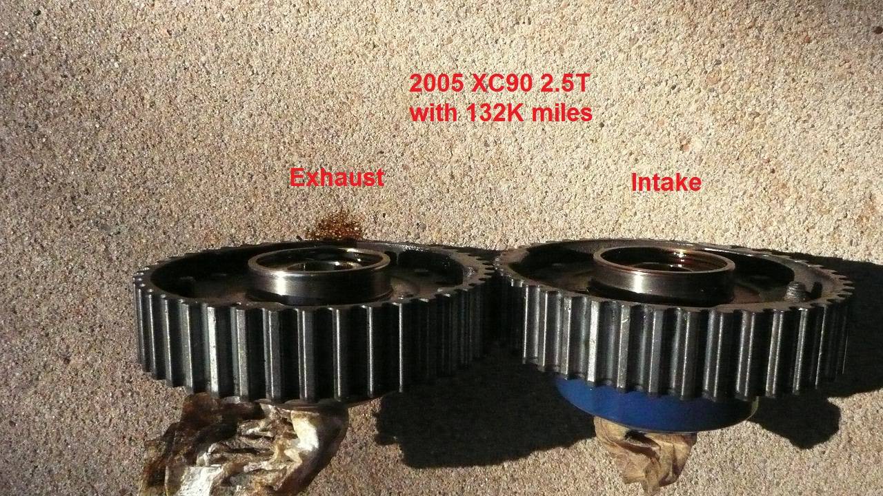

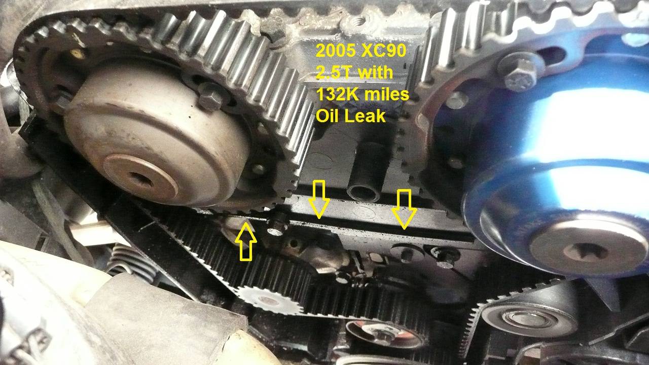

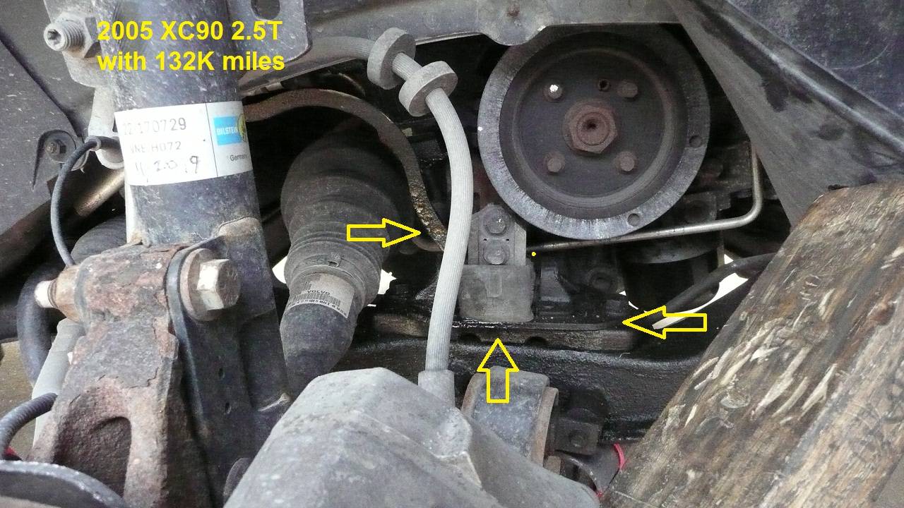

This is an update on the 2005 XC90 2.5T with 132K miles.
This oil leak: I have been watching it for 4-5 years.
Finally had a nice weekend to replace the Exhaust VVT Hub.
The procedure is virtually identical as the S60.
1. The usual places of oil leak:
2. The idea of Woodruff key or wooden chopstick is fine but the small little tab on the cam still broke later.
So, no need to protect this little tab. It is inconsequential.
3. Exhaust vs Intake VVT at 132K miles.
- Exhaust VVT play: 3.0 mm ---> replaced with new INA unit.
- Intake VVT play: 0.7 mm ---> re-used without issue.
4. The Front cam seal: after making the installation tool using wood, installation is 5 seconds.
The Corteco seal simply pushes in, no hammer needed!
This is why I used black RTV just to be sure and let it sit for 24h.

Also to answer @mbliss question...
If you look at the seal (51x65x7 mm deep), the sealing lip (with garter spring) rides about 2 mm from the edge
of the VVT Hub. Also, the flat part of the inner lip of the seal is ~ 2 mm from the housing. So, during operation,
the VVT Hub edge is about 2 mm from the housing, and thus cannot be made longer for obvious reason.
This is a standard photo from the internet that I sketched (not to scale) to show the issue. So, the very inner edge
of the VVT Outer Hub sits flushed with the seal's inner lip, thus the sealing lip (with garter spring) normally rides
about 2 mm from the very edge of the VVT Outer Hub.
Anyway, I have come to the conclusion that in order to save money on the new Exhaust VVT Hub, if you decide
to re-use the Exhaust VVT Hub with some play, options are:
1. Use a deeper seal as mentioned, maybe 51 x 65 x 9mm or 51 x 65 x 10mm?
Question: where to find these?
2. Install the Corteco seal backwards with the garter spring facing outside (this is my new untested idea). Just apply
some grease on the garter spring to keep it in place and to keep it moist, but this area is protected by the TB cover
anyway. The idea is: by installing it backwards, you bring the actual sealing lip (with garter spring) about 4 mm
further out. Now the "dust lip" faces engine oil instead of outside air, this is no big deal. What is important is actual
location of the sealing lip w.r.t. the VVT Hub rotating shaft.
Anyway, if anyone ever tries either option #1 or #2, please post your experience...
