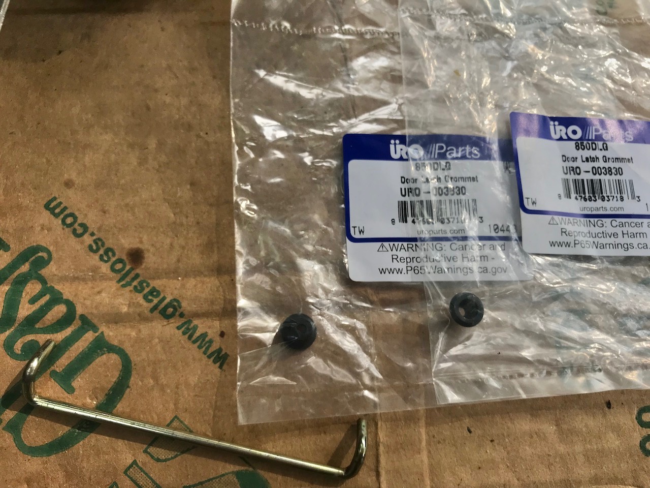

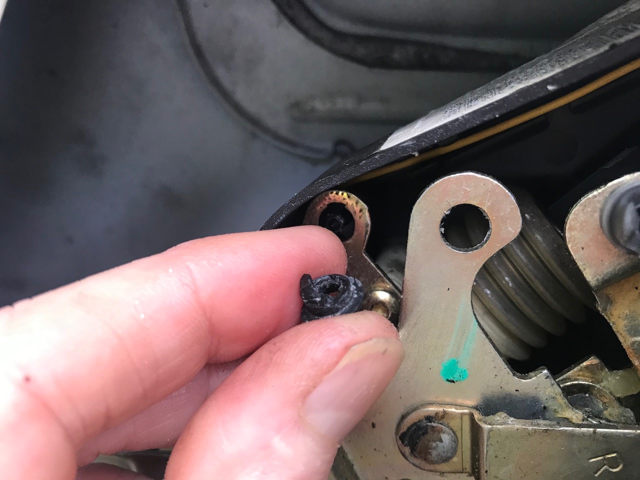

Reviving an old thread here to add some photos for replacing the door latch grommets in the 850. When these crumble and break, the push rod that connects the interior door latch to the lock mechanism falls out and you will be unable to open the door from the inside. The fix is to remove the lock mechanism and install new grommets.
Old crumbly grommet, removed
New grommets and original rod (rescued from inside lock mechanism)

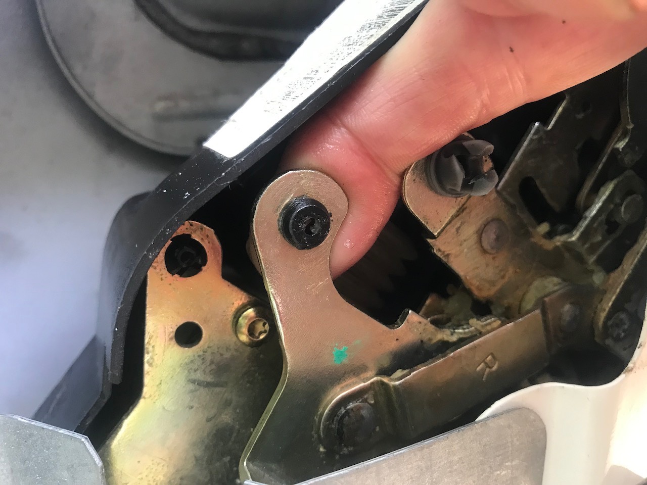

Pushing new grommet into position in hole on metal arm

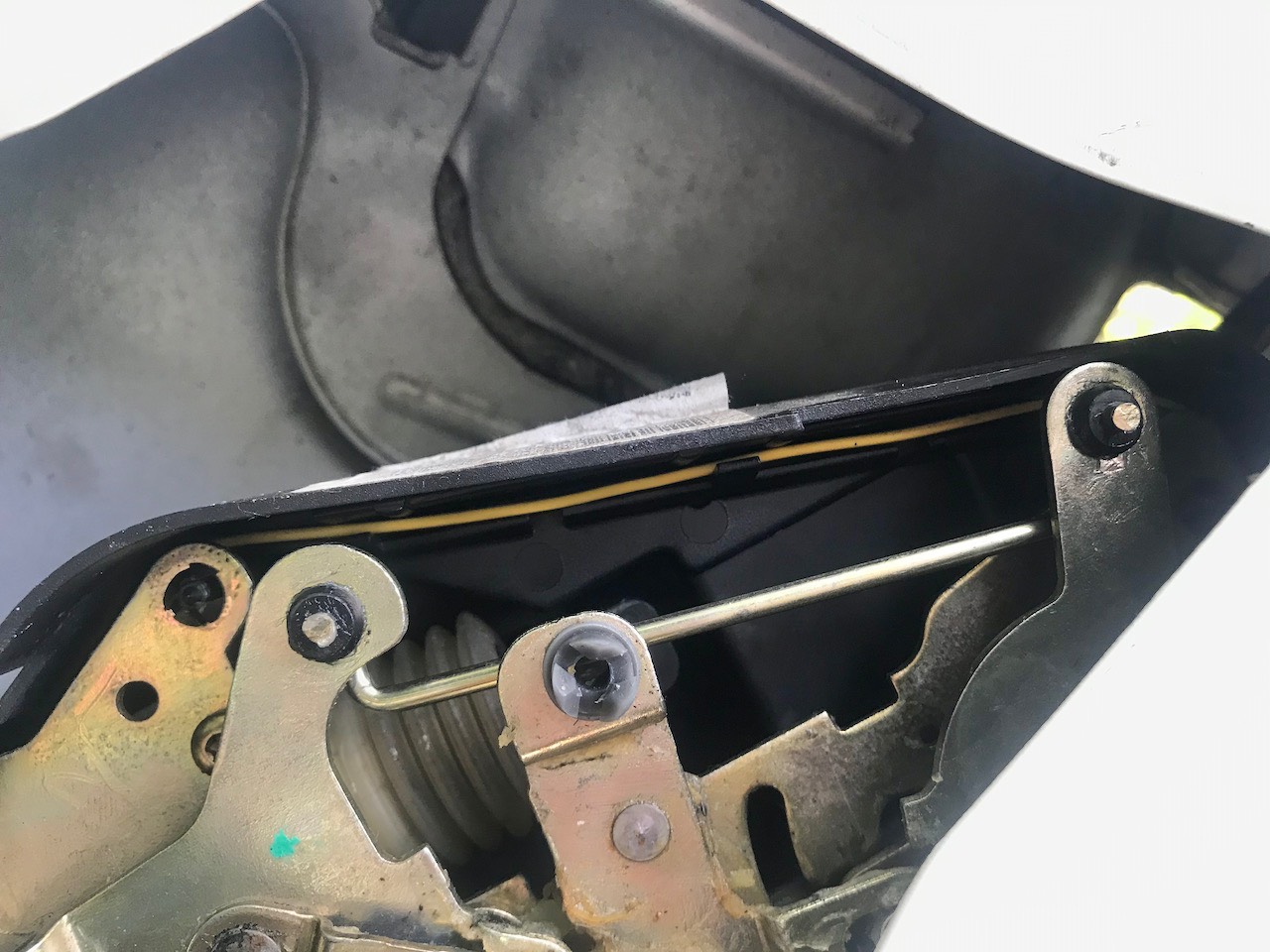

Sliding rod into new grommets

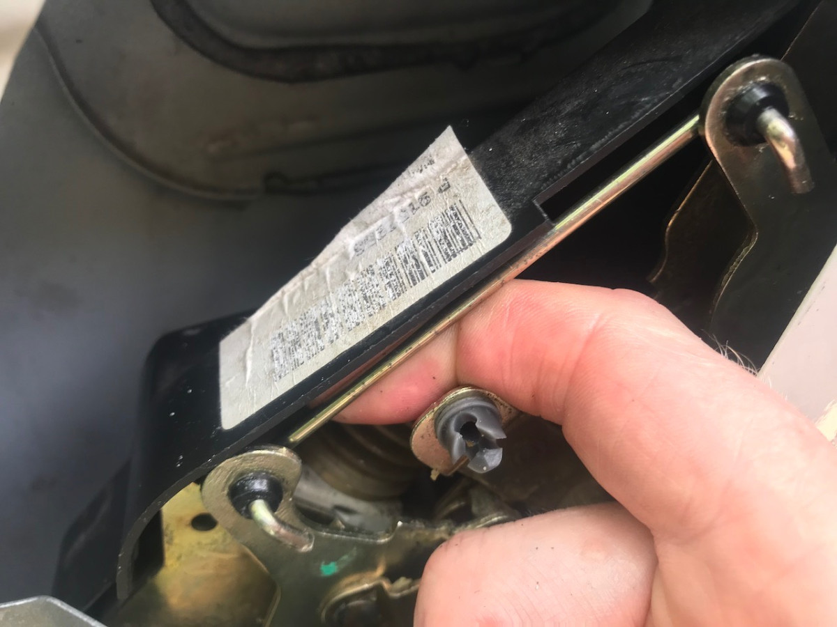

Pivot rod up
Pivot rod up
