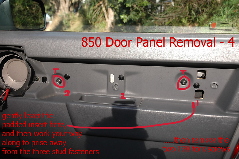

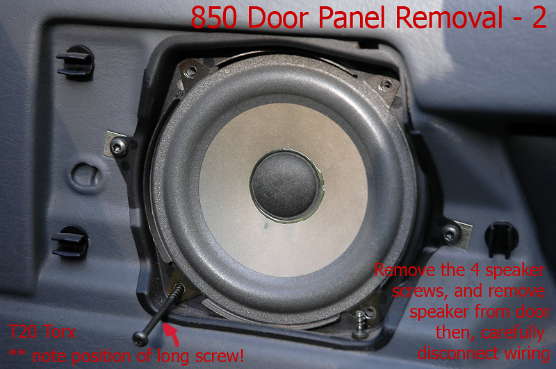

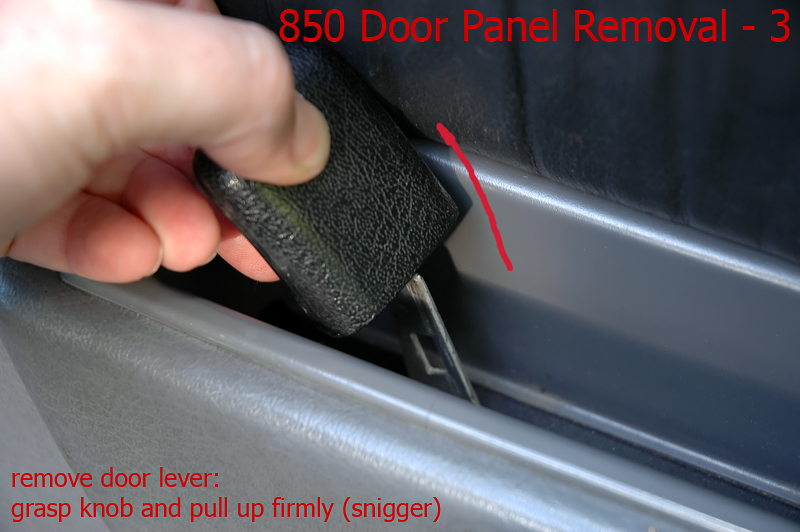

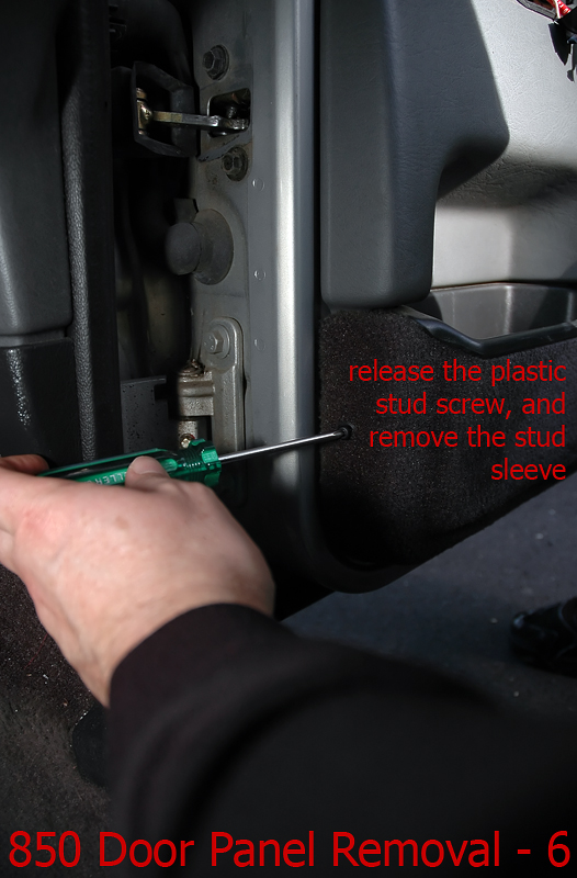

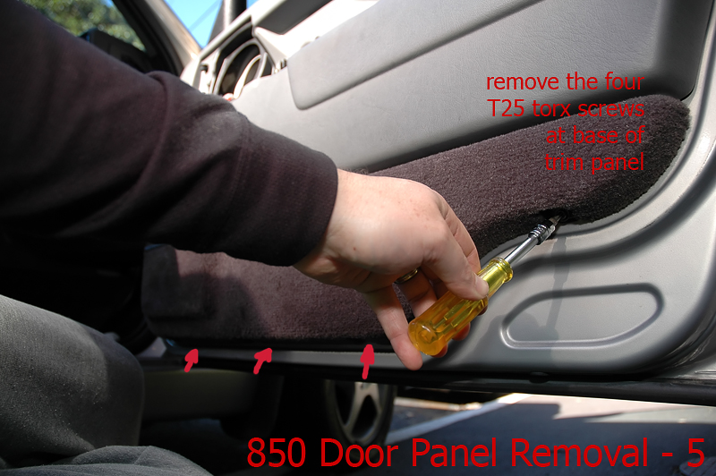

I needed to replace a volvo 850 door check-strap recently, and couldn’t find an on-line guide to removing the interior 850 door panel, to provide access. This precipitated consulting that old-fashioned repository of knowledge, ‘the book’. I had to find it first! Anyway, I built some ‘how-to pictures’ for those of you who lack ‘the book’, and are wondering how to get that door panel off to provide access to window winders, speakers, wiring, check straps etc.
Tools required:
* small flat-blade screwdriver
* Torx drivers or sockets: T20, T25, T30
* #1 phillips screwdriver
* long-nose pliers
MVS Forum Member Wagonizer replied:
Thanks for the info. I wish I had it last weekend when I lubed my sticky 850 door mechanism on my ’94 850 wagon. I just wanted to add a couple other tips:
-For the rear doors the long screw that mounts the speaker and holds on the 850 door panel is the top left one.
-With the rears doors there was no need to remove the padded inserts as the top od the door panel is seated on brackets and lifts up and off once you’ve removed the fastening screws (at the bottom and on the speaker)
