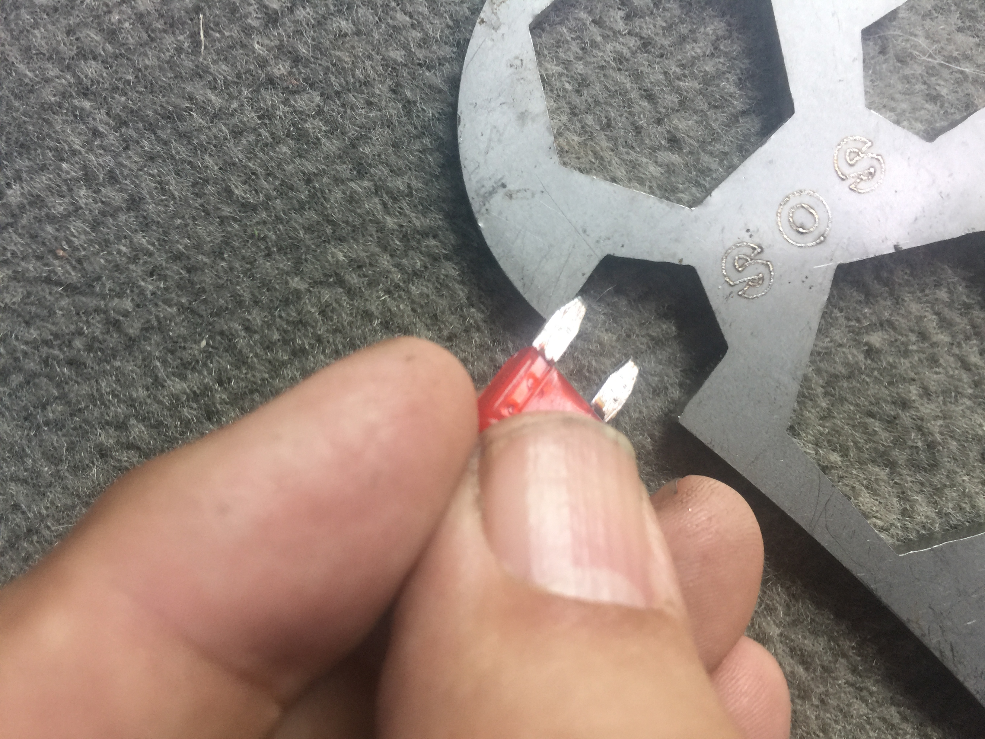

Nailed it. Same problem
- Nasty fuse

Great find. I often see that discoloration on Volvo fuses. It's odd that a low wattage circuit should have corroded contacts. Perhaps tin the fuses with solder?

No warning from the DIM on this one, but of course of it is a current comparator circuit, the two circuits were equally balanced at 0!
