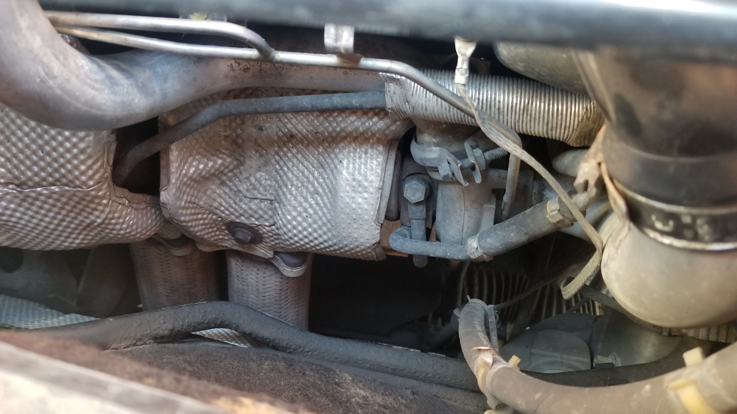

Have you checked for any vacuum leaks back there? Sometimes that can cause a whistling noise.Wasamee wrote: 28 Apr 2019, 00:42 It seems to be coming from the back of the engine near the passenger side.
