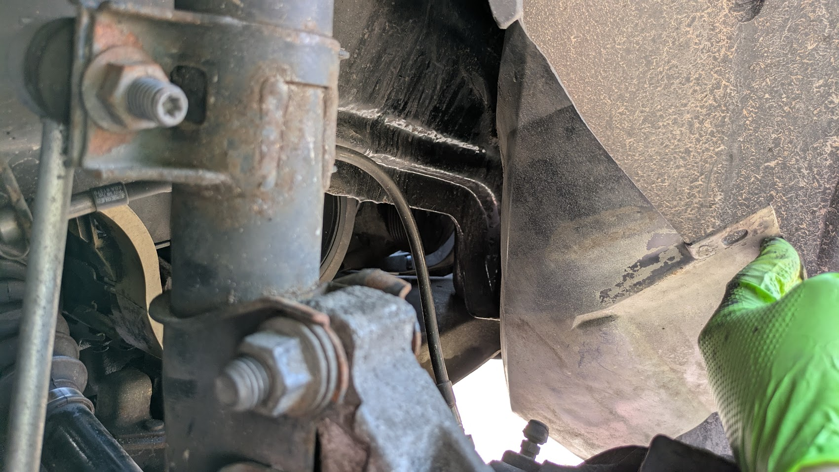

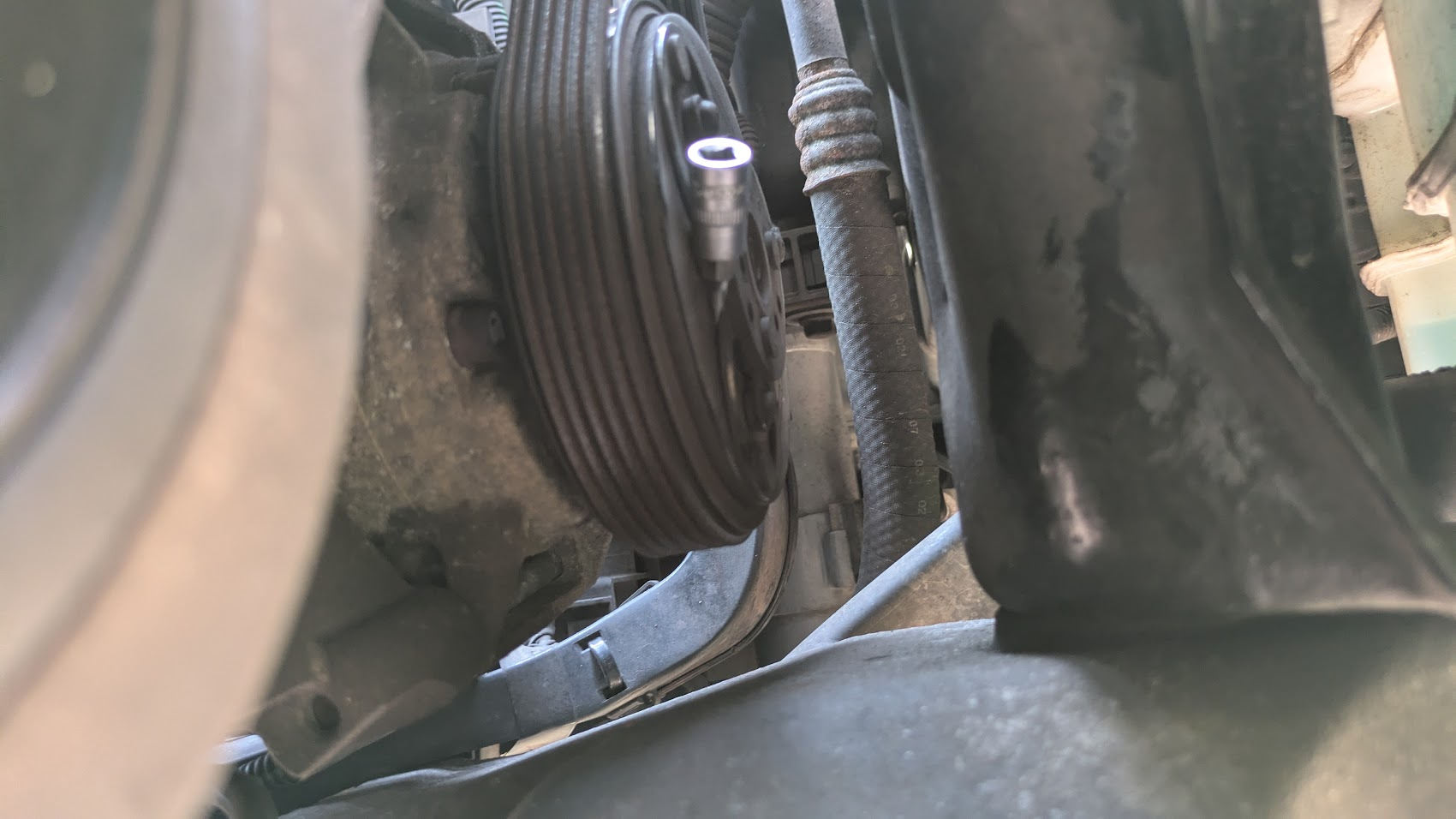

I learned about this fix after having the refrigerant replaced in my 2002 Volvo S60 and the error that the compressor only cycled for a few times remained.
The P2 platform unfortunately has very little space to access the compressor and it seems like clutch is made a little bit different. One way or another, I couldn't even get in a zip tie behind the flower-shaped sping.

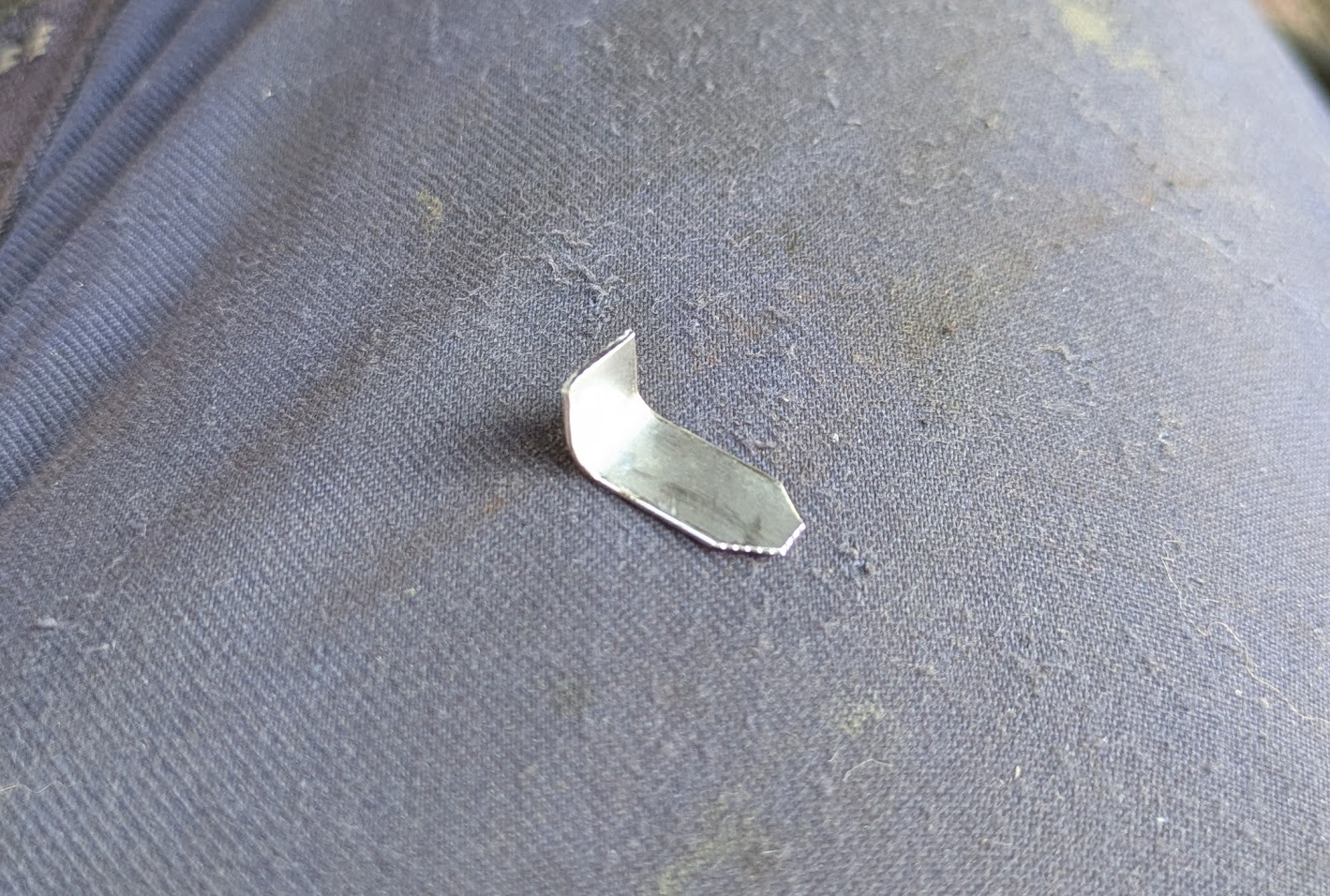

So I cut up a metal stap which had the right thickness and bent a small L-bracket out of it to slide behind the spring. That bracket then got bent up so it won't fall out and the gap was pretty much perfect at around 0.4mm.
In total I added three of the brackets and the gap was very consistent, so I didn't bother putting another three in.
Maybe that helps someone who struggles with zip ties when the gap isn't big enough :)
