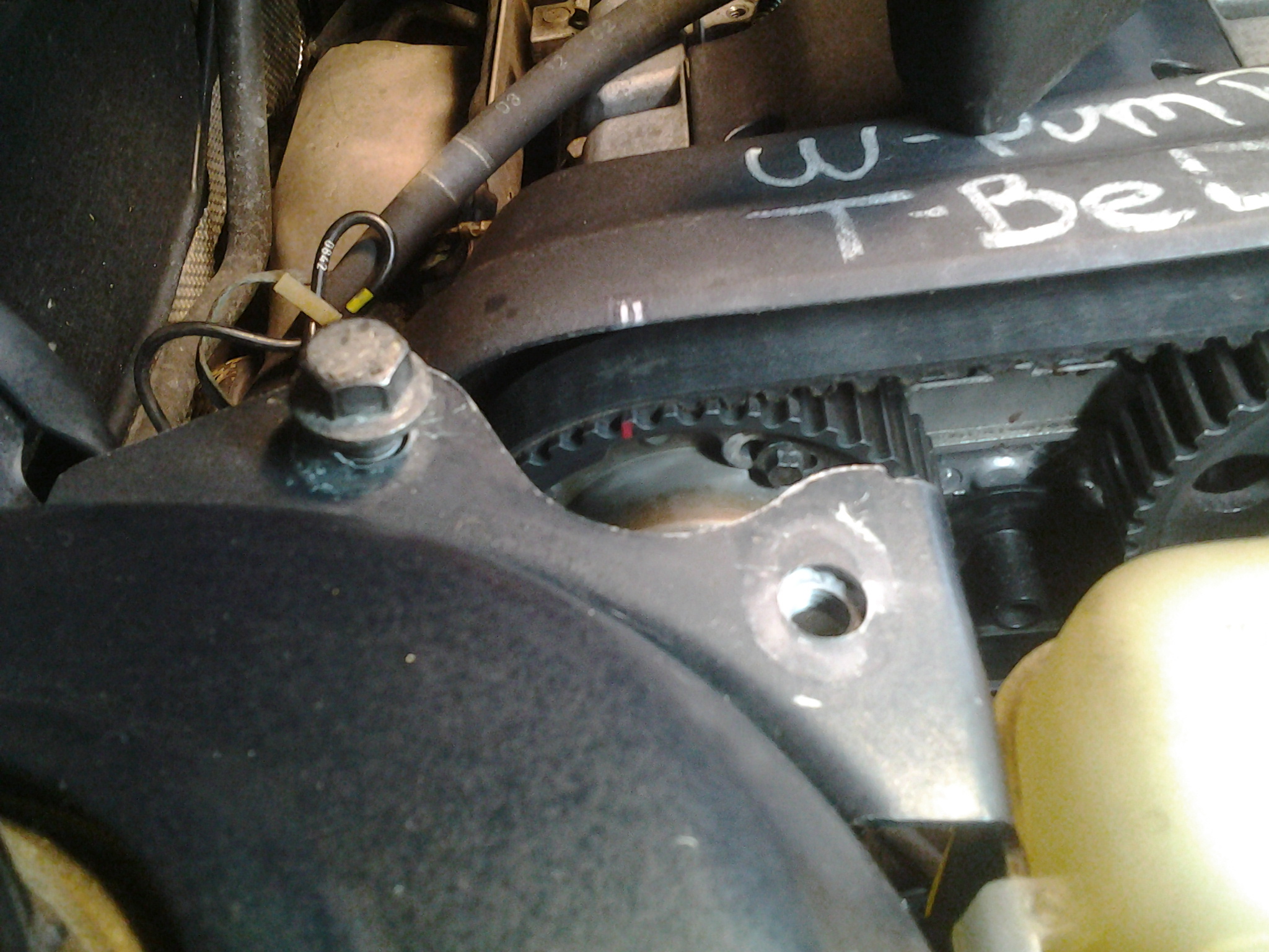

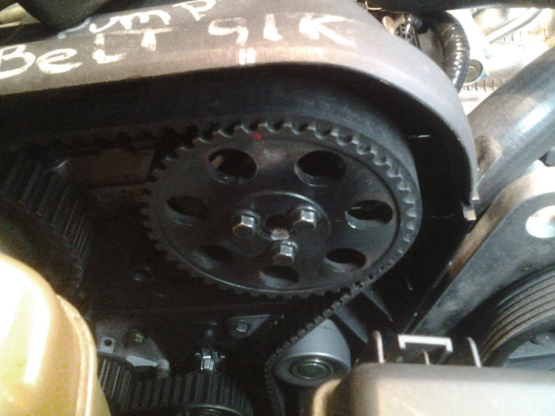

Taking a second look at your pics it looks like you're spot on with front marks, rear slots also, only problem is vvt all the way clockwise. I'd adjust vvt such that when 8mm screws are mid-slots the sproket mark lines up to cover. If you lock back slots then your vvt sproket mark shoud be just before 12 o'clock (cover mark) if adjusted correctly. Then if you turn clockwise by hand it should go to 12 o'clock.

Thanks for all the help it really has been spot on, unfortunately its all been for nothing, got the timing bang on with the help of the cam/crank locking kit and cvvt adjusted perfectly thanks to draser's advice.
With the 2 codes I recieved today though im thinking its the end of the road, p0121 and p1608 I was prepared to replace the throttle body more so after removing the starter when I locked the crank and making sure that pesky cable was freed from behind it, the last code though from what I've read on the fault code list on this site (thanks again) is an ecu malfuntion which from what I understand could be the root of all the problems but even if i spend ££££ to replace it still might need a new throttle body or might not, big gamble so im moving on im affraid, cheers again. Jim
