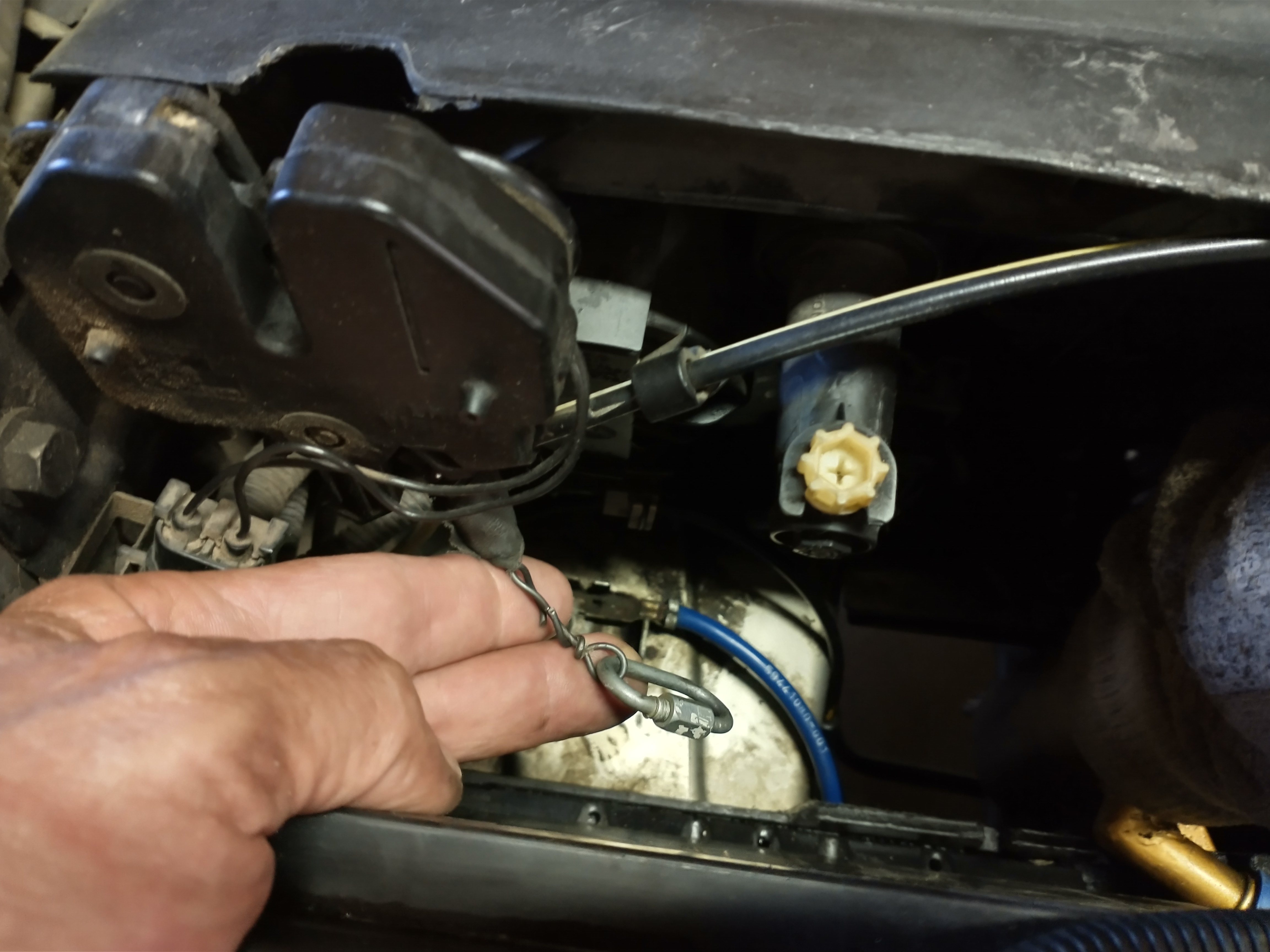

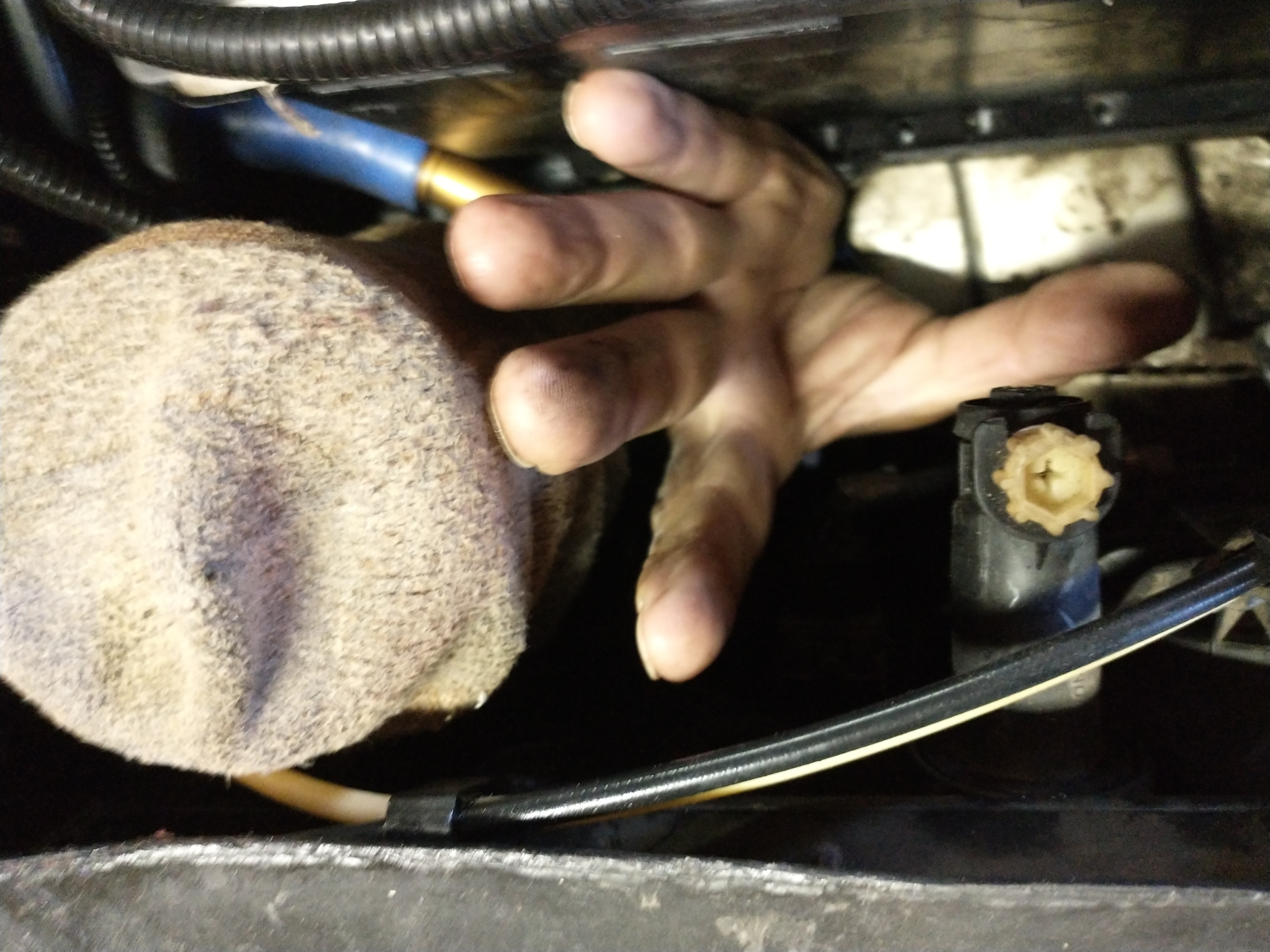

I rarely use the inside release lever because I don't want to break it. If you look, it's a pretty easy reach latch from down in front. I don't even have to lay down anymore to do it. From underneath reach up inboard of the ATF line going into the radiator and up behind the DS headlight and push the tab on the latch. I wrapped mine in tape to make it more comfortable to push, with a wire hanging down to make it easy to find and follow from underneath. Pushing it releases both latches. Could not be any easier.

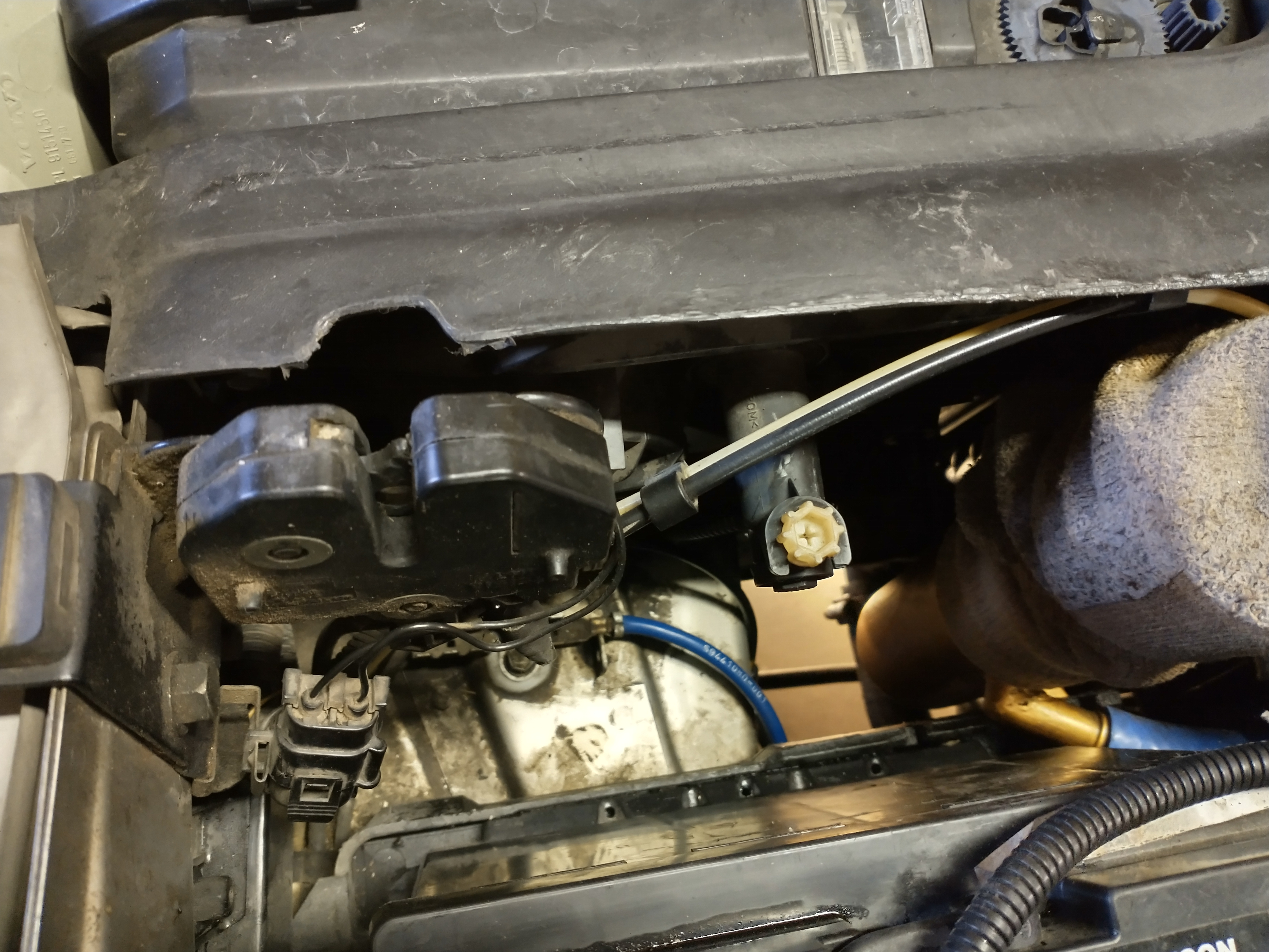

For illustration proposes only....
Area where I reach up into. I have catch can mounted there so most folks will have more room.
Doohickey with tape / wire that hangs down

Quite interesting how you get your hand in there. Is this a Turbo with AC?
I guess you don't have the splash shield on?
