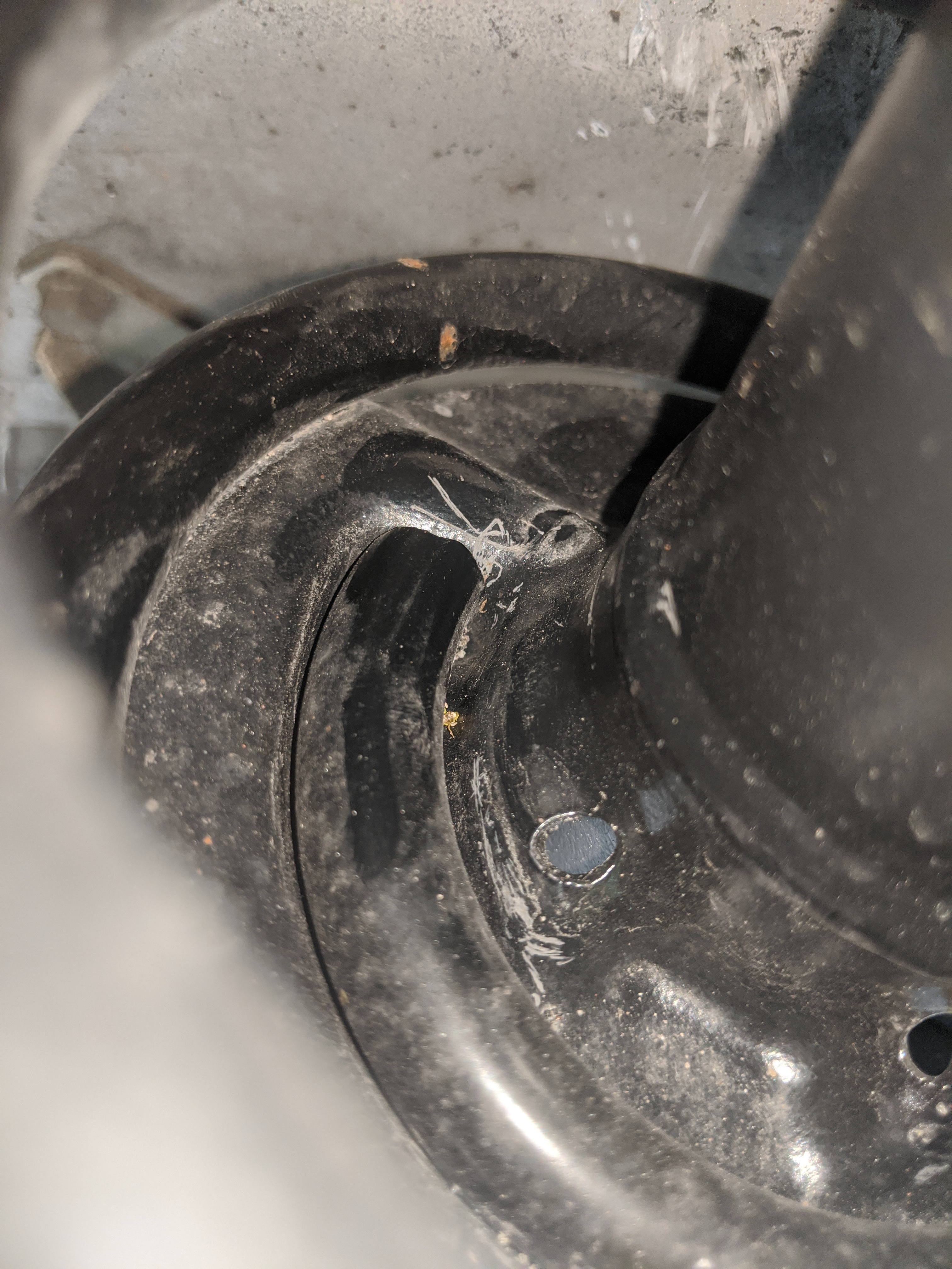

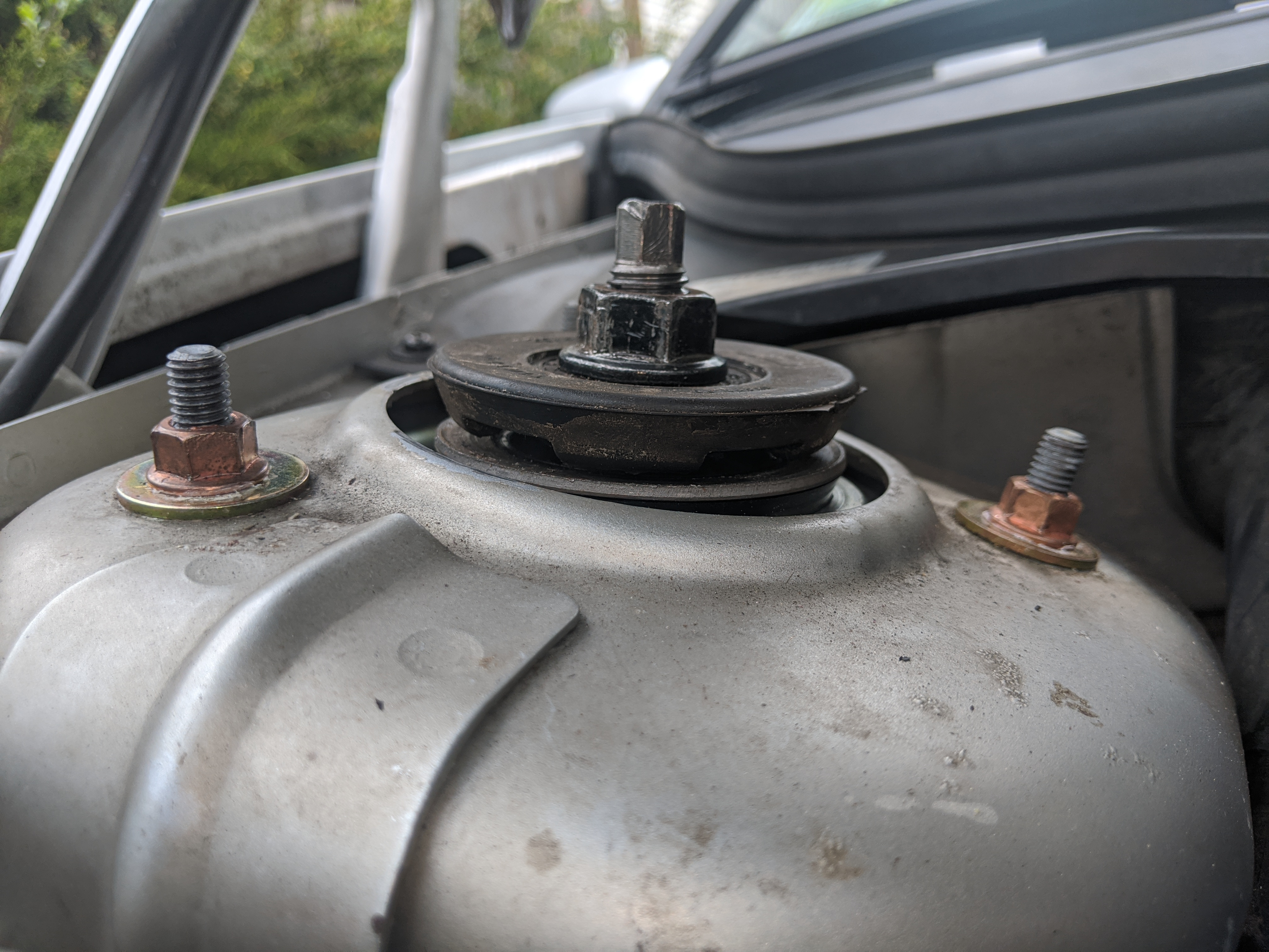

In the third photo I can see the fender liner mounting hole is torn from the plastic nut. This lets the fender liner flap and will rub the wheel when turned to the right.

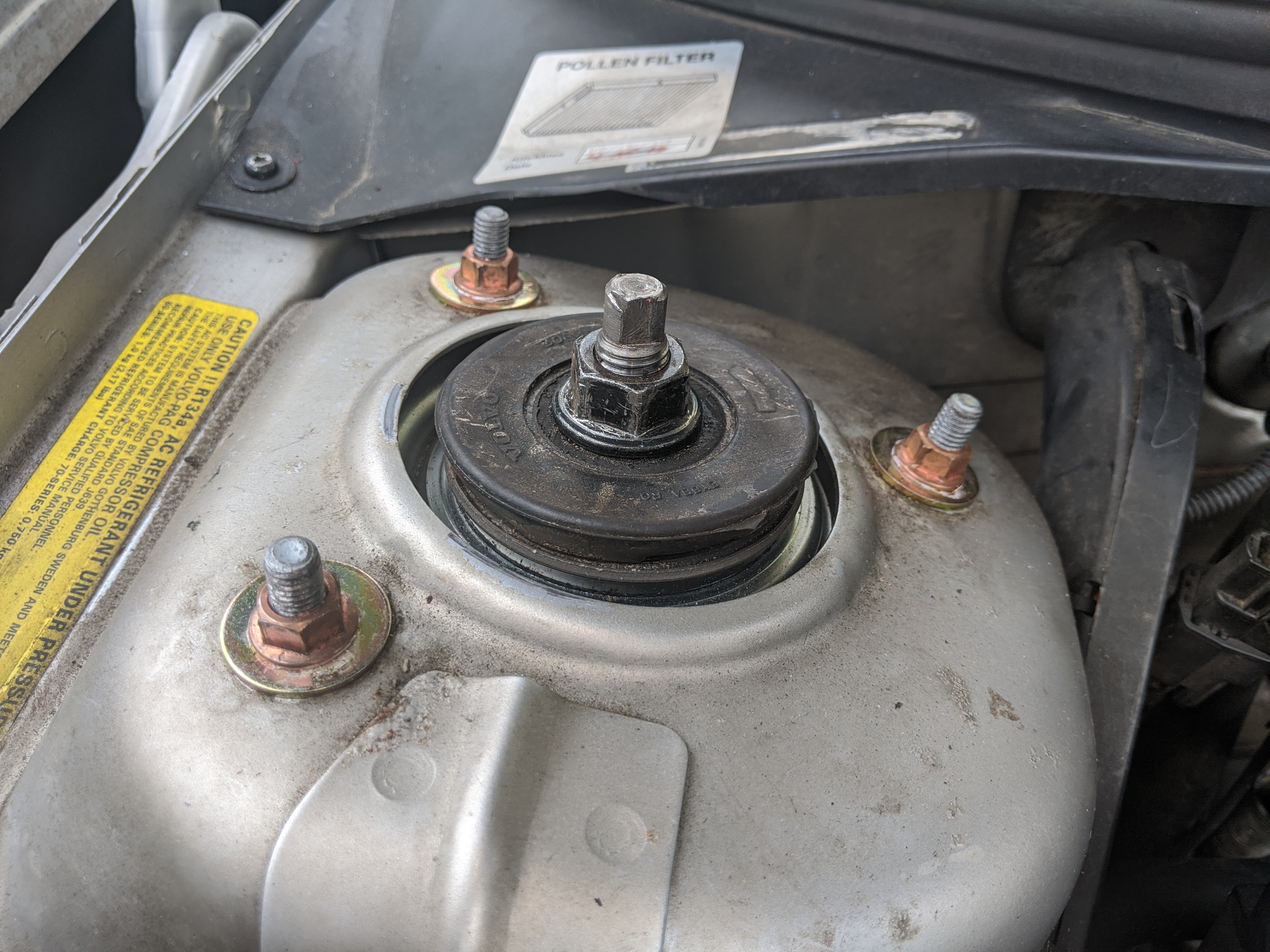

I popped it out to access the motor mount, it seems to hold pretty tight when I put it back in.volvolugnut wrote: 16 May 2020, 12:04 In the third photo I can see the fender liner mounting hole is torn from the plastic nut. This lets the fender liner flap and will rub the wheel when turned to the right.

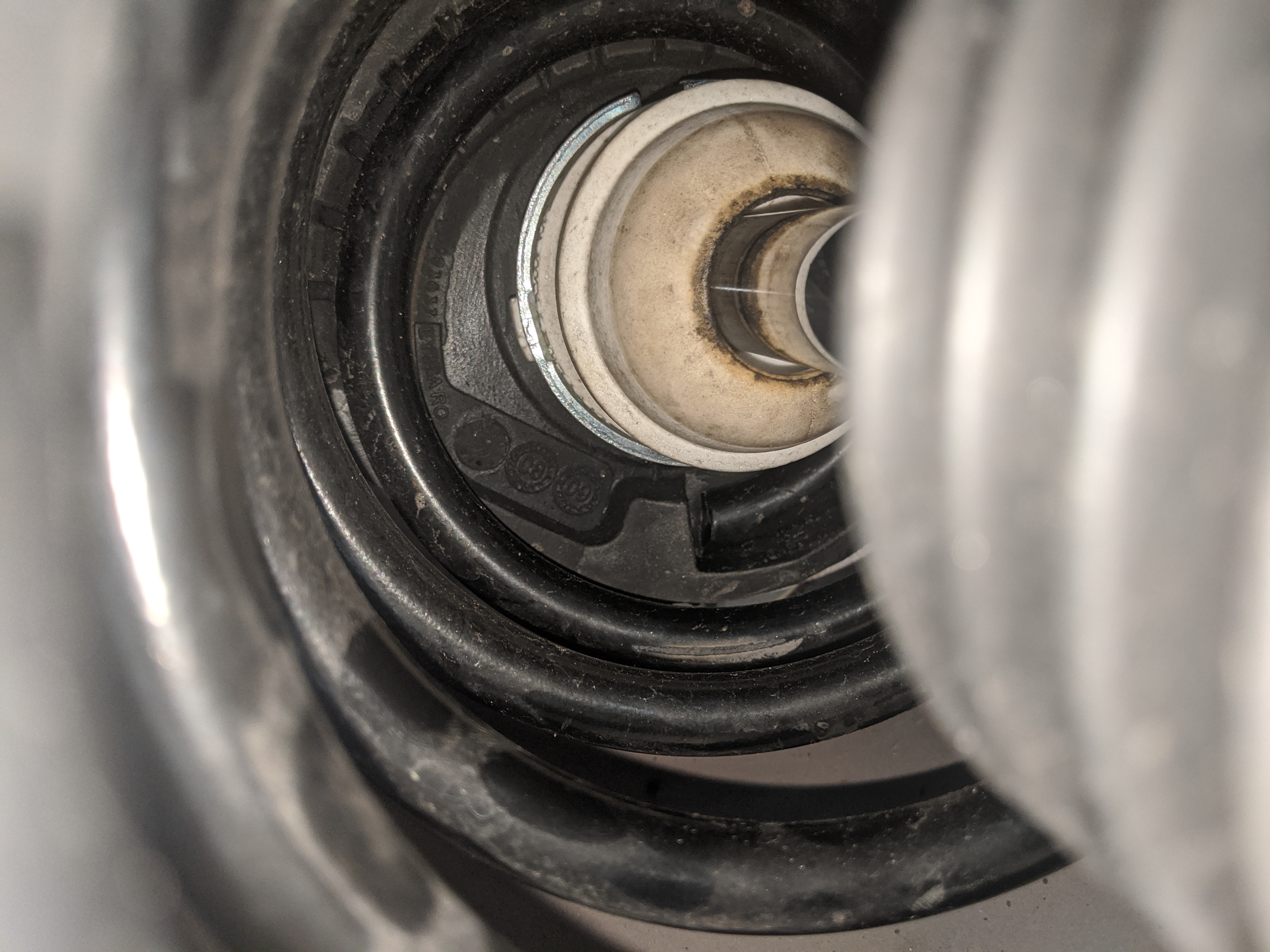

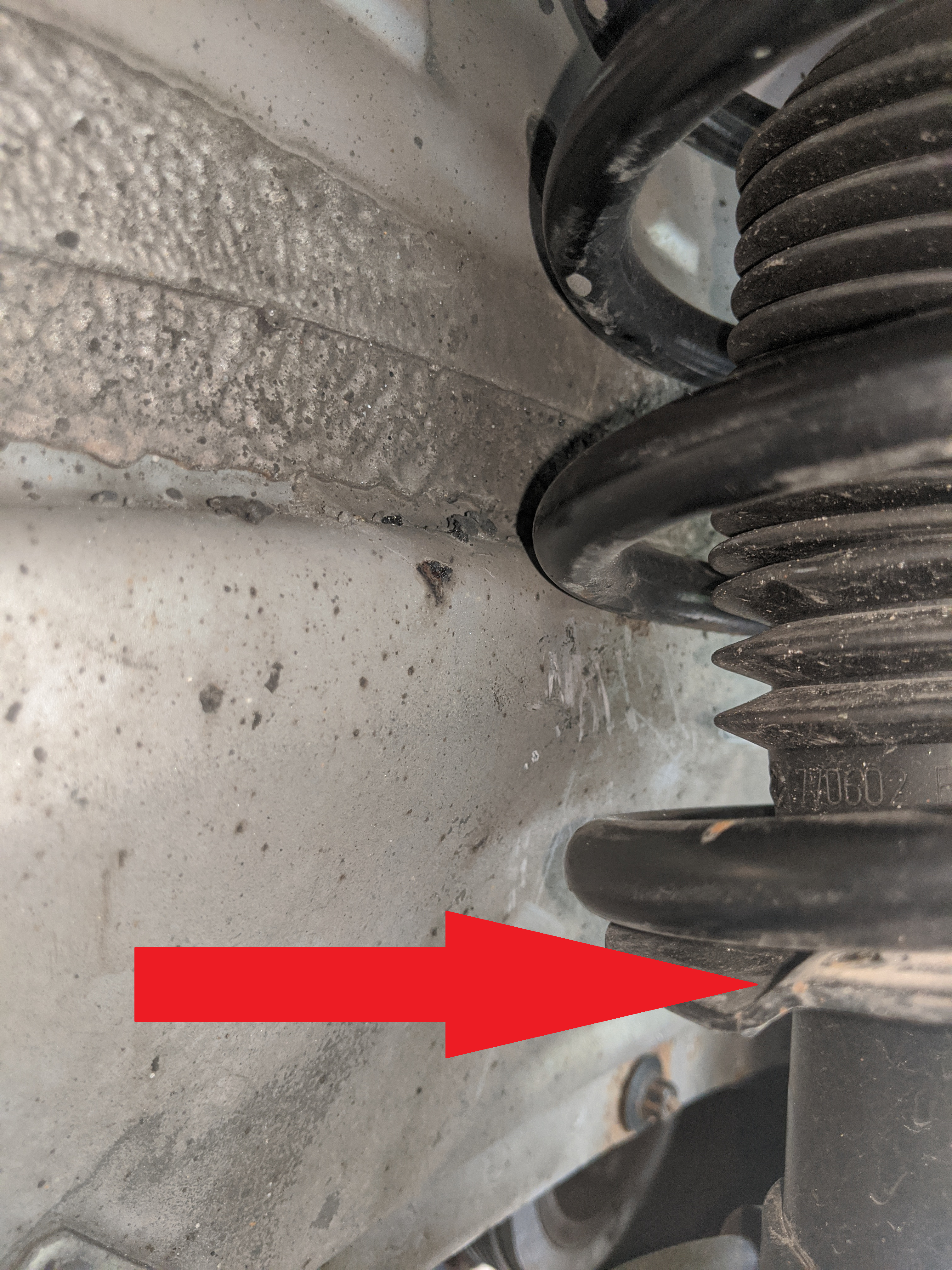

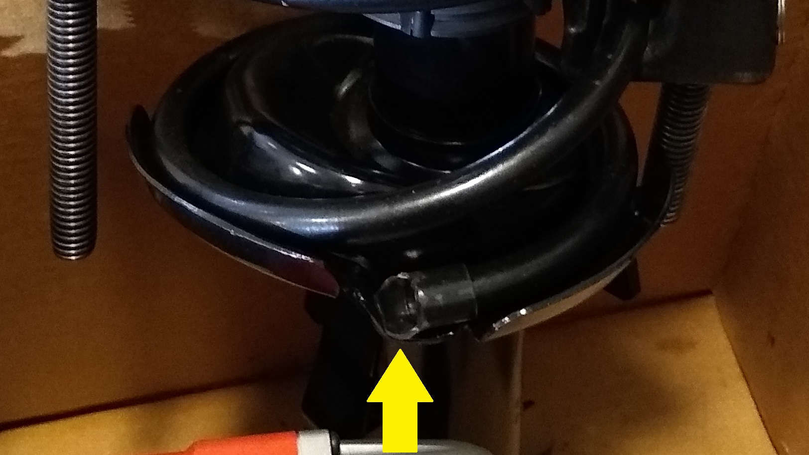

Difficult to see but it looks like the spring end is not seated in the spring perch. If so the spring may not be centered (floating) with the strut and rubbing against the body?
The spring end perch has a spot where the spring end rest. I added a tubing on the spring end just in case the spring end rubs against the perch. The tubing is cut at an angle so it does not hold water and debris.

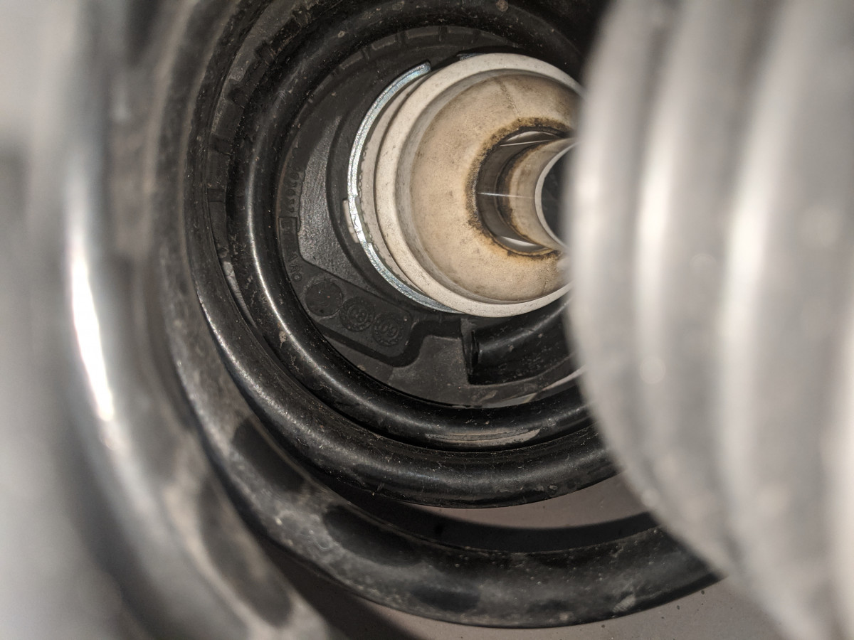

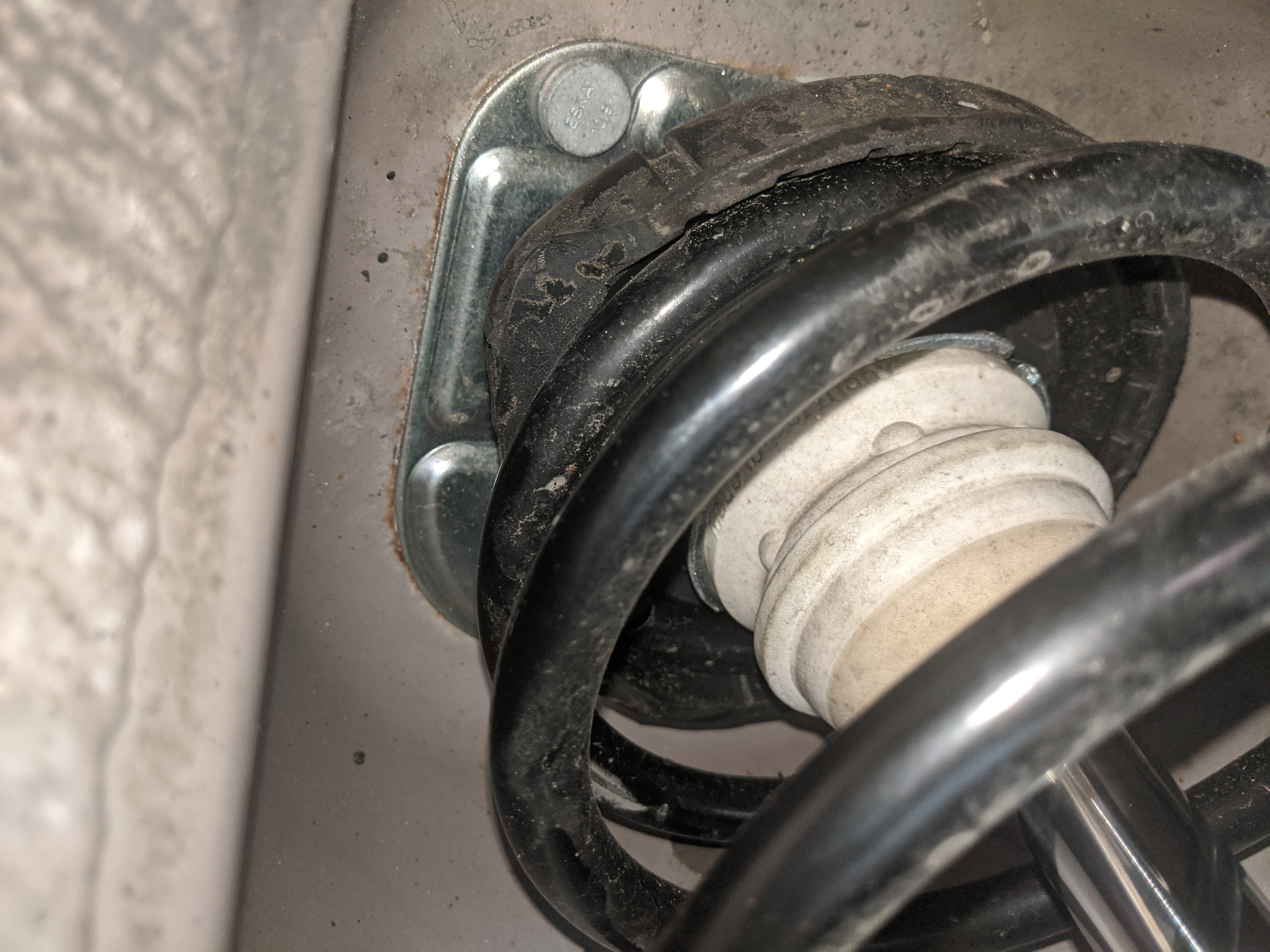

I was wondering about that, but it looks like I've got it in the chanel? How do these photos look?
The first photo is with the car on the ground wheels straight forward. second photo of the strut mount is with the car jacked and the wheel off

I see the spring spiraling inward on the top and bottom so it seems OK. Do you get an alignment print out of before and after specs? I'll check Volvo's diagram to see if it's possible that something could be bent so the SAI angle is off one side vs the other.smacknab wrote: 16 May 2020, 13:03 I was wondering about that, but it looks like I've got it in the chanel? How do these photos look?

I don't see anything that's obvious. The knuckle can't be bent so if anything is off would the strut or LCA being bent. It would have to be such so the strut is pushed towards inner portions of the fender well.

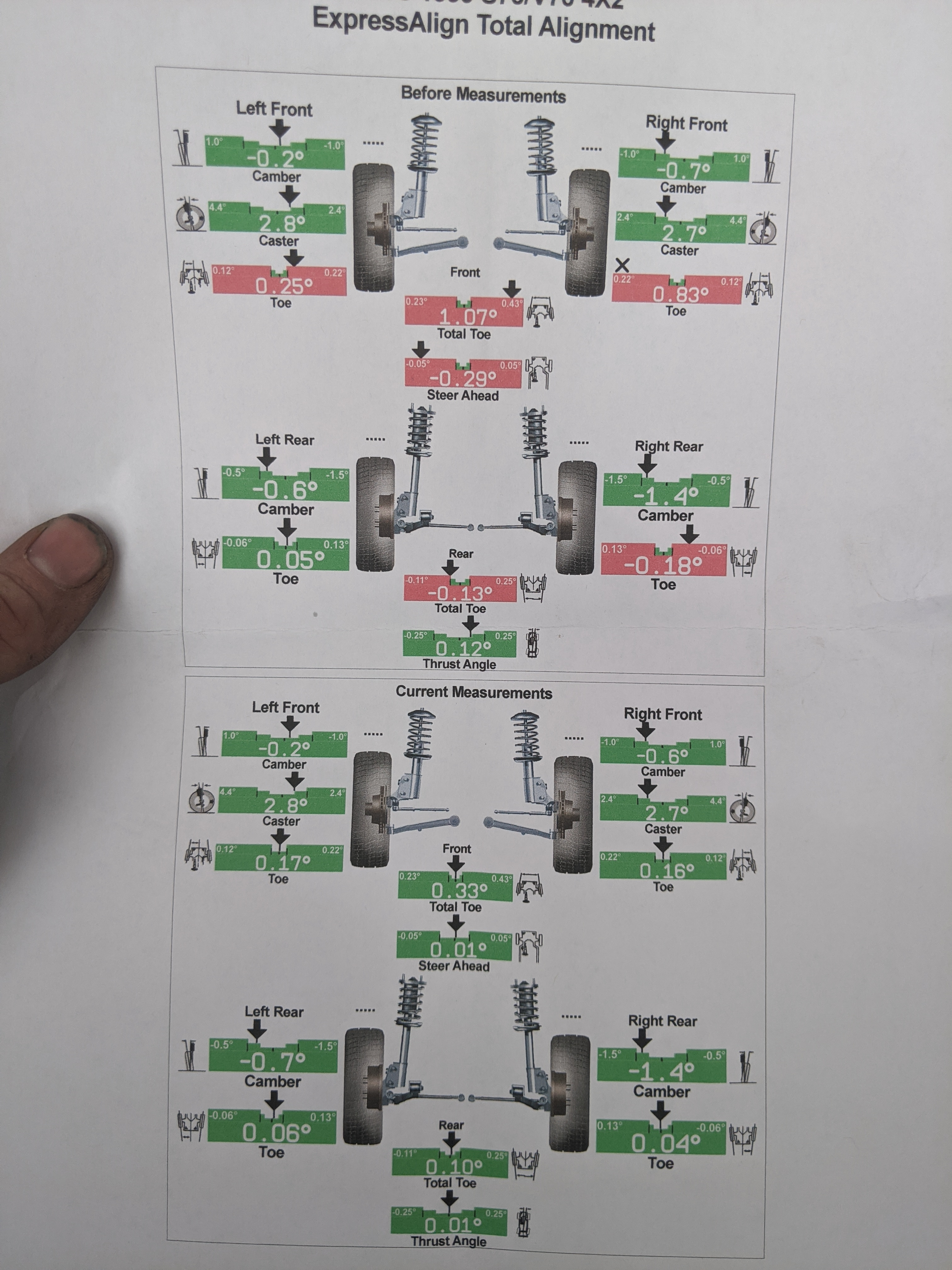

Hey Mo,
Thanks for looking that up. He's a photo of the alignment I got in March.

The alignment specs look good. More Caster on the left and more negative Camber right front and rear so the car will still drive straight on the crown of the road. Positive toe front and rear with no thrust angle or steer ahead also promotes driving straight and perform well if the steering wheel is centered. They don't show SAI which helps to diagnosis bent suspension parts but I think your alignment tech would probably say something if he saw that it was off. Specs will also help reduce tire wear. I'll take a look at the parts.
