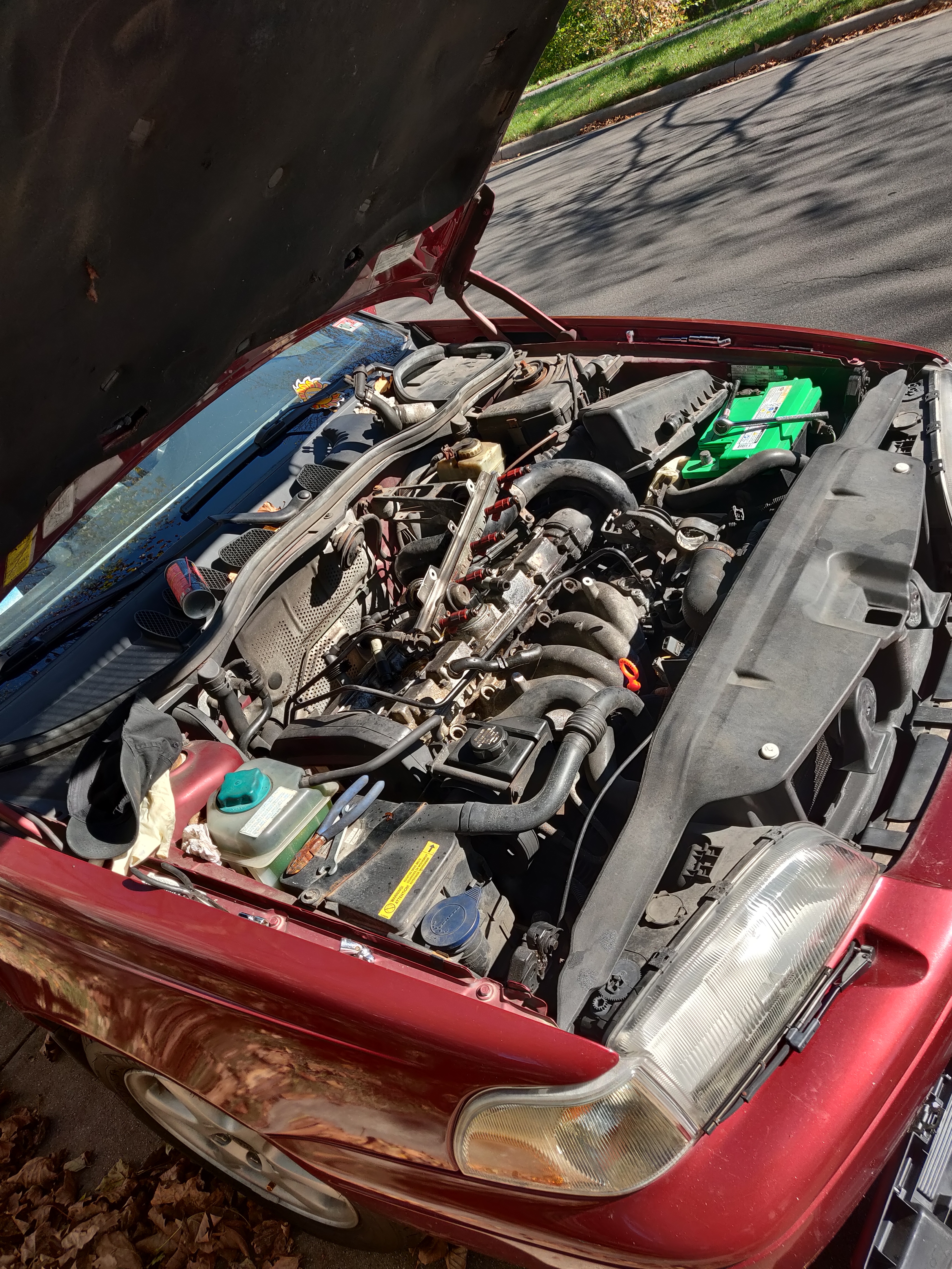

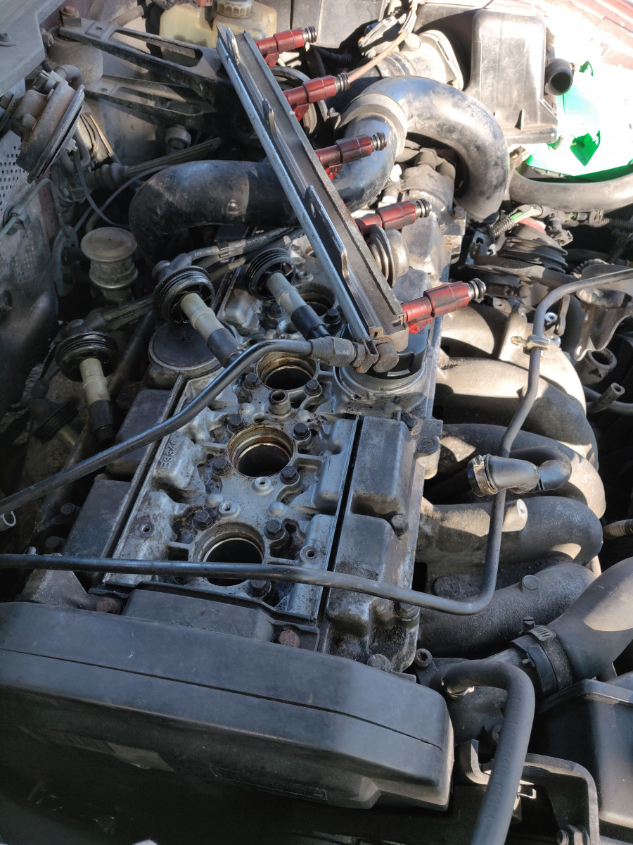

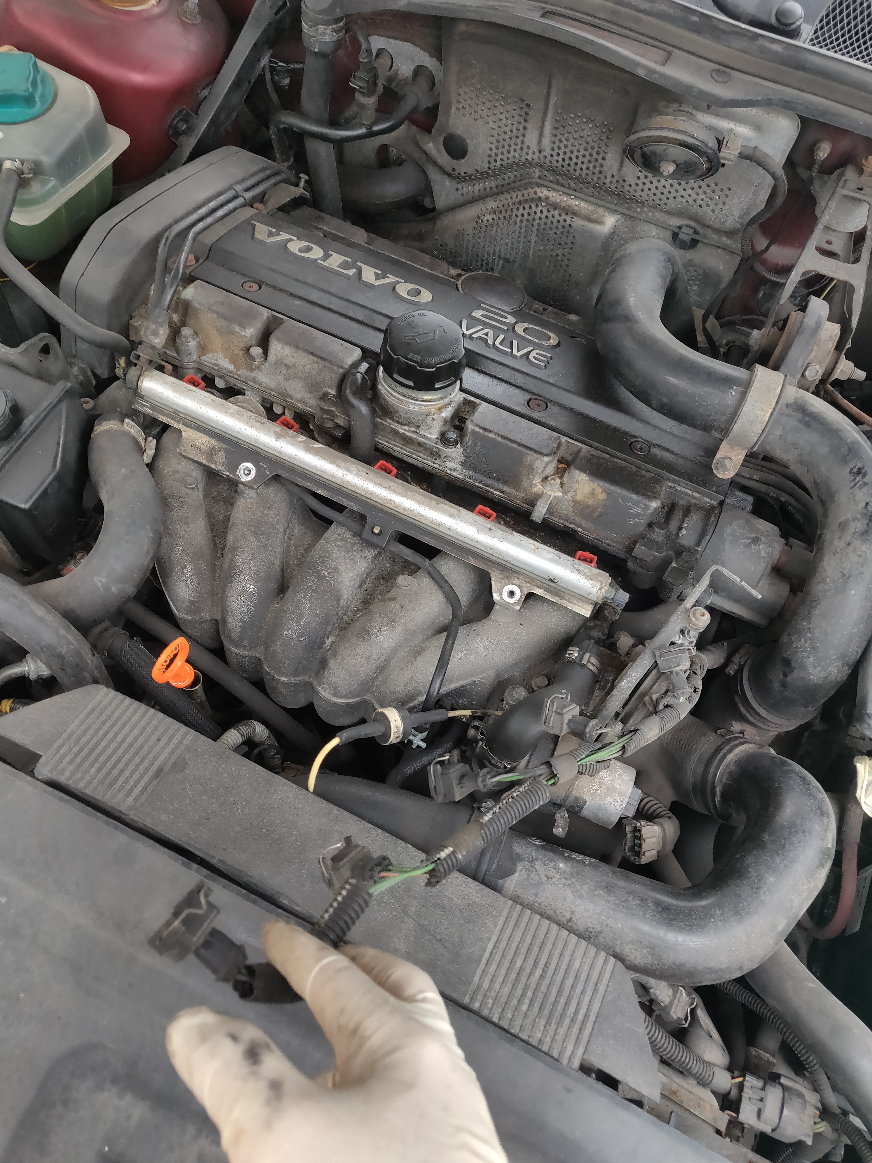

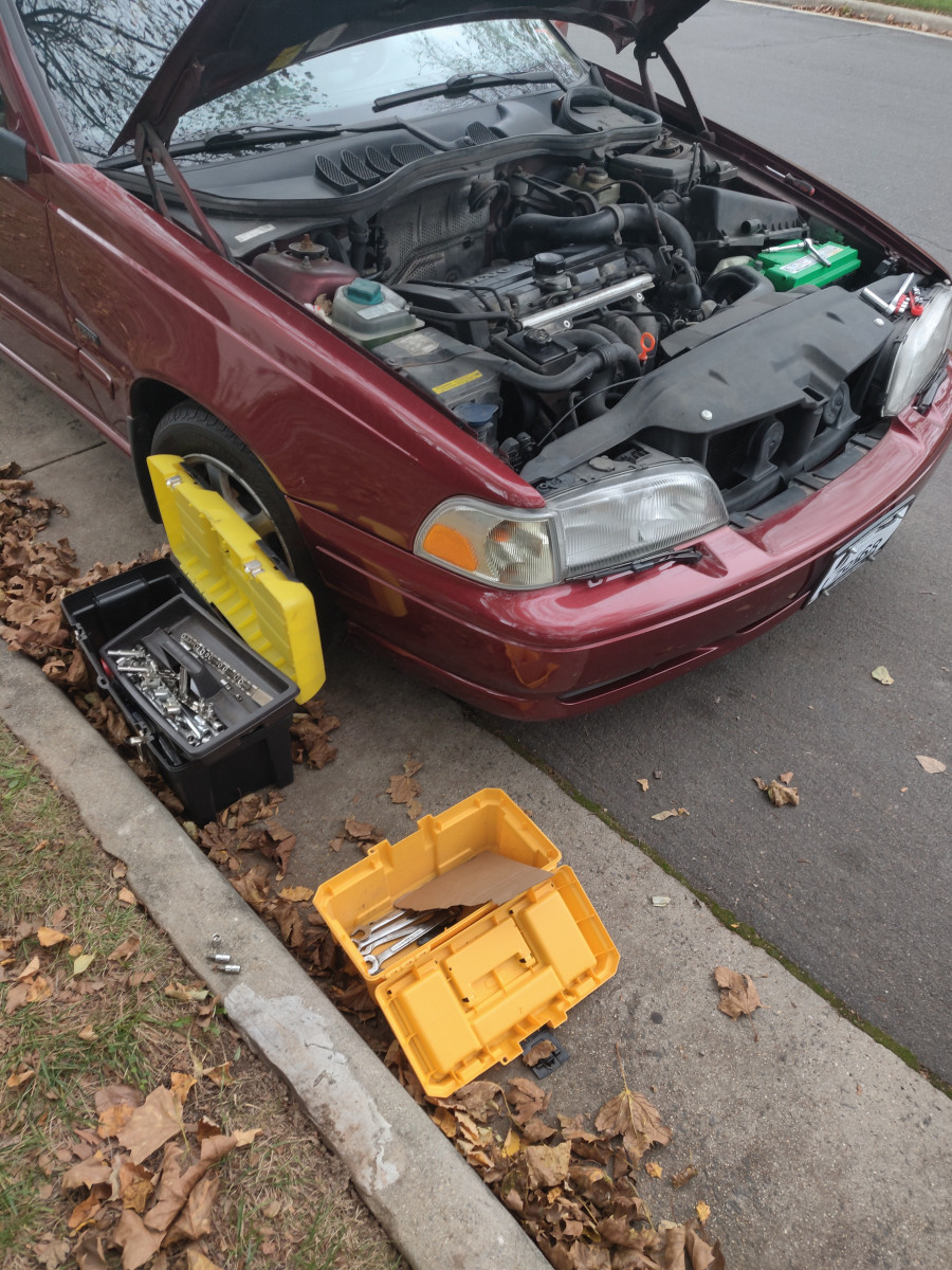

Thanks. I started today and gonna get back on it for a little bit.
I took a bunch of pics! Woot woot!

how much turbo tubes come off. Still have to get the top of the aitrbox out of the car.....do I have to remove that down by the turbo?
intake water hose and bolt under neath...wtffff lol
have to go buy 5/8 fuel line upgrade
Why to I need the home depot hose clamp?
Some questions...
Some questions...

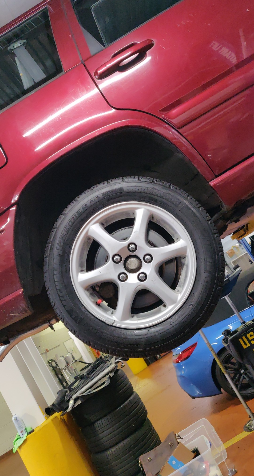

Yeah it's kinda good-looking , some dents and stuff. Here are a few more pics
Those are the wheels. And the others are before a mini detail

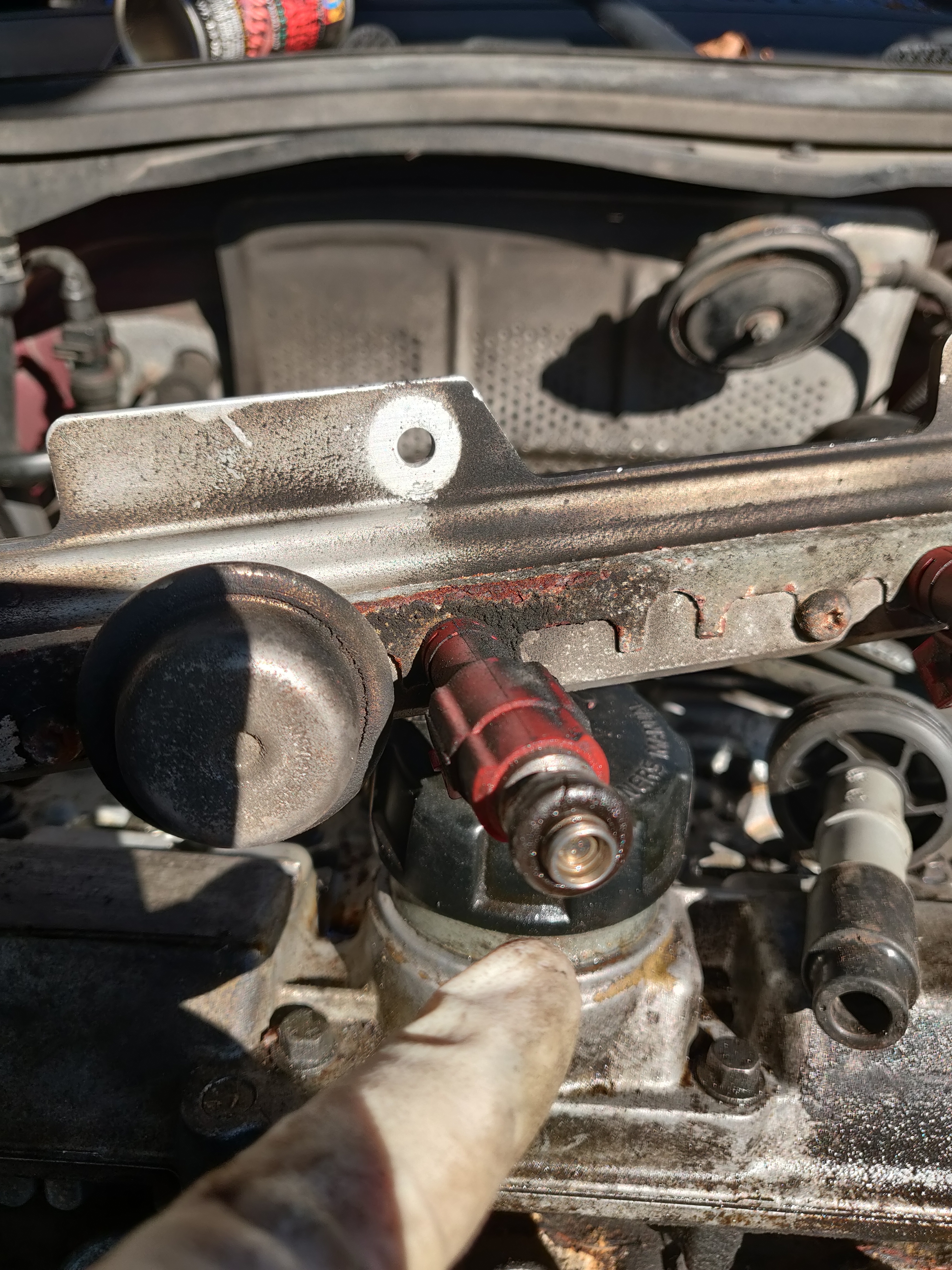

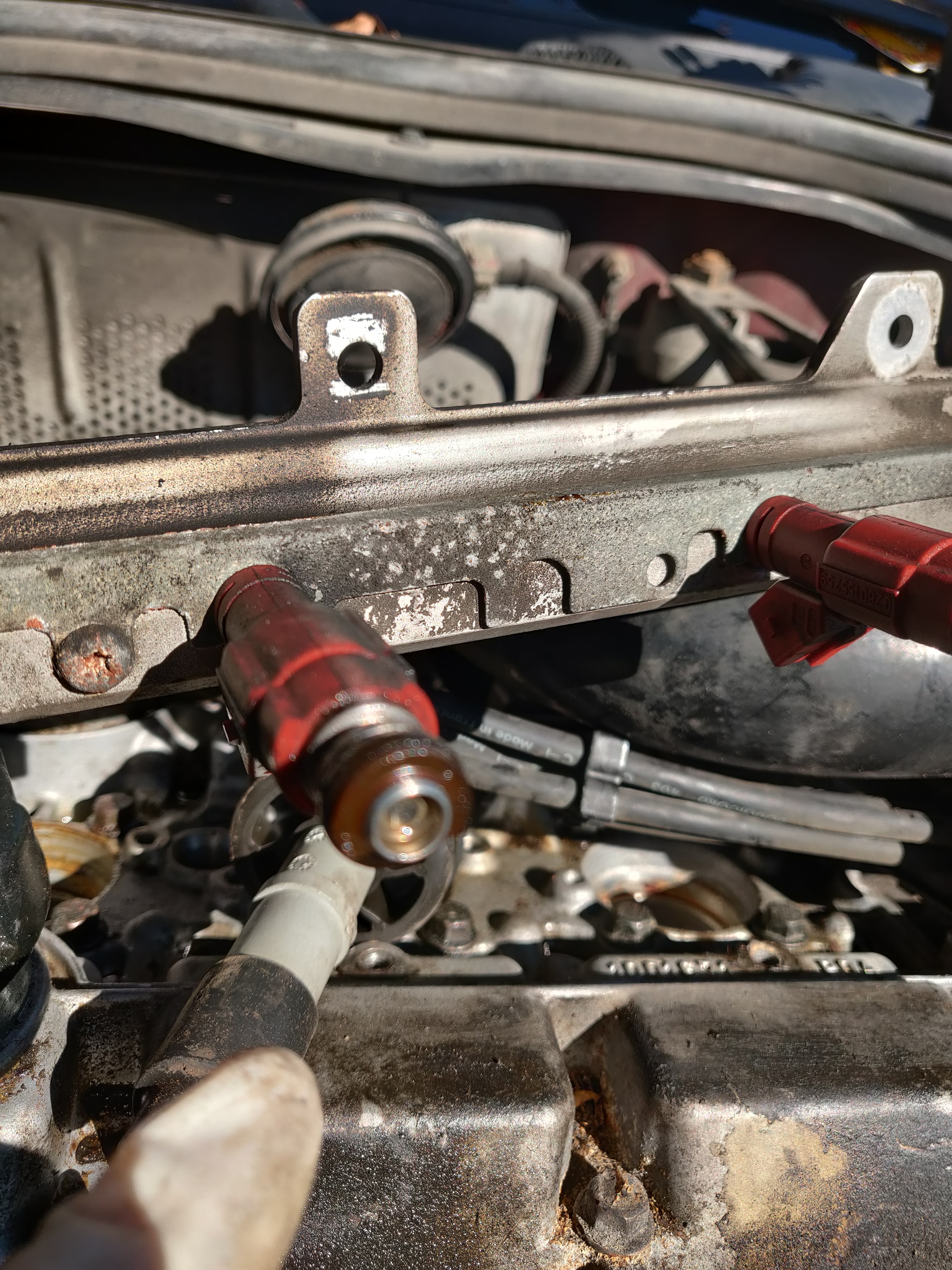

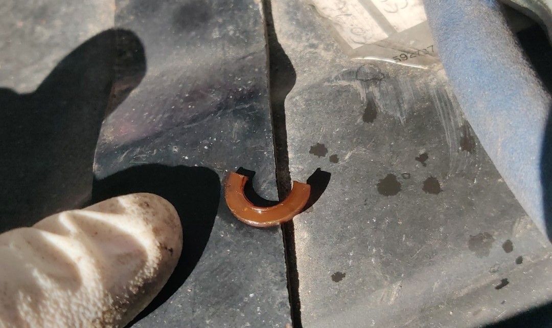

Did mine last weekend with the Genuine Volvo kit from IPD. All went well except when trying to replace the O-ring on the first injector (figured I might as well do it since the kit included them) the pintle cap on the injector broke. So, if you do decided to replace the O-rings be very careful not to break the pintle cap -- mine are old and brittle.
My parts car had a full complement of injectors, so I just replaced the injector. Ran a bit rough at first and threw some misfire codes on cylinders 1 and 2, maybe because of air that got into the fuel rail when I replaced the injector. Maybe should've primed the fuel system by turning the key off and on a few times to operate the fuel pump.

mkc1 wrote: 17 Oct 2020, 07:58 Did mine last weekend with the Genuine Volvo kit from IPD. All went well except when trying to replace the O-ring on the first injector (figured I might as well do it since the kit included them) the pintle cap on the injector broke. So, if you do decided to replace the O-rings be very careful not to break the pintle cap -- mine are old and brittle.

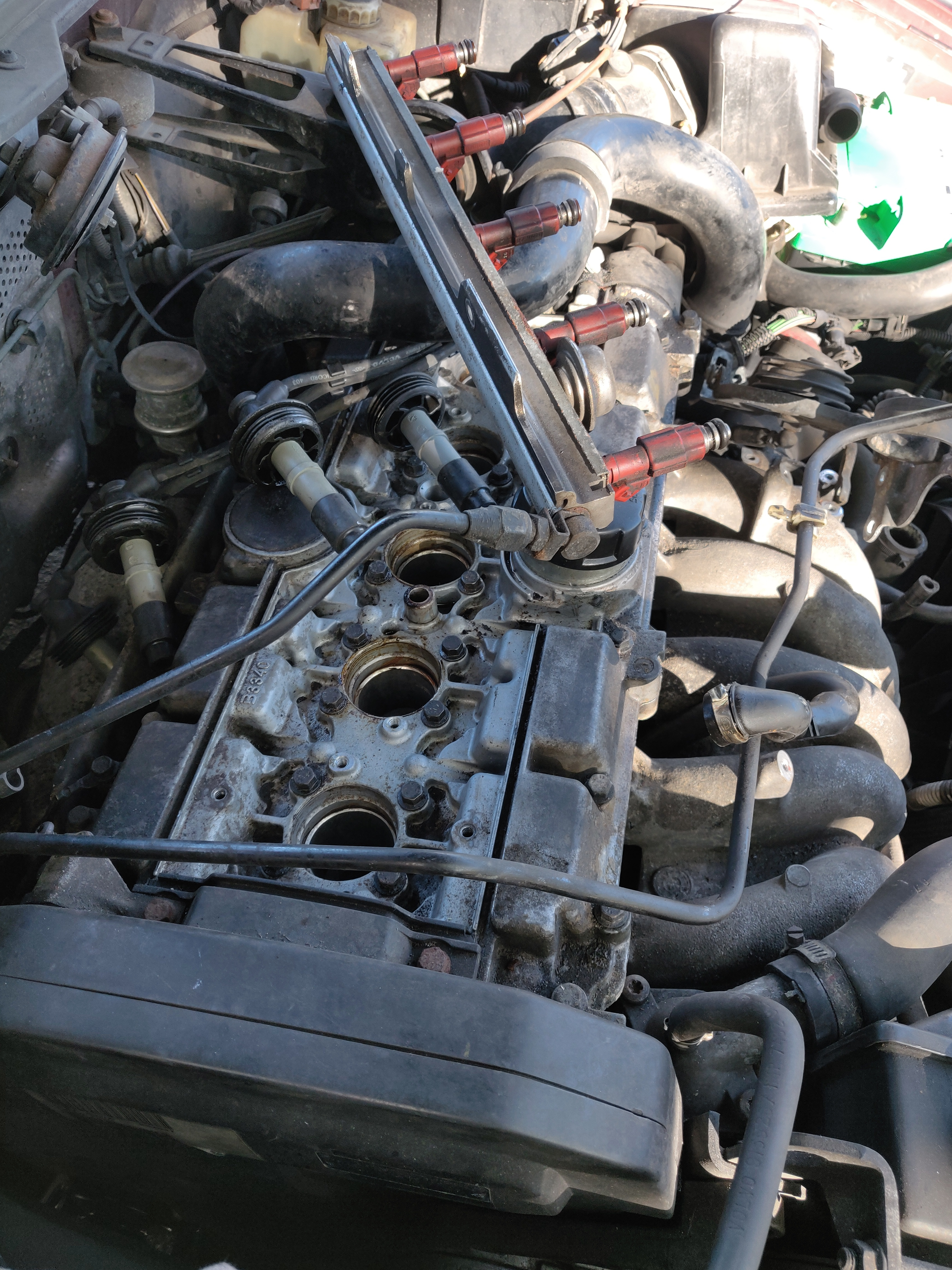

Pintle caps are all messed up. I can I can put the ring o-ring on it however the small plastic piece that holds the o-ring on the injector is broken see my pics

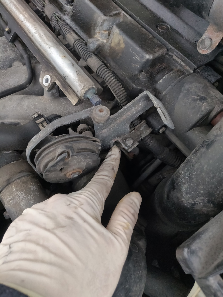

The hardest thing is getting the bolts off the manifold I suggest having a lot of extensions a lot of different size socket heads tall and short and have socket knuckles or whatever they're called so you can position the socket on directly on the bolt
I am working on the last manifold bolt near the power steering and coolant hose intake. Ouch!

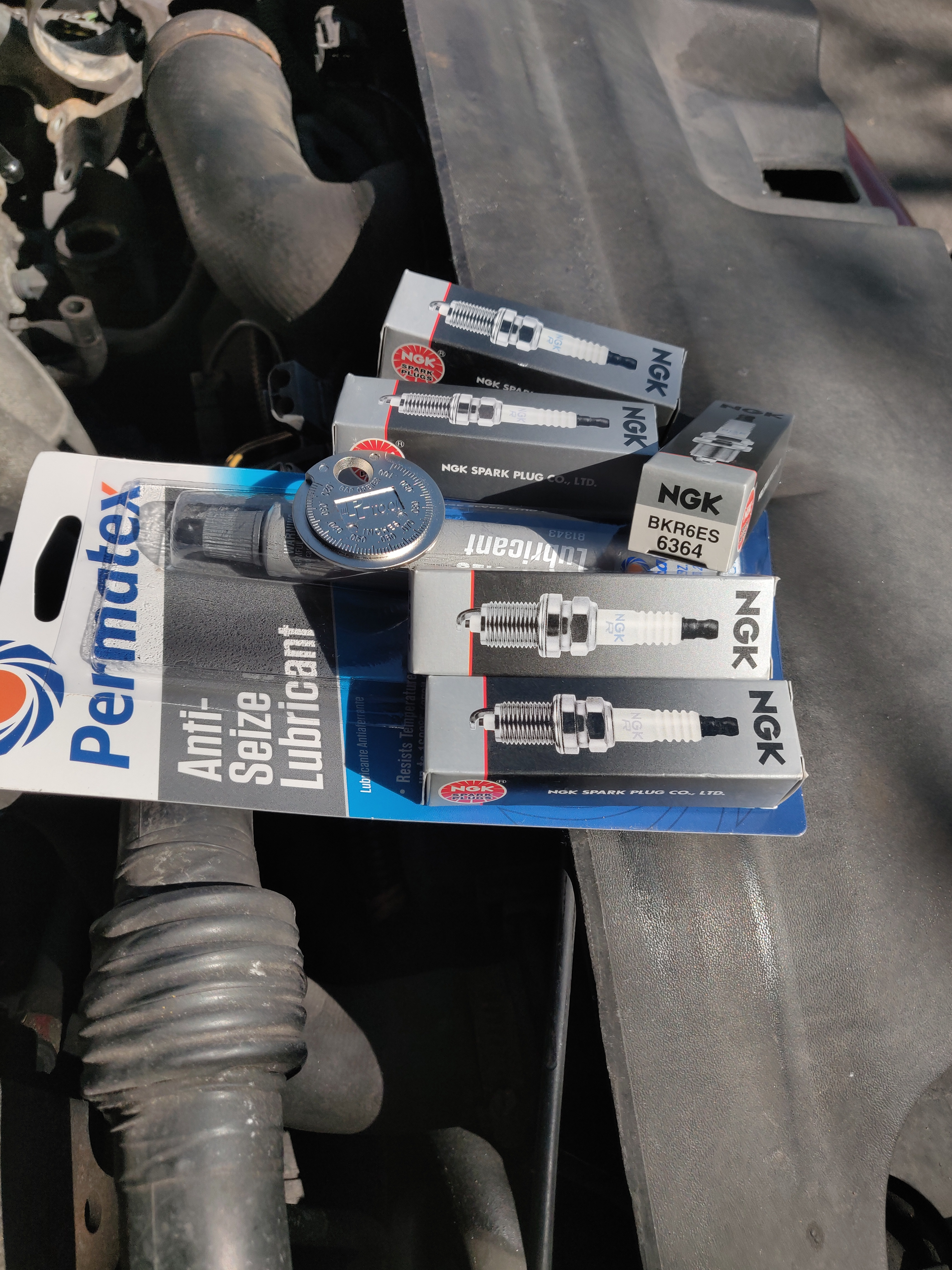

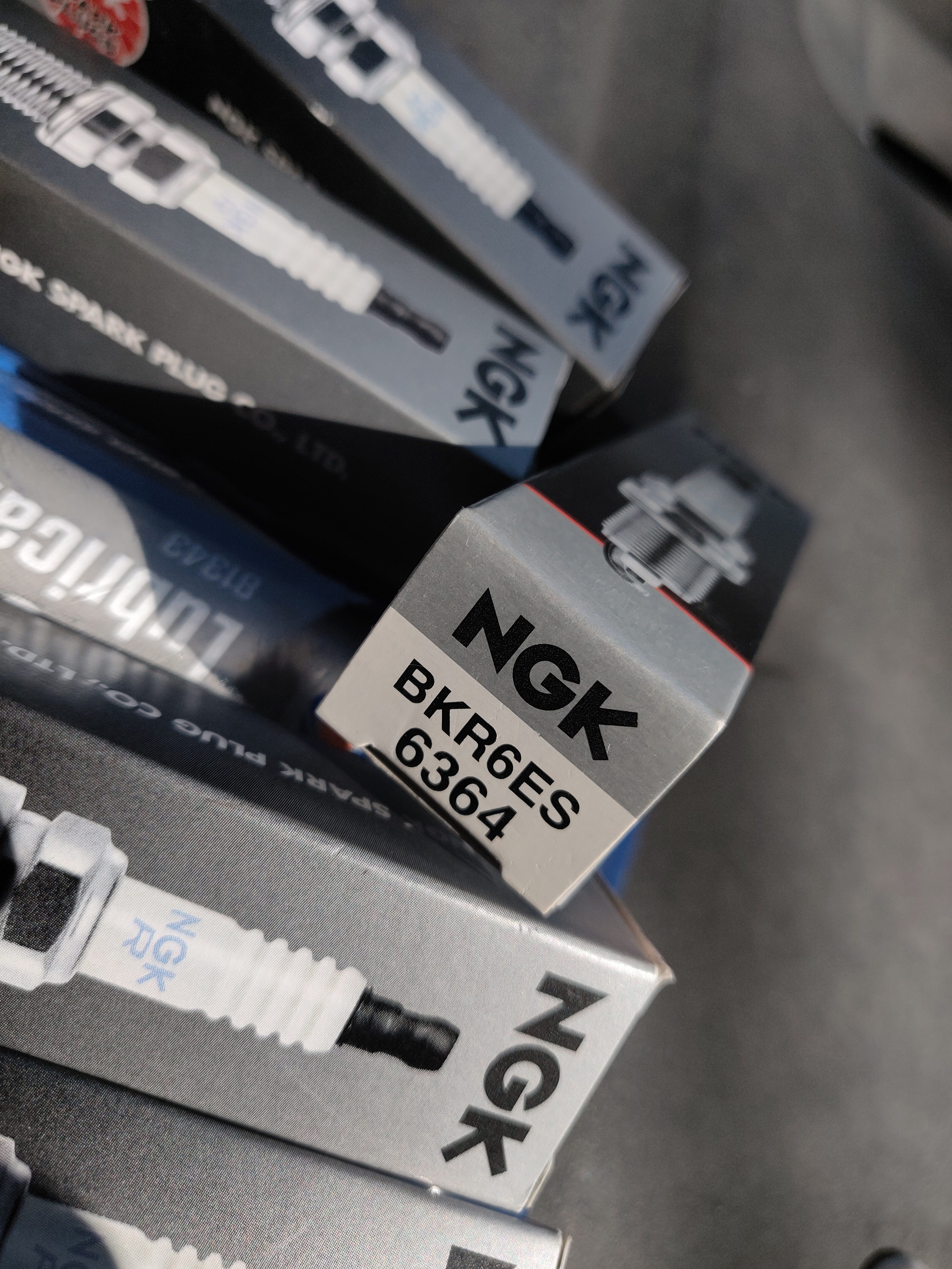

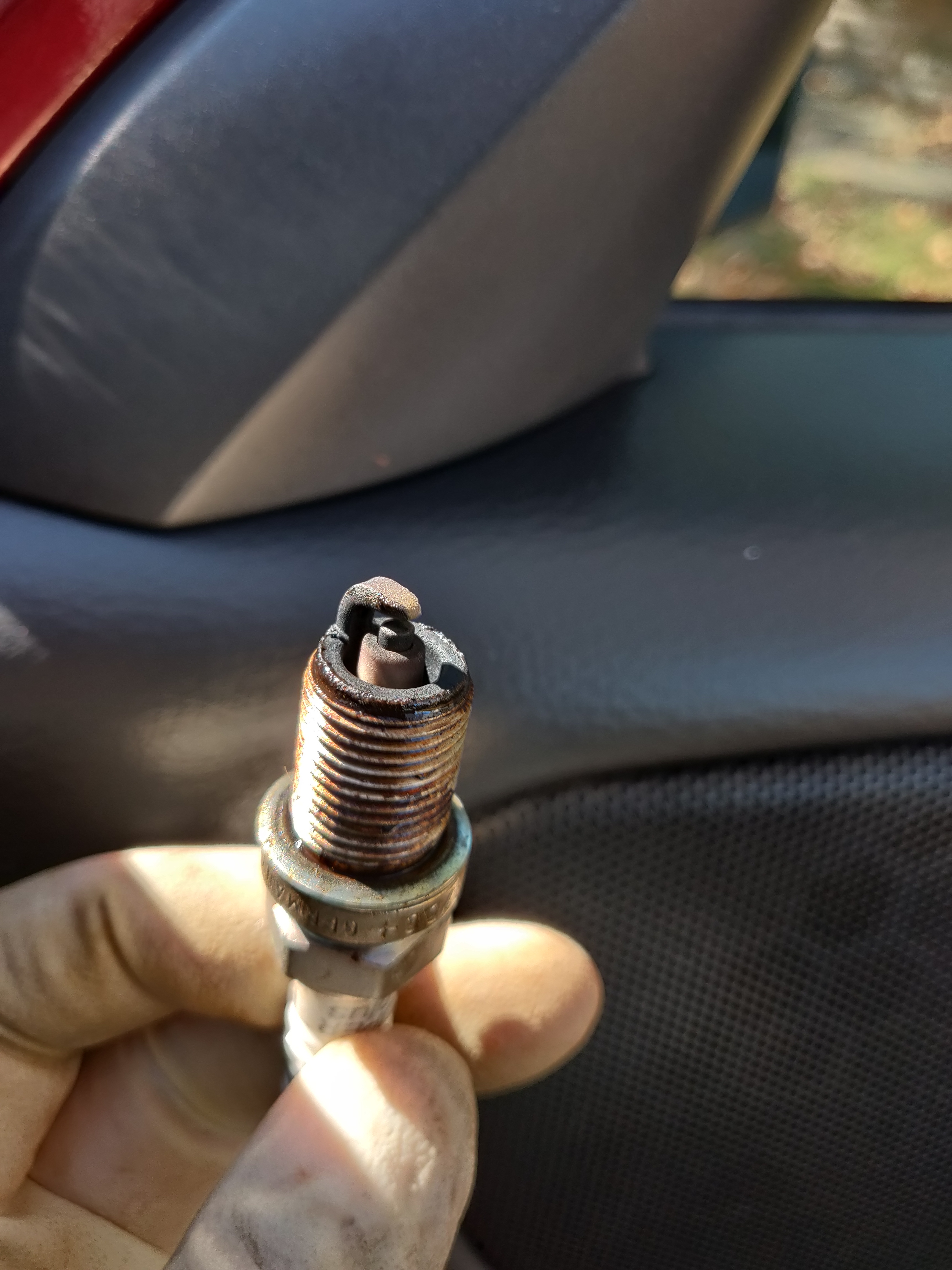

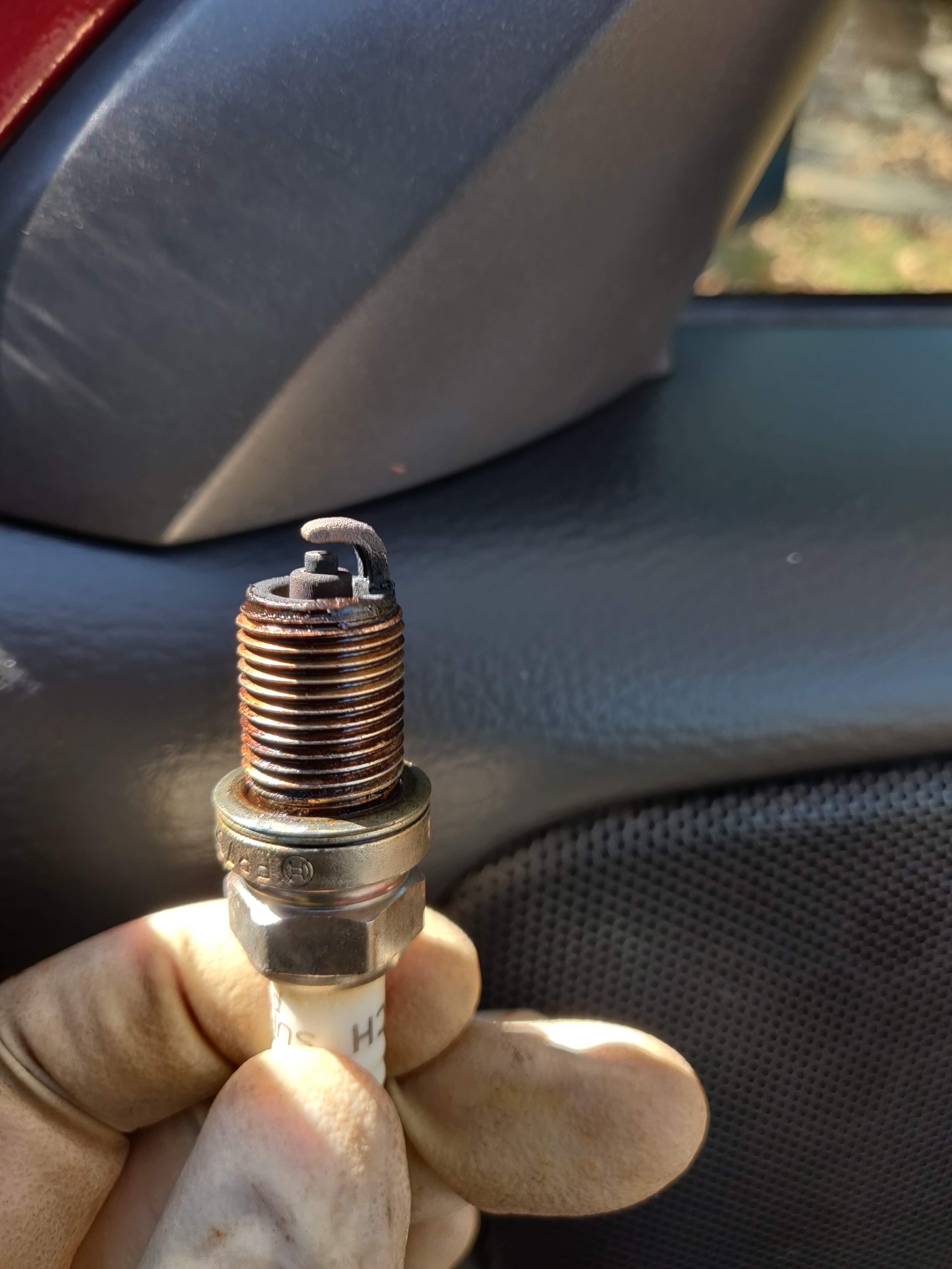

And may be time to replace the spark plugs. Hahaha see pics.
Hmmmm these things are fussy about plugs. Correct?
What kind should I use ? Model number , type?

Yeah I'm very close! Can't get the oil dipstick bolt loose, and the ones from under the manifold.
I did one bolt off the manifold rest bracket. From the bracket to the engine block...that 12 mm bolt. Hope that's correct!
Also replaced the plugs while they were looking right at me! Haha
I used antisieze, the prior tech didn't, and I put in BKR6ES made by NGK . gapped aT .028
$2.99 each!
Have to figure out the torque amount and go grab my torque wrench. Ahhhhhh 18 lb ft or. Hand tighten. And then 1/4 turn
$2.99 each!
