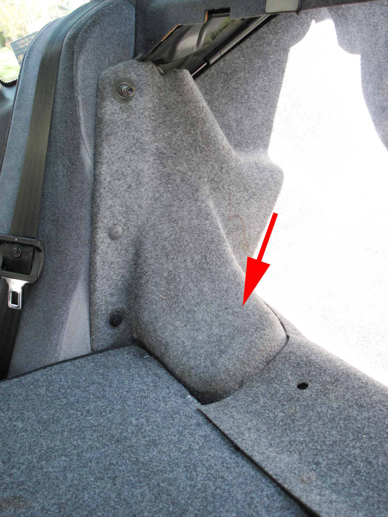

After reading both Front and Rear DIY from cn90 (fountain of thanks), and equally stellar posts of doers, it will take me few months to complete struts and shocks replacement on our 1997-850 Sedan, culminating with 4 tires replacement, and Wheel Alignment before Fall 2012.
Starting from Rear, and would work my way up to Front, reading pertinent posts along the way. Here are few pictures, and related questions to get me started. TIA
...back seat is folded down, looking inside the trunk, I believe, rear shocks are where arrow points, Yes?
...do i remove this nut, it looks special, will i undo more than what is visible?
...this T30 holds, and locks the upper of the backrest. again, looks special type, does it need special tool and technique?
Posts: 8358
Joined: 31 Mar 2010, 09:54
Year and Model: 2004 V70 2.5T
Location: Omaha NE
Been thanked: 504 times
Post by cn90 »
800artfreed wrote:...If your bolt head is above the mounting hole recess, CUT the head of the bolt off using a Dremel tool and cutoff wheel. Now cut a notch in the end exposed bolt shaft. You now have a screw head that can be tightened with a screw driver all the way through the nut and fall out the bottom. This process took about 15 minutes....
Brilliant tip. Thanks for this trick!
