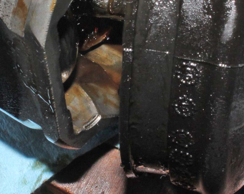

To get the tripod out you have to grind down the staked ridges at the end of the inner joint bucket. I used a Dremel and a small grinding wheel. You might be able to use a small flat file but you need to careful with inner part of the bucket where the rollers slide.xHeart wrote: 23 Mar 2019, 11:47 A follow up:
Passenger side inner CV boot now leaks grease at the clamp. The boot looks fine, but grease looks and feels too thinned. Does the tripod fully comes out - is there a procedure?

- volvo inner cv joint staked end.jpg (82.38 KiB) Viewed 740 times

Thank you!firstv70volvo wrote: 23 Mar 2019, 16:26
This pair of axle was donor from 2007 XC70 with 56,000 miles. The pair is in great condition at 100,000+ miles. The inner boot doesn't show any damage. I'll do a through clean up, refill with GKN grease, and finish with fresh crimp tie.
