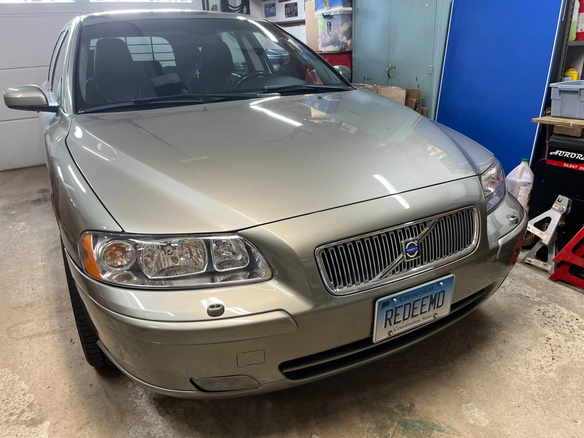

It took quite a while to get the bumper painted, but the body shop finally got me in last week. They agreed that I can deliver the bumper disassembled, which saved a bit of money. It still cost $565, but they did a really nice job. The paint matches the car almost perfectly, only the hood is a little off. The hood is quite faded, which I noticed right away, but returning it was not really an option. I am happy with the overall results though.
This concludes the repair of the accident. It was not cheap, probably around $2200 to $2500, but worth it imho. In a sense, it is better than before with a bunch of new parts, such as radiator, hoses, coolant, AC condenser and more.

That looks great! love that colour.

It might be my favourite colour, adourable.
