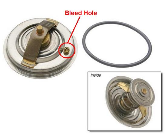

- Posts: 8360
- Joined: 31 Mar 2010, 09:54
- Location: Omaha NE
- Been thanked: 504 times
A hole in the thermostat allows air to bleed out by itself.
The Factory Volvo thermostat was made by Wahler and it has a hole in it.
Some aftermarket tstats have no holes. What brand of tstat did you put it?
Here is a picture of the bleed hole:
