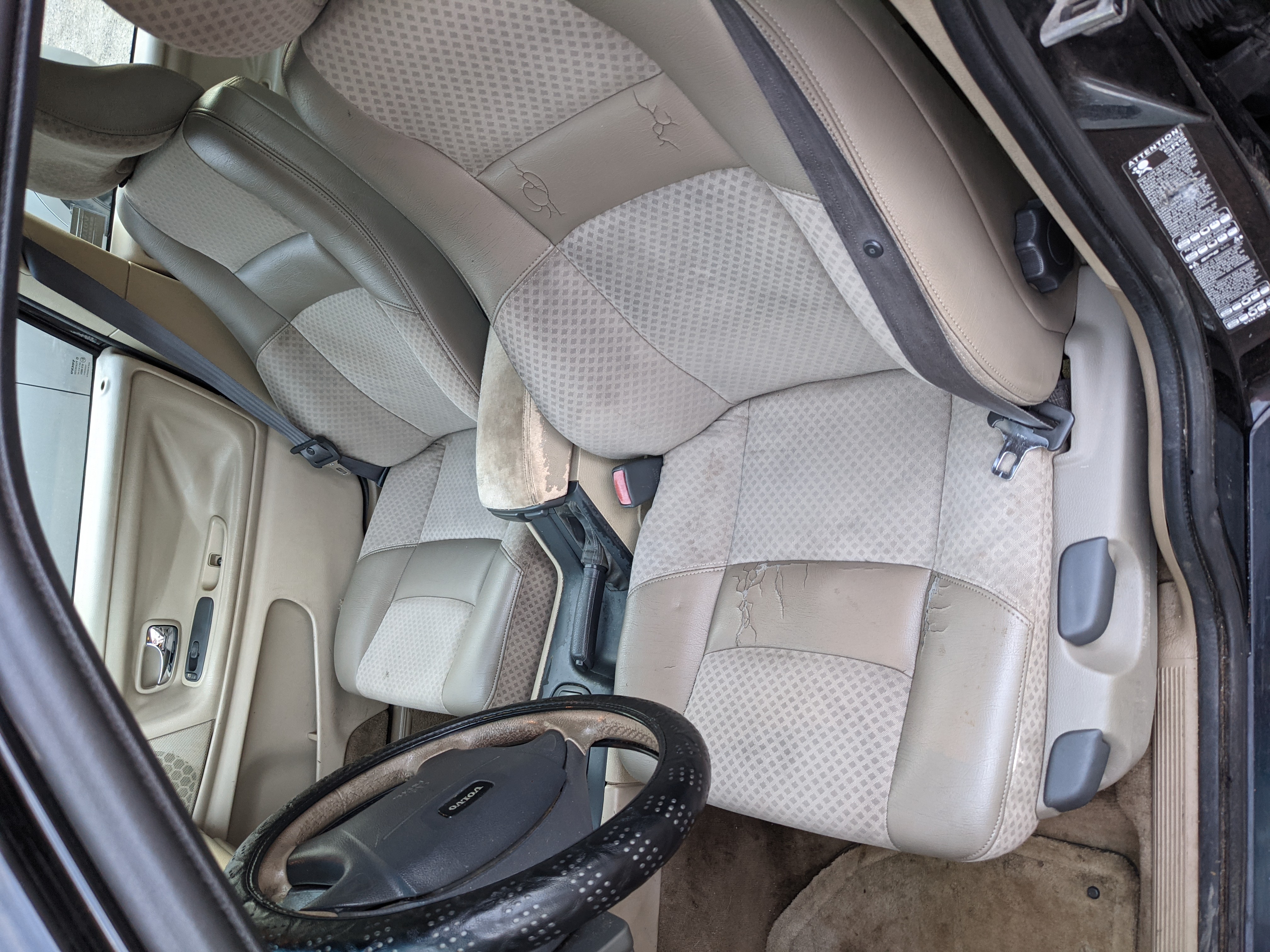

Geronimo got its new (old) seats! The owner loves them, saying they brighten up the car (new are oak, old were beige). Thanks to abscate for pulling them from the V70 I donated.
What can I harvest from the old seats? Driver's adjustment motors and buttons, seat heaters, passenger's seat back? Is it easy to hack off the foam so I can take the metal to the scrap yard?

Pop the springs off amd the foam will fall off. There are five ? Heavy springs at the rear of the seat bottom which cone out with Channelocks and healthy hand pressure ( Caitlin pulled them off by hand, scary) then the bottom foam pivots up from the rear and out.
Pictures linked are in my Elizabeth maintenance thread , in the March 2018 diary, under seat reskin
