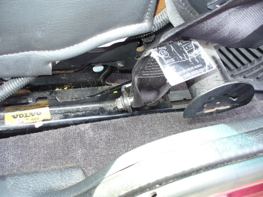

Detach seatbelt and remove the bracket

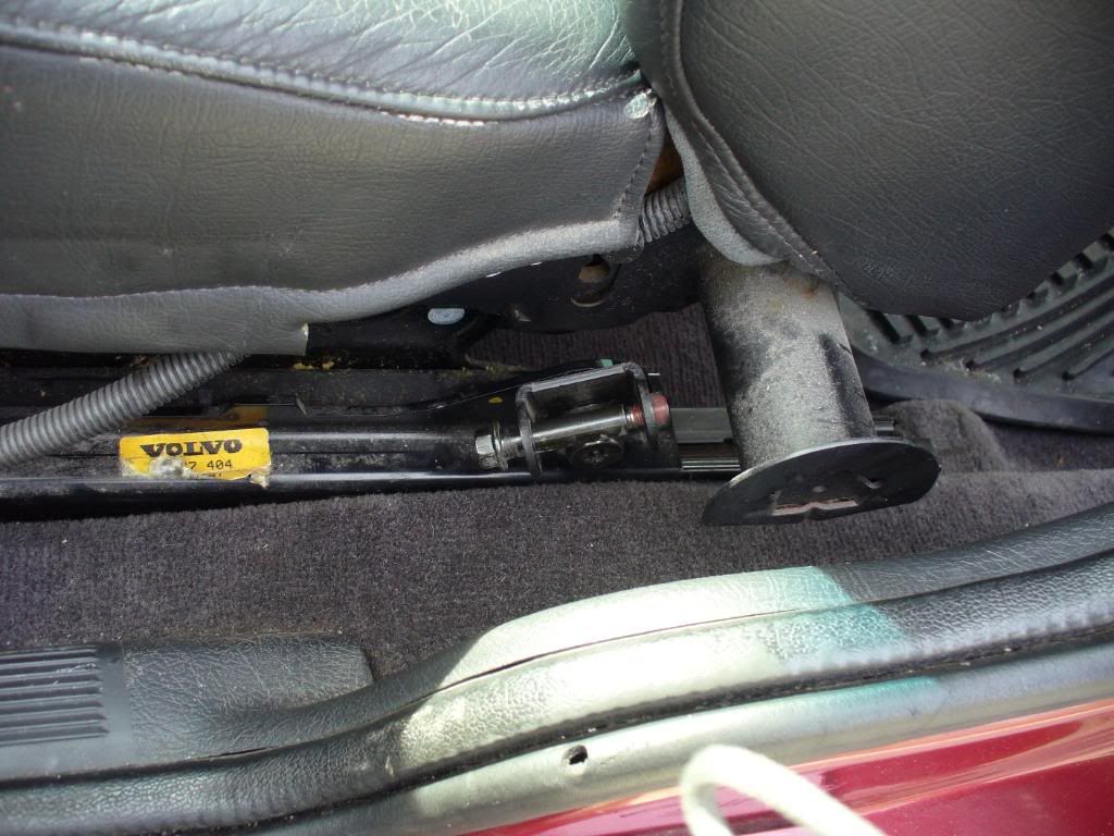

Remove seatbelt bracket from V70 seat
Bolt in 855 seatbelt bracket into V70 seat
Remove V70 seatbelt latch
Remove 855 seatbelt latch and install into V70 seat

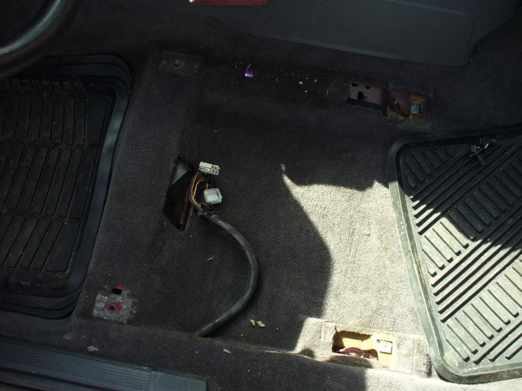

On to the driver side powered seat
Unbolt seat, remove seatbelt, unplug harness and remove from car

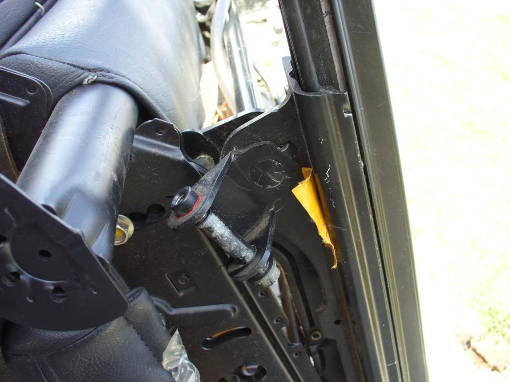

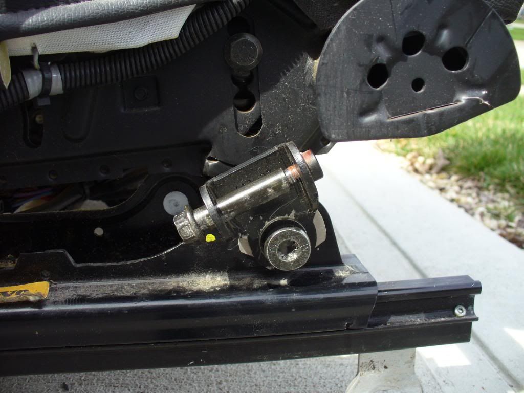

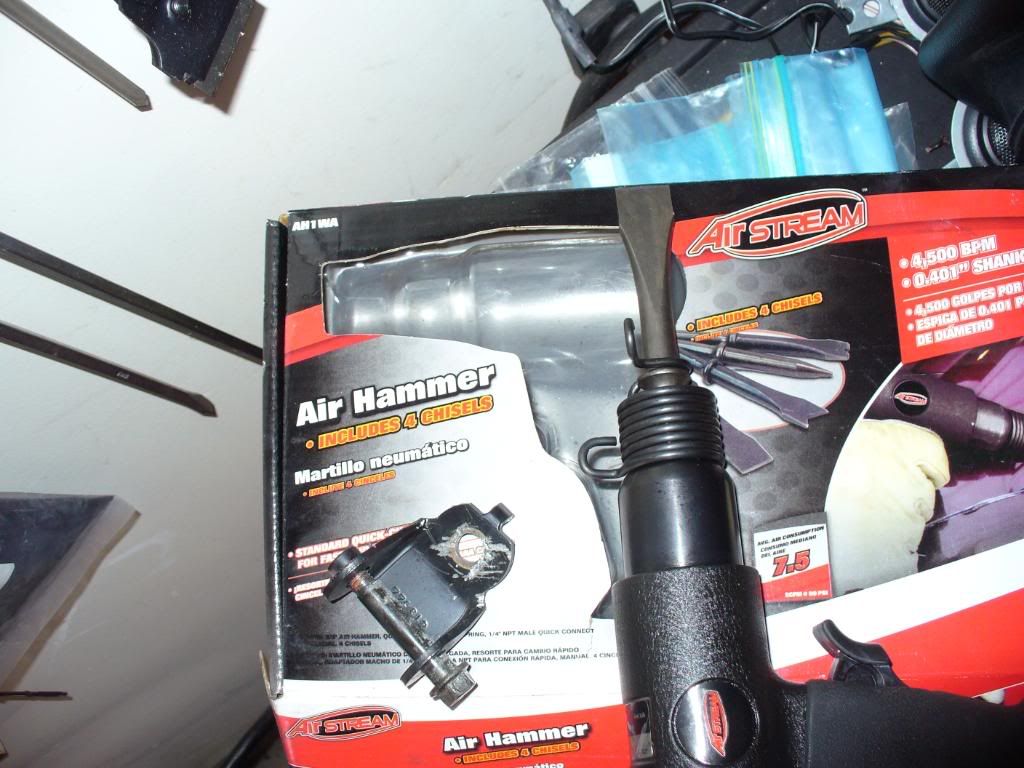

Driver seatbelt bracket is riveted so time to break out the heavy tools!
Used air hammer to chisel the rivet off

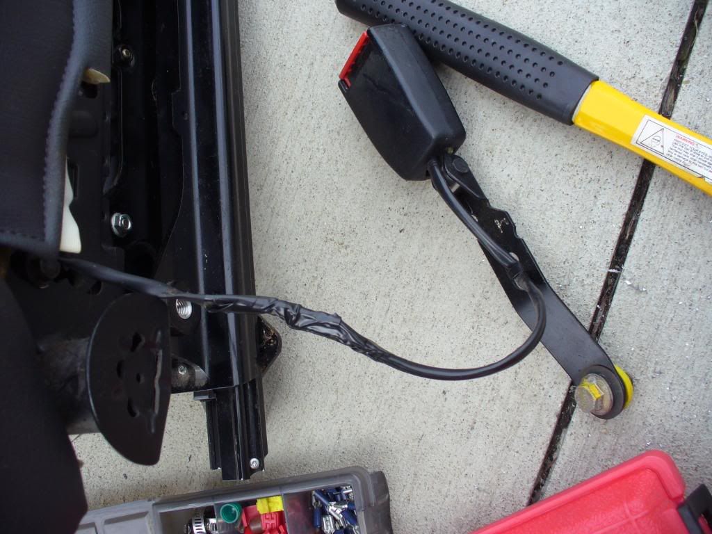

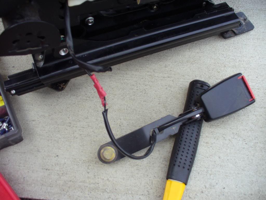

Adapt the 855 seatbelt bracket into the V70 seat, I had to rearrange some washers from V70 seat's original seatbelt bracket to work with the 855 bracket so it'll stay firmly in place.
855 seatbelt latch has wiring harness that I cut and spliced into the V70 seat (for the seatbelt warning light)

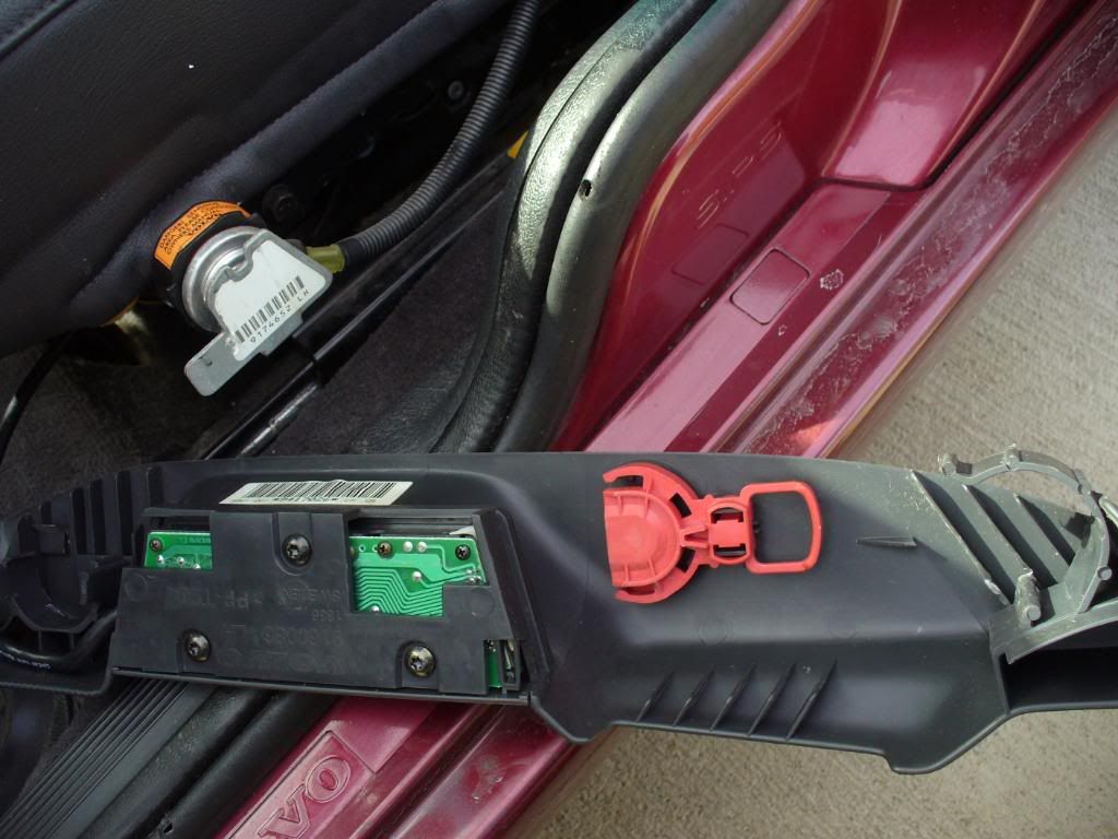

Install prepared V70 driver seat into 855 and plug in control harness (note the airbag lockout tag)
Remove and store the airbag lockout tag

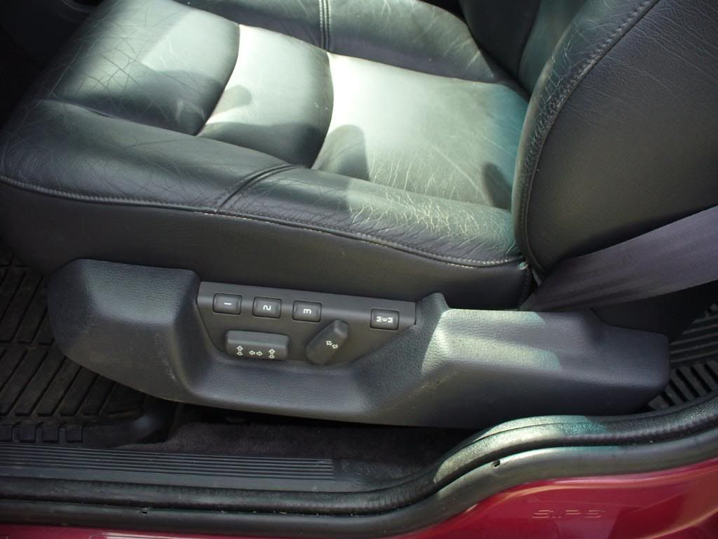

Install seatbelt into bracket and cover
Enjoy fruits of labor

Just a couple quick questions, since the '94s didn't have the side airbags, what did you do with the wiring for the seat's airbag?
Do you know if it is possible to wire the airbags into the sis system?
t5rrr
Posts: 128
Joined: 26 November 2009
Year and Model: 1994 855
Location: Dublin, OH
Post by t5rrr »
To my understanding the side airbags are mechanically actuated, hence the red stopper gizmo to prevent the side airbags from deploying during transportation.
During the swap I did not notice additional wiring or harness that was on the V70 that my 855 did not have.

T5rrr, you are correct. The triggers for the SIPs bags are pyrotechnic and they are triggered by force alone, it is not electrical. Good job on this. The thing that always had me flummoxed from looking at VADIS was the difference in the seat belt mounts and you solved that problem.

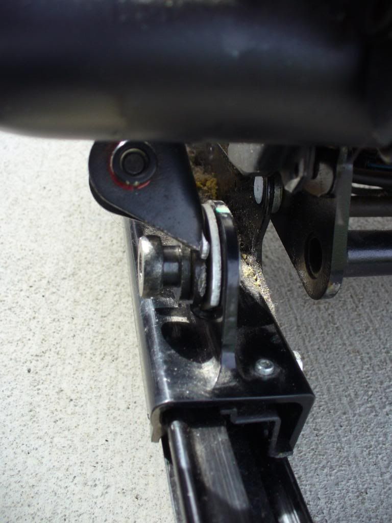

This is a great fix for old seats. One thing I found is that you can swap out the lower part of the attaching seat rail with 4 screws and avoid any drilling for the seat belt swap out. Just be sure that the rails are in the same position on the gear when reinstalling (preferably all the way aft). I was curious why the seat belt coupler needed to be changed from one seat to another. Great info on Airbags.

michaelairllc wrote:This is a great fix for old seats. One thing I found is that you can swap out the lower part of the attaching seat rail with 4 screws and avoid any drilling for the seat belt swap out. Just be sure that the rails are in the same position on the gear when reinstalling (preferably all the way aft). I was curious why the seat belt coupler needed to be changed from one seat to another. Great info on Airbags.
Could you explain that a little more? I have a pair of v70 seats to go in my 855, not sure I see the screws you mention. My 855 seats are not power, is there a difference?
