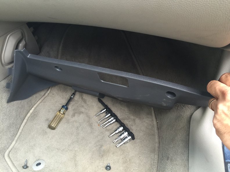

Replaced the cabin filter on the P2 today
  • Two Torx 20 screws to undo the kick panel, then u clips in three places
  • 4 Torx 20’screws to drop the filter cover.
  • I snapped out the plastic block and went with the thick filter over the thin.
