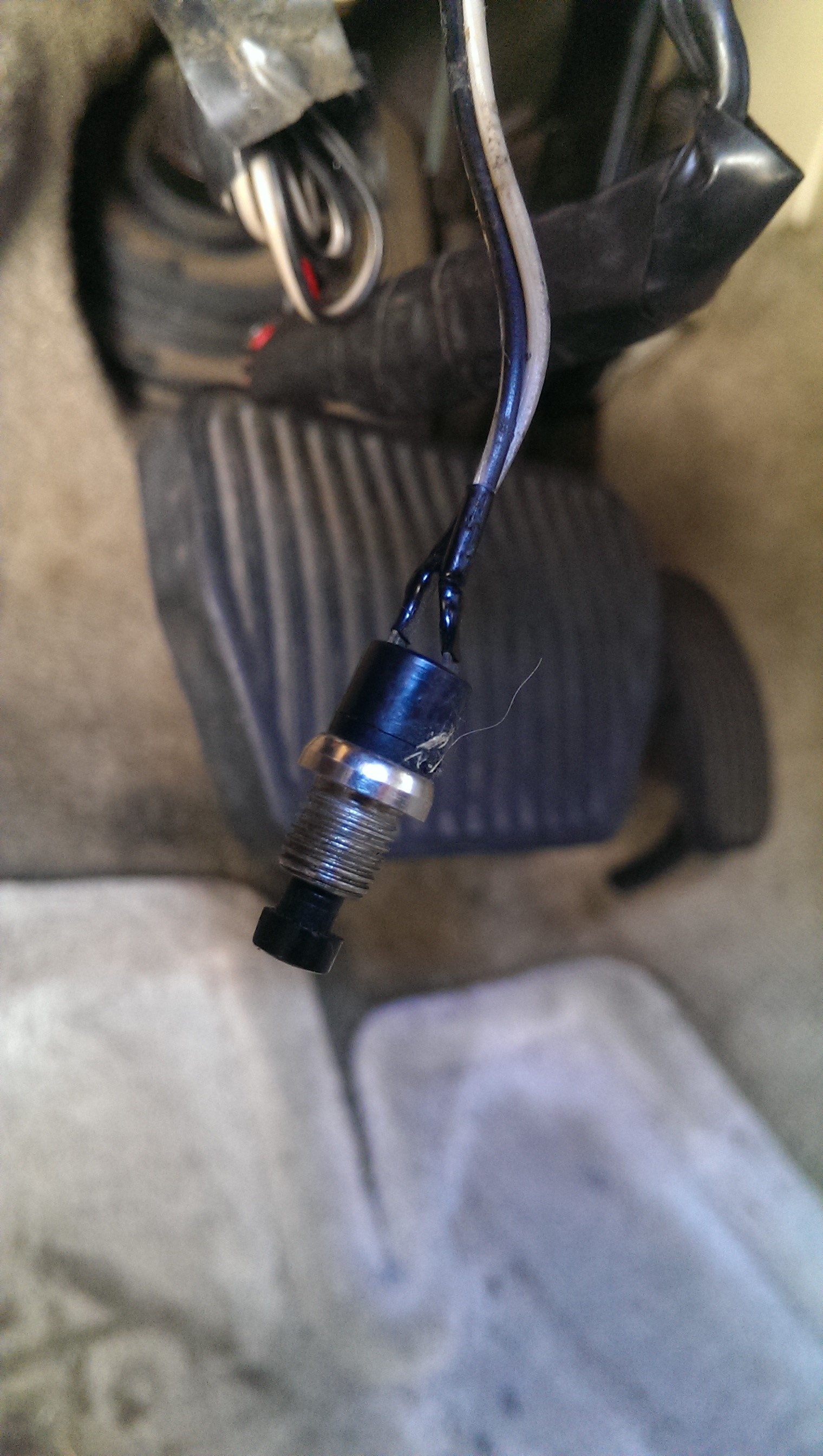

There is a long wire hanging down near the alarm module ( behind steering wheel), with spring like end to it. It has a flat end I can push down on and has a tiny spring back. I can't figure out where that goes...
This dash is from a c70 and the wiring wasn't 100% mirrored.

This looks like some kind of switch,not just a wire.

That's a switch belonging to an alarm system, if I'm not way off the mark. Not a stock one either, so there may have been modifications made to the wiring. Could be a major PITA to track down.
Also, remember that there are certainly unused connectors and stuff back there, so you shouldn't assume that everything goes somewhere. A quick glance at the accessories catalogue for these cars show a myriad of stuff, and I myself struggled like a madman with some wires and a connector in my old T5-R, only to find that it was the wiring for the optional trunk area ventilator fans and switch.
