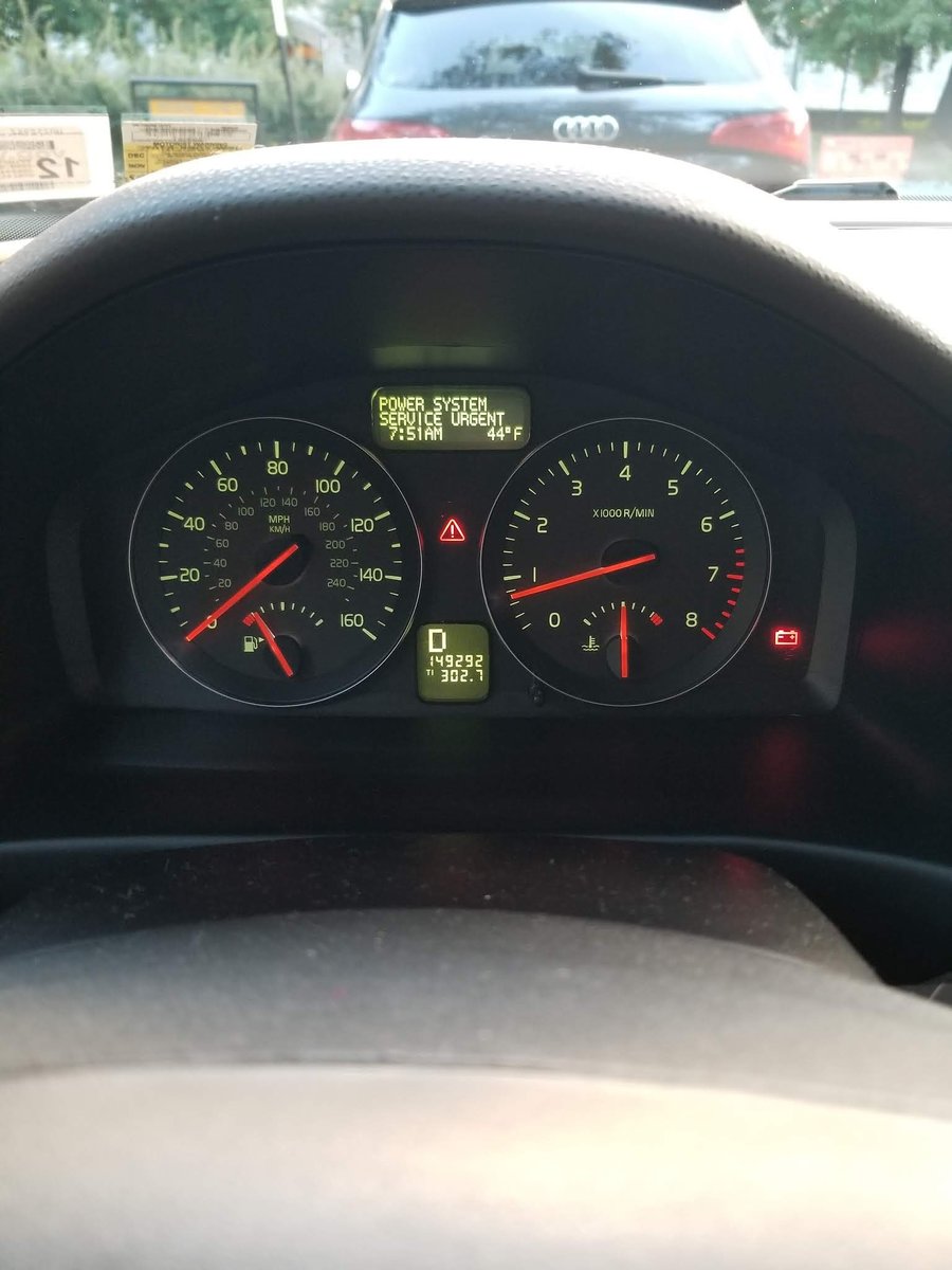

"Power system service urgent"
- RickHaleParker
- Posts: 7196
- Joined: 25 May 2015, 14:30
- Location: Kansas
- Been thanked: 978 times
It is a heads up that something in the Power System is below specs and you maybe heading for trouble that could leave you stranded.
I would start by:
1. Cleaning the battery terminals.
2. Cleaning the wiring to the alternator
3. Check the tension of the serpentine belt.
4. Check the battery voltage after the car has sat all night long and before starting the engine.
5. Check the battery voltage with the engine running.
6. Have the battery bench tested.
7. Have the alternator bench tested.
