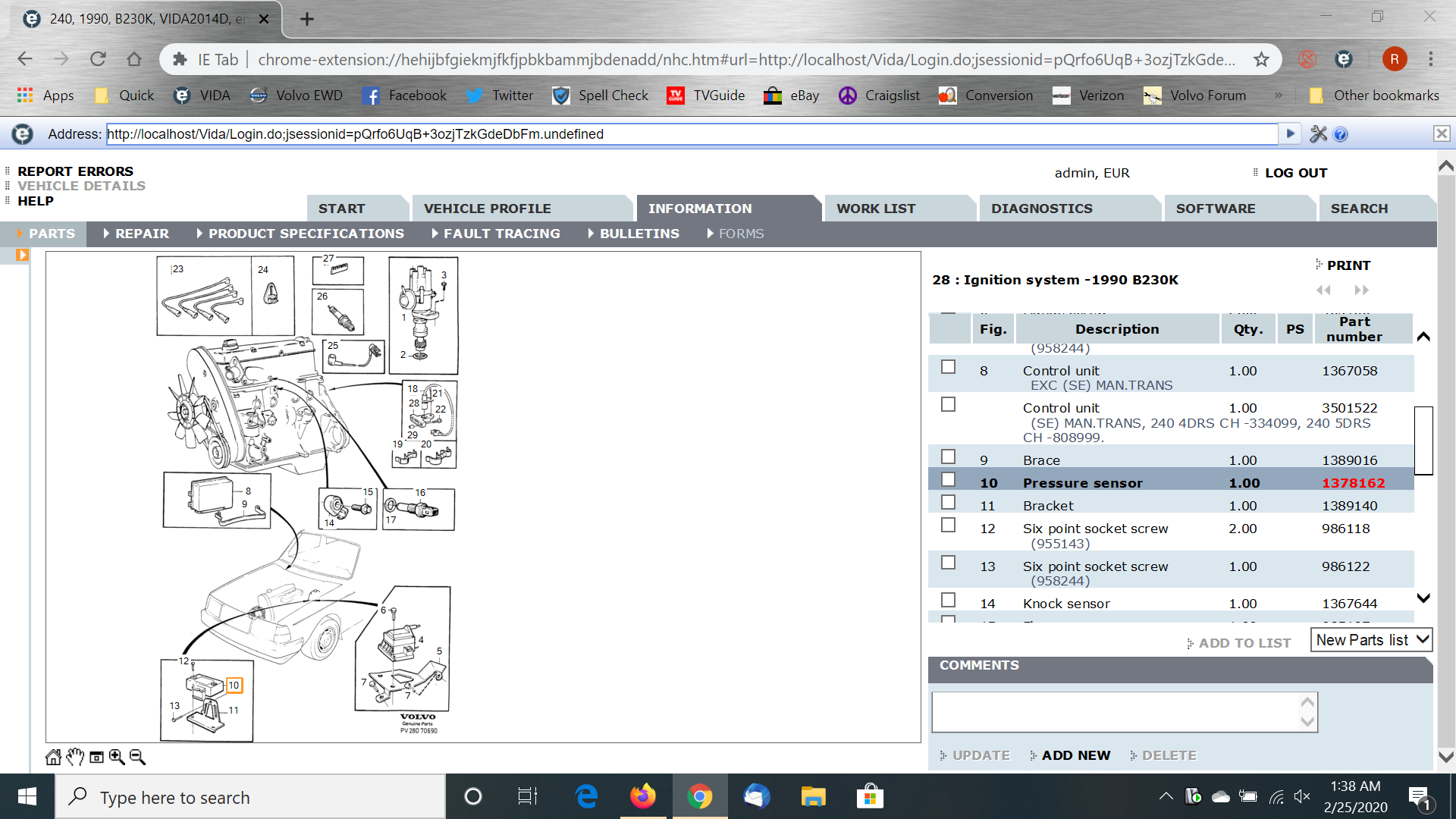

NGK 92477 = Volvo 1378162
On a metal plate near the left fender. Rubber hose running to intake manifold.

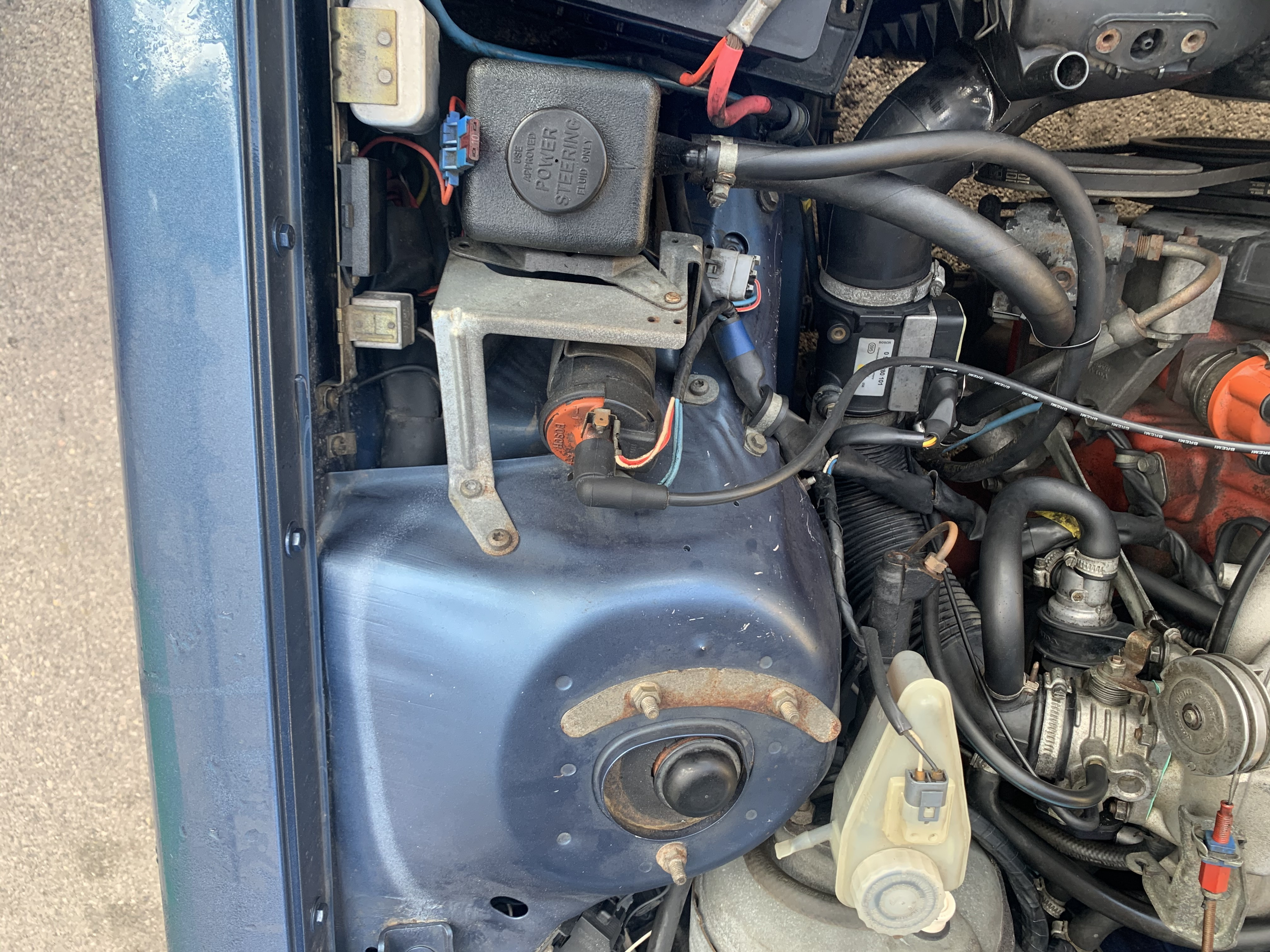

Hi RIck, thanks a lot. I spend almost days looking in that place, but i didt see nothing... its possible the MAP was inside of the wheel way? unnnder the metal? Becouse i count all the rubber house. In the intake manifold only goes two tubes, and goes to the air filter on the front left wheel...
I believe for the acces to the MAP its under the road pass, and i need disassemble wheel arch?
Thanks a lot!
Can i send a photos? thanks
My engine is B230F
Thanks a lot!
My engine is B230F

Looks like it is at same location as the Ignition coil.

Thanks Rick, cant see nothing...i dond understand
in the 1 image, can i see 2 holes...pfff maybe under??
