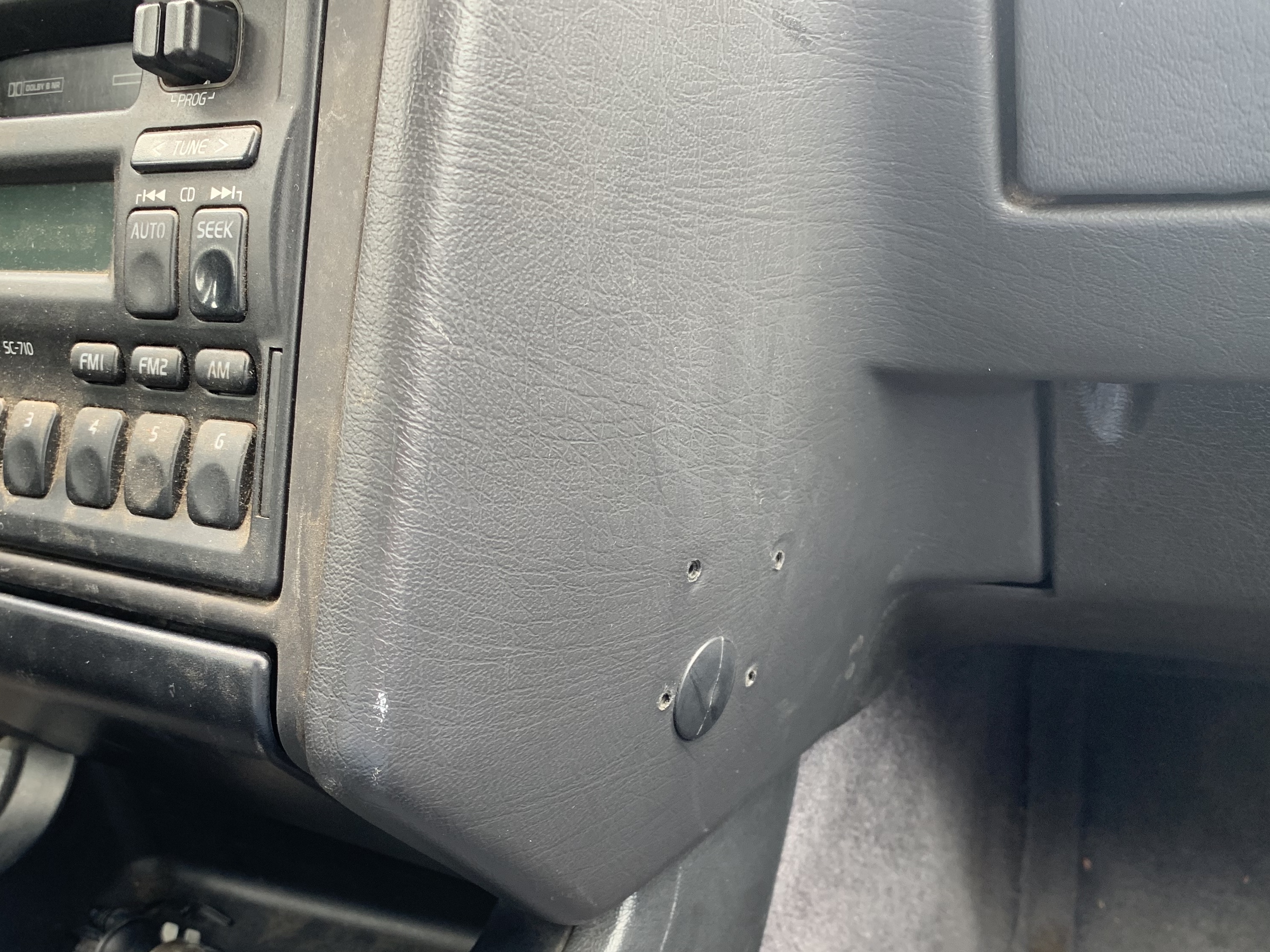

Hey! I'm crackin open the volvo for some blower motor stuff, and noticed what looks like an old mount for something off the side of the radio in the passenger leg area. Any ideas?

Its for a old cell phone handset. That was installed by aftermarket company

There is probably nothing but a hole under that plug.The head unit has an input that gets switched when the phone rings, which mutes the output to the speakers and brings up “phone” on the display. It doesn’t act like an aux in. Some ‘Parrot’ phone interfaces sit in line of the speaker out put and switch between radio out and phone out on a call, that requires an internal amp to drive the car speakers with the ‘line out’ output of the phone. You would see a box in that sits in the speaker plug wires if that was present.

The hole was for the power and antenna wire. It was a aftermarket carphone so popular in the 90s. The wire likely ran to the top center of the rear window. June
