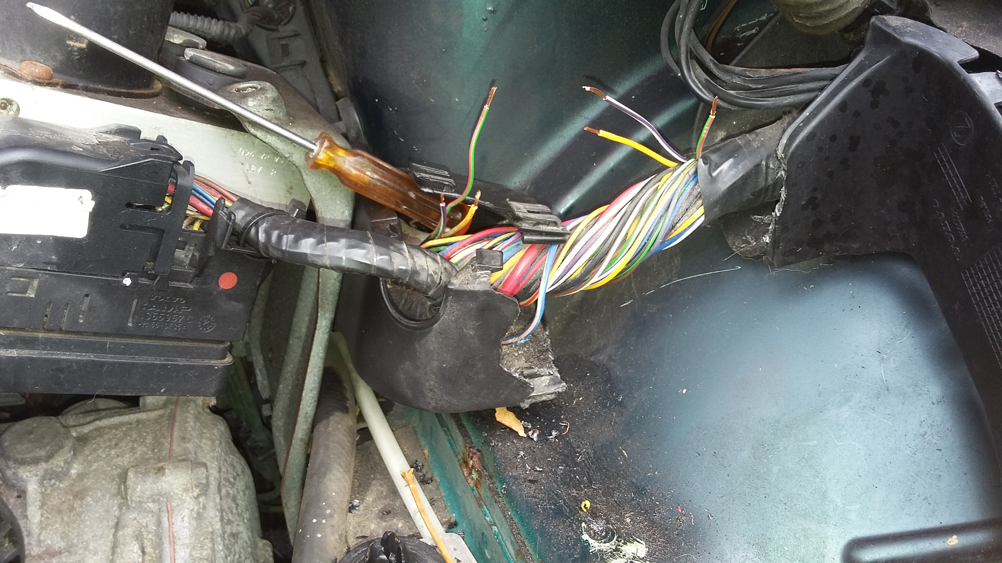

Hi everyone.
I need help removing the fuse box under the hood.
Mice or Chipmunks got to the wiring, not enough room to repair it with the fuse box there. ..
Does Anyone know how... I removed the under hood fuse box...????
Thank you Jay

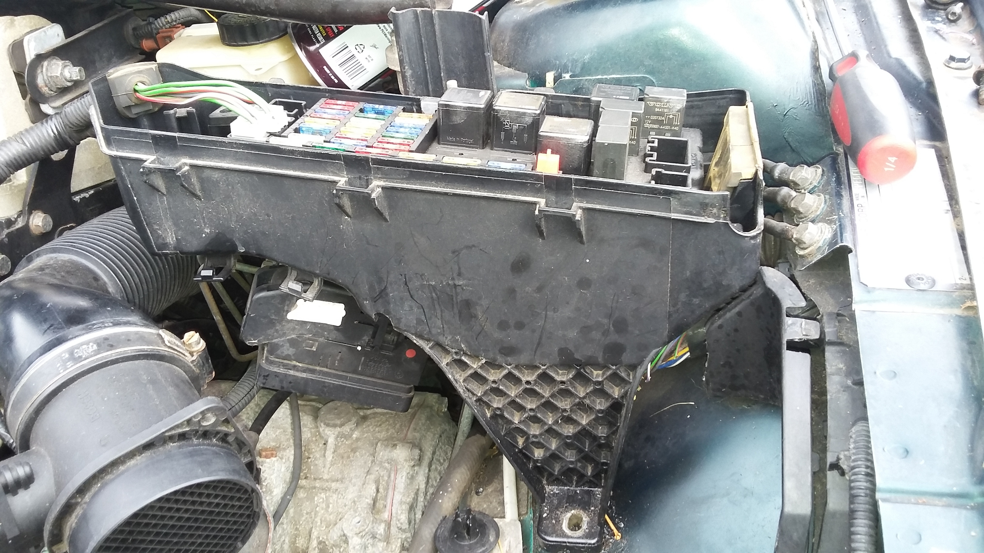

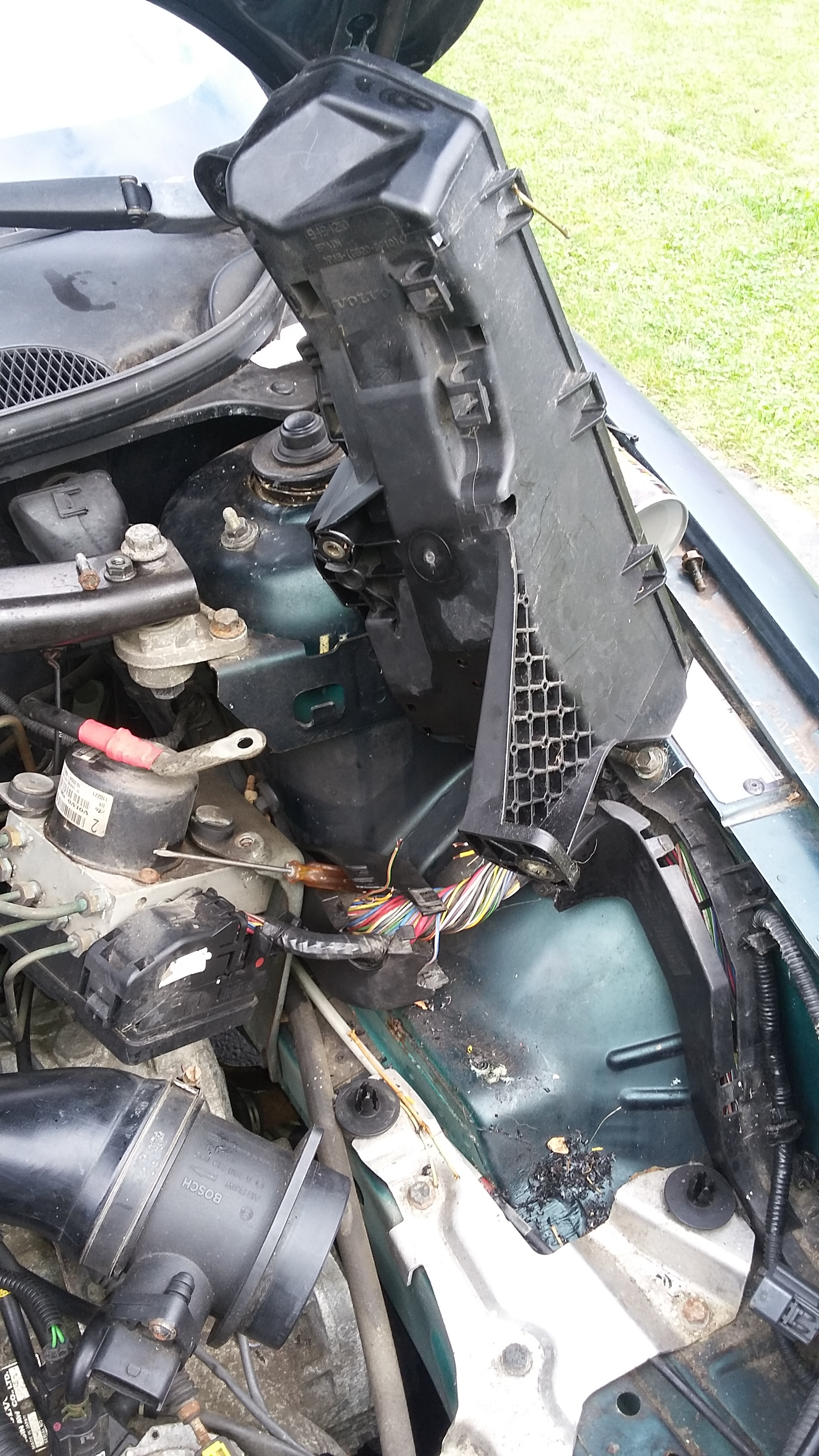

Negative cable disconnected at battery, important
M8/ 14 mm hex remove two positive battery cables
M6 10mm hex bolts
One in front you already have out
Second one deep set into housing.

I got it... I believe this is why im getting the transmission faults/codes. There was so much gunk filling the hole under the positive cables I didn't see that bolt.
Yesterday she ran fine.
I'll let you know later...

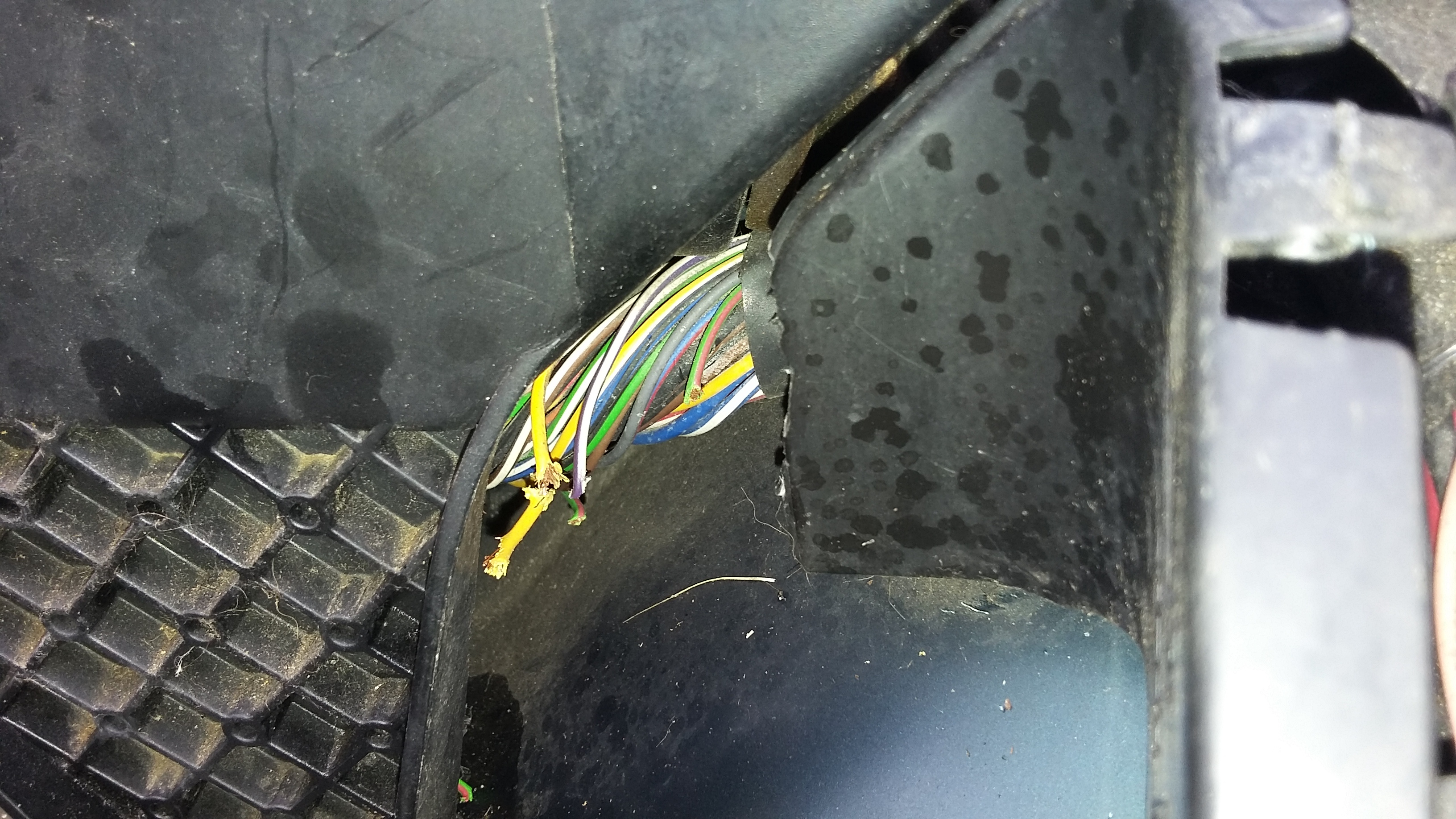

Ok emergency is over!
Problem fixed she stopped that transmission buzzing and shifts again. Damn mice or Chipmunks.
They got 3 wires, They didn't just chew though them They took some home!
Oh well wanna be silly and live in the country .
I do have rodent repellent spray I've gone through almost 32 oz since the start of summer when I seen a chipmunk drop down from under the car...
I'm glad it was that and not the VB solenoids.
