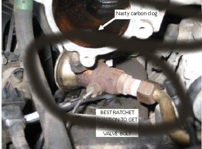

If it has this (the EGR), which is circled in the picture, then it does- if not, then it doesn't.

If you have an EGR, as depicted in the pic submitted by MIJ, I would be interested to know if you can attach the EGR to the manifold first and then attach the manifold to the block.You say the PCV has to be done any way, if you can get the manifold off with the EGR on, the opposite should apply. If it works, you could then torgue the bolts correctly.....gut en tight = snap, in my case.
The great big(brass) nut on the back of the EGR would have to be removed first and then the manifold bolts, the theory is to pivot the bottom of the manifold upwards and then remove the entire manifold and EGR together.
The bolts holding the EGR are just awful to get to and then you also have the problem of overenthusiastic tightening to contend with ! I know, I snapped one right off, if there was jail time for each foul word I used, I would still be in lock up
Tell us how you go!
