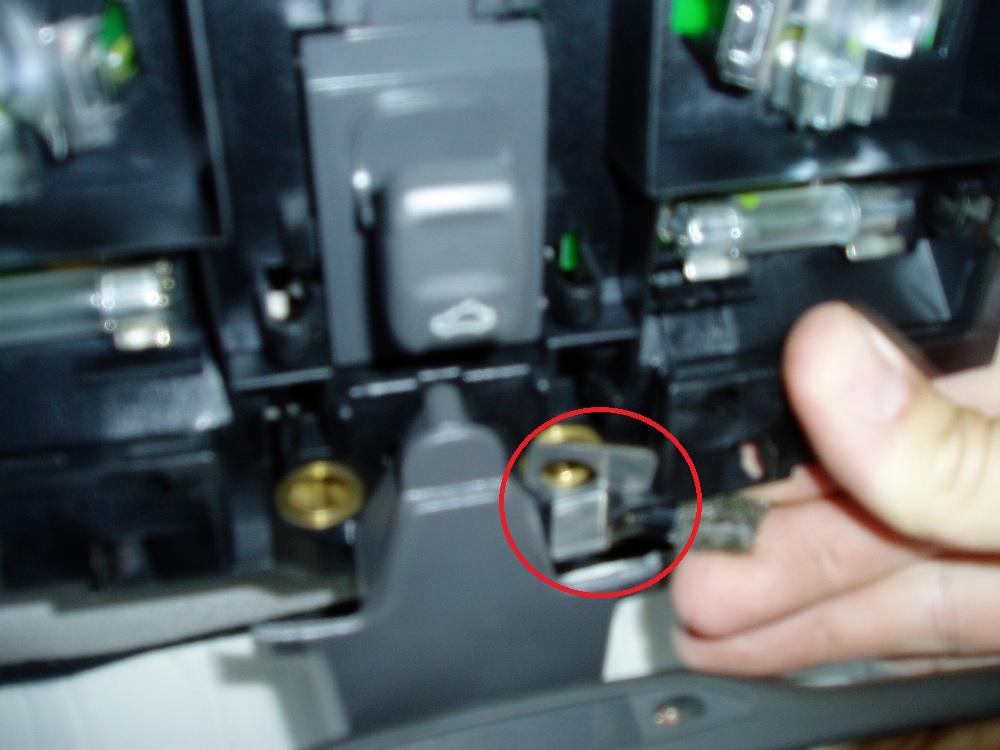

I don't know? Where would it be located? This is driving me crazy.

This one:

Post by jeffdowns »
under the hood where the fuses are? The car is new to me.

Post by vegasjetskier »
No, the one in the picture is in the headliner by the sunroof switch.

Post by jeffdowns »
I dropped the panel that has the lights in it. It took two 10MM bolts and it dropped out. I disconnected two wiring harnesses so that I could remove the panel further. I looked up inside that now open area but didn't see anything like that. Do I have to take more of the headliner out?
Nope, the ground connector is under one of those 10mm bolts. Maybe you don't have one on your car. Do you have the autodimming rearview mirror?

Post by jeffdowns »
I don't have an auto dimming mirror. I did find the ground and it was tight. So, I am going to look for a hex bolt so that I might be able to manually retract it to the closed position.
