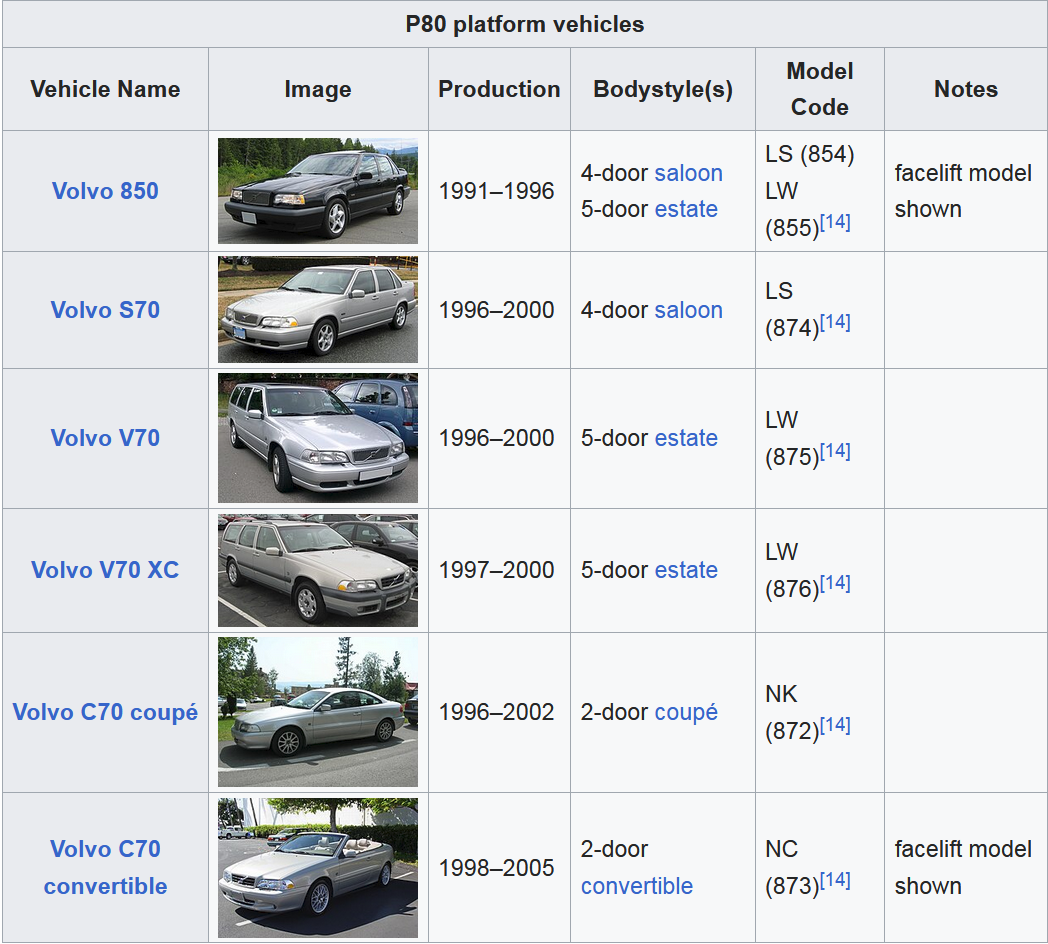

I think the 00 C70 T5 are P80 chassis. If so... On my 1998 S70 T5 the mount completely collapsed so I had jack it up in order to remove the 2 side engine bolts before getting the sub-frame bolts.
