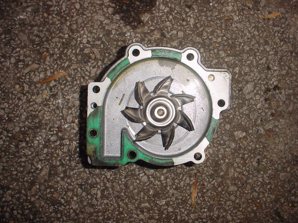

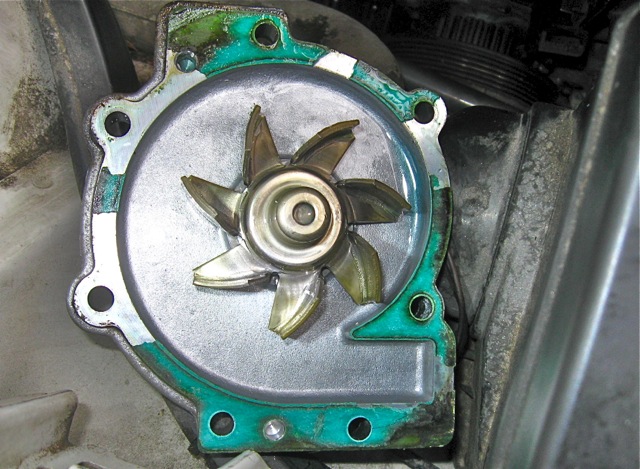

Everybody's experience will be different but for what it's worth, I waited until 185k miles to replace the original water pump on my '97 855 GLT. It was working fine at the time, with no leaks visible. The inside looked fine when I removed it.

Mine was a bit scarier at about the same mileage. I think this one came out of my '94 at, after correcting the odometer, had somewhere around 170 k on it.
That one had no leaks whatsoever.
I am a bit sensitive on the water pumps since I had one fail and take the timing belt with it on my wife's car. Fortunately that engine was a full clearance engine and it didn't take out the valve train. On a Volvo it is a disaster if the pump locks up. My experience with timing belts is that they rarely fail on their own, even beyond the prescribed change interval. It is usually something else that causes the belt to fail like a bad roller, water pump, or a bad tensioner.
