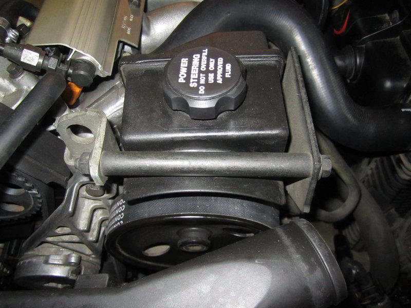

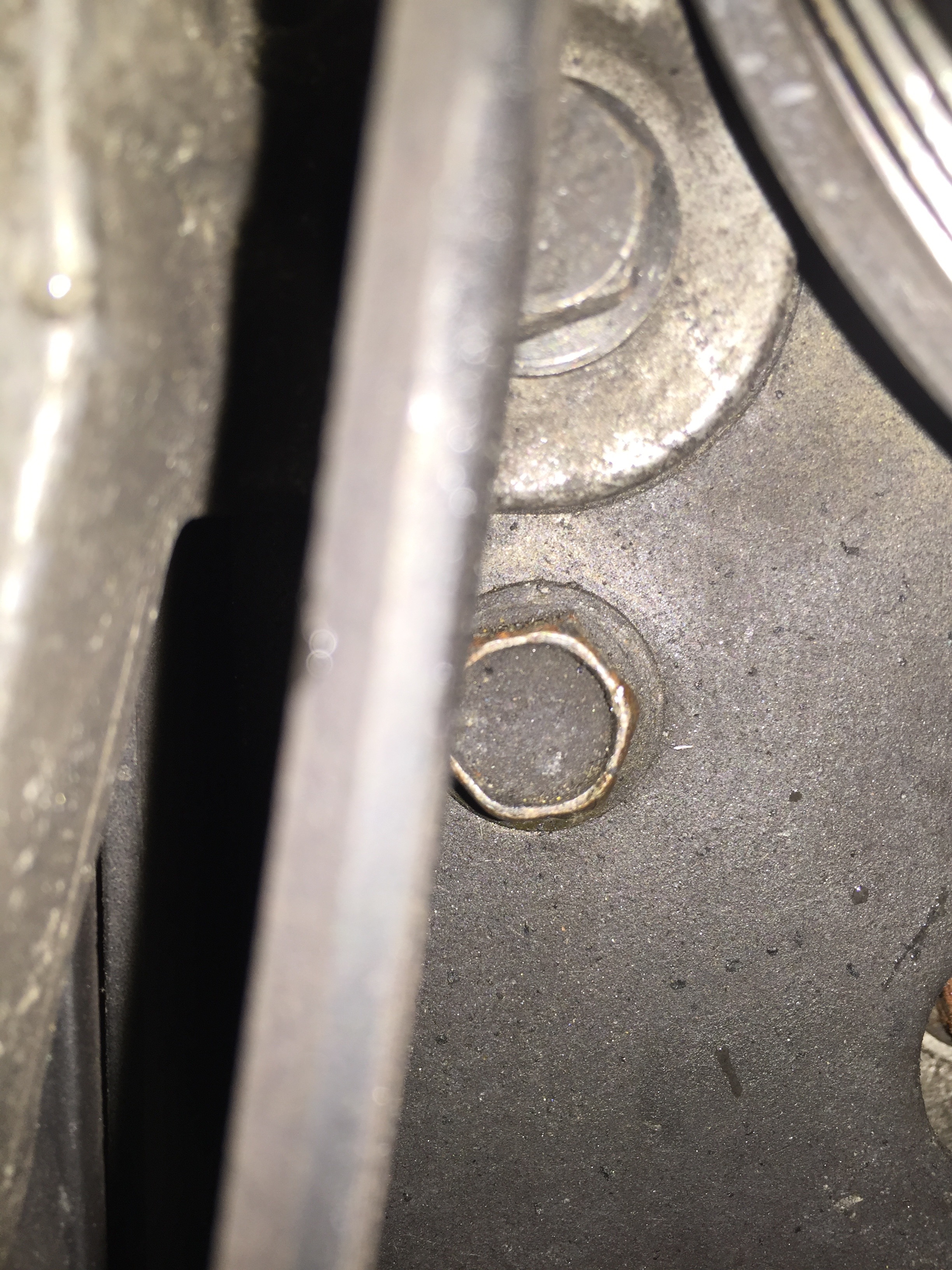

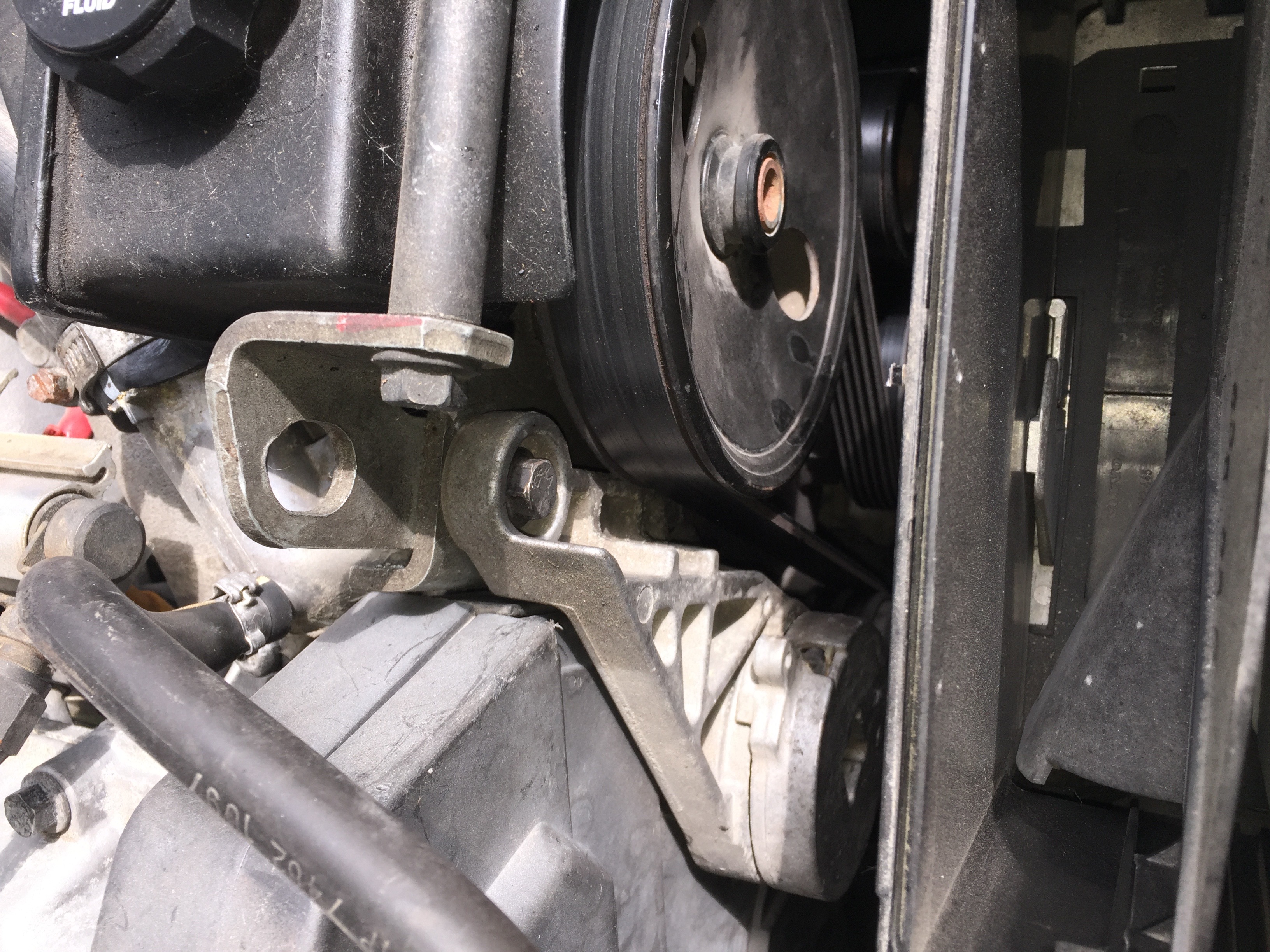

I just looked at my 98 NA and a 97 (they are of course the same), the lower hole is a bit behind the belt path but not behind the pulley per se.
- Posts: 15486
- Has thanked: 2199 times

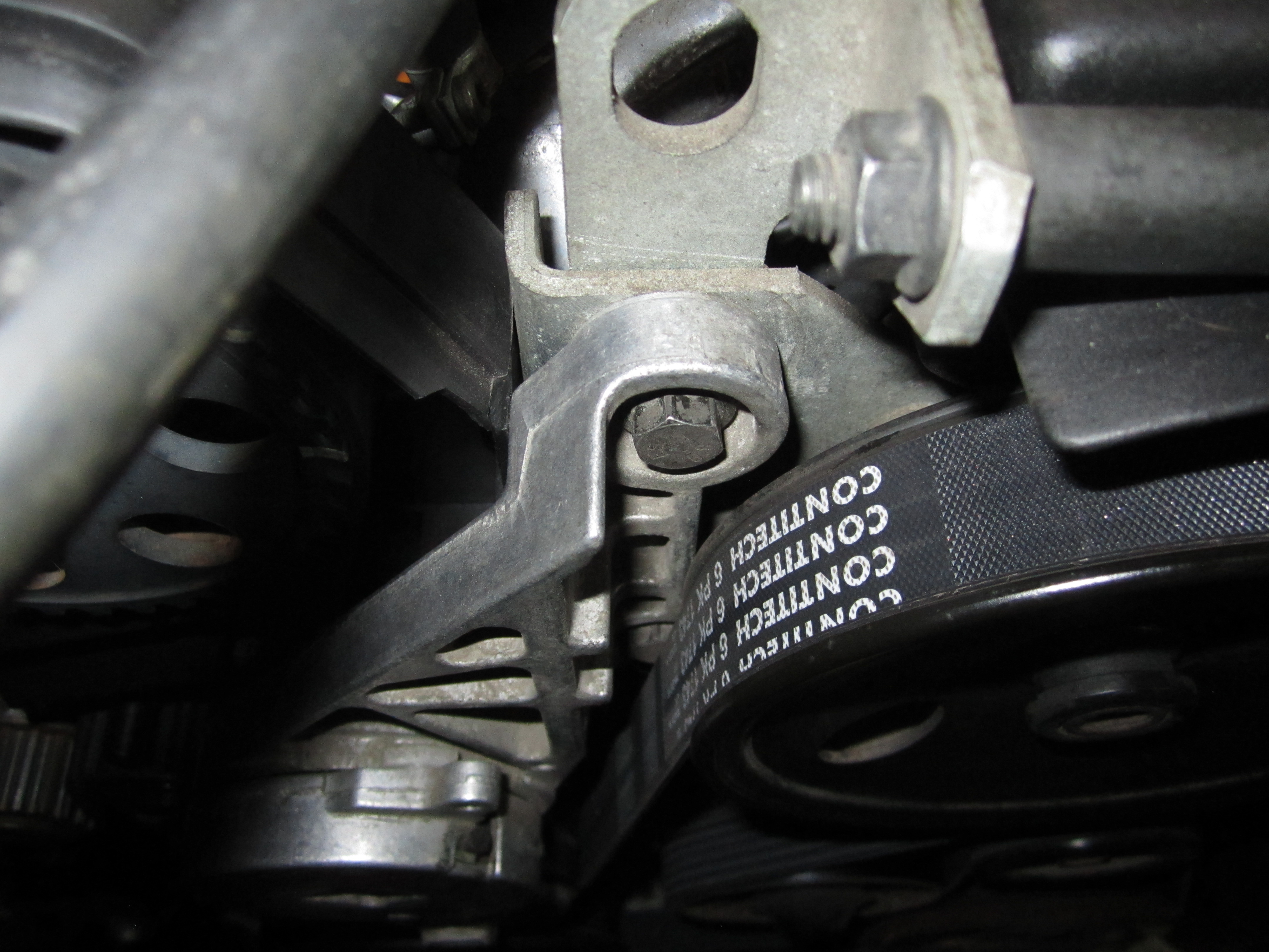

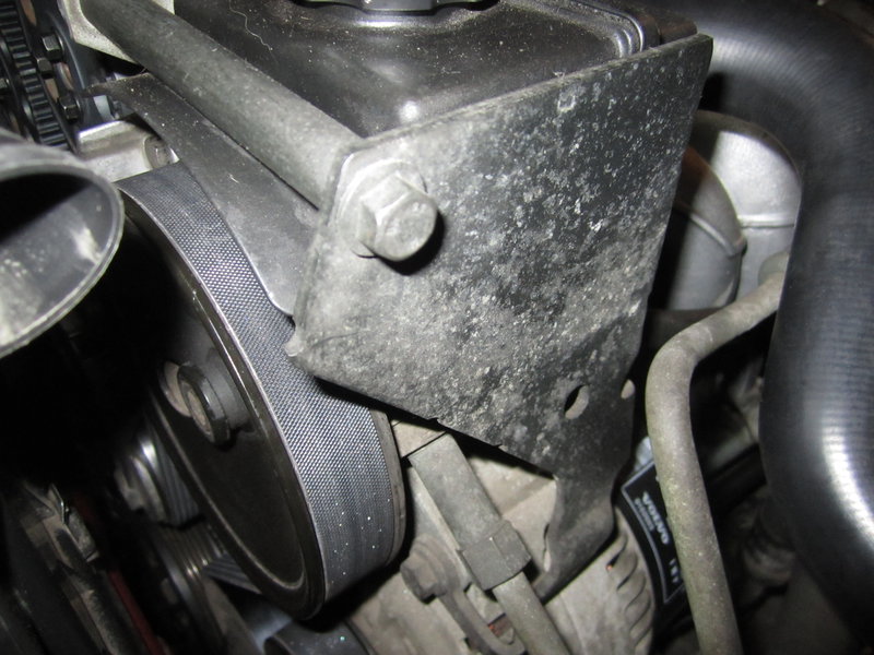

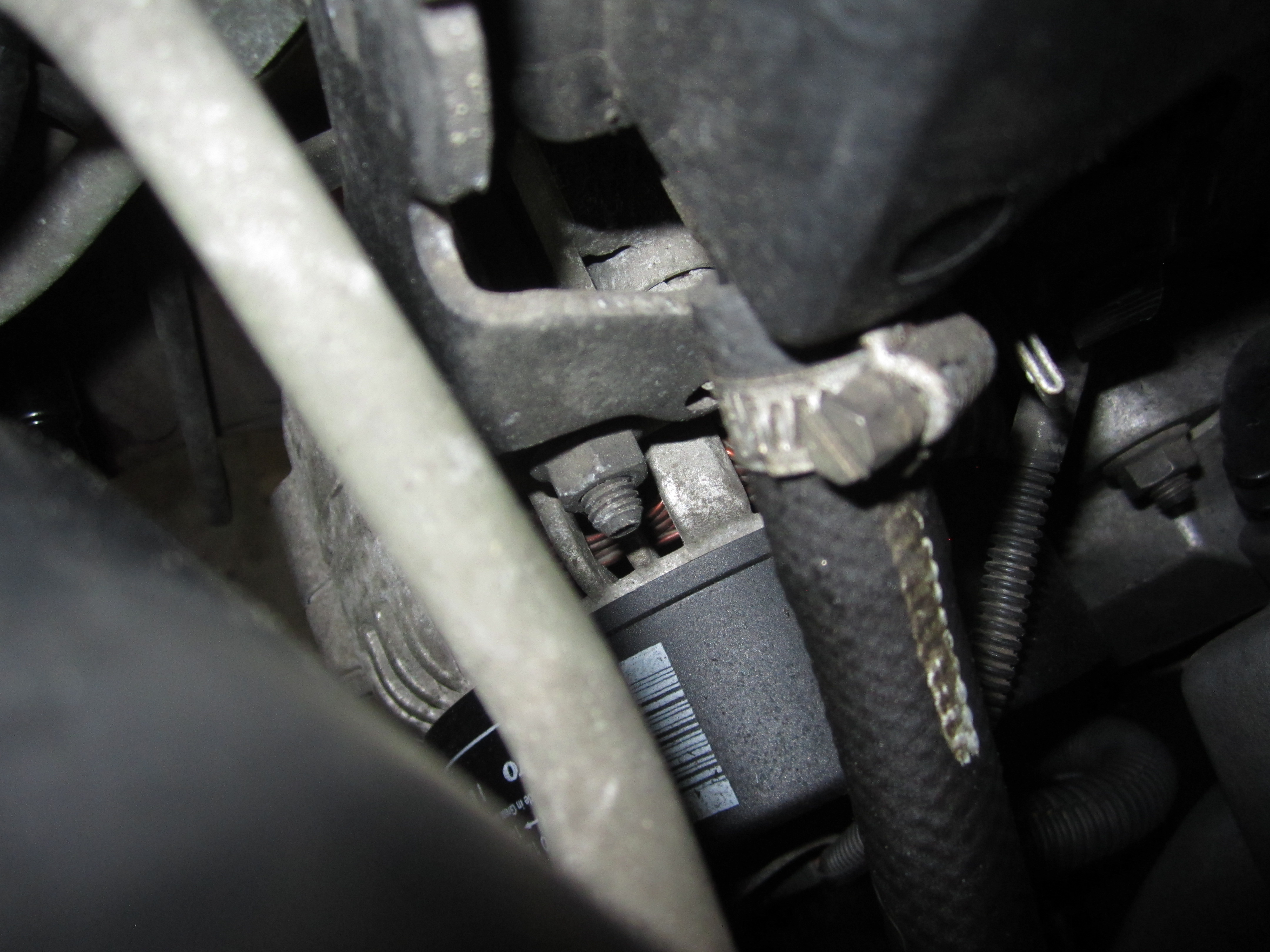

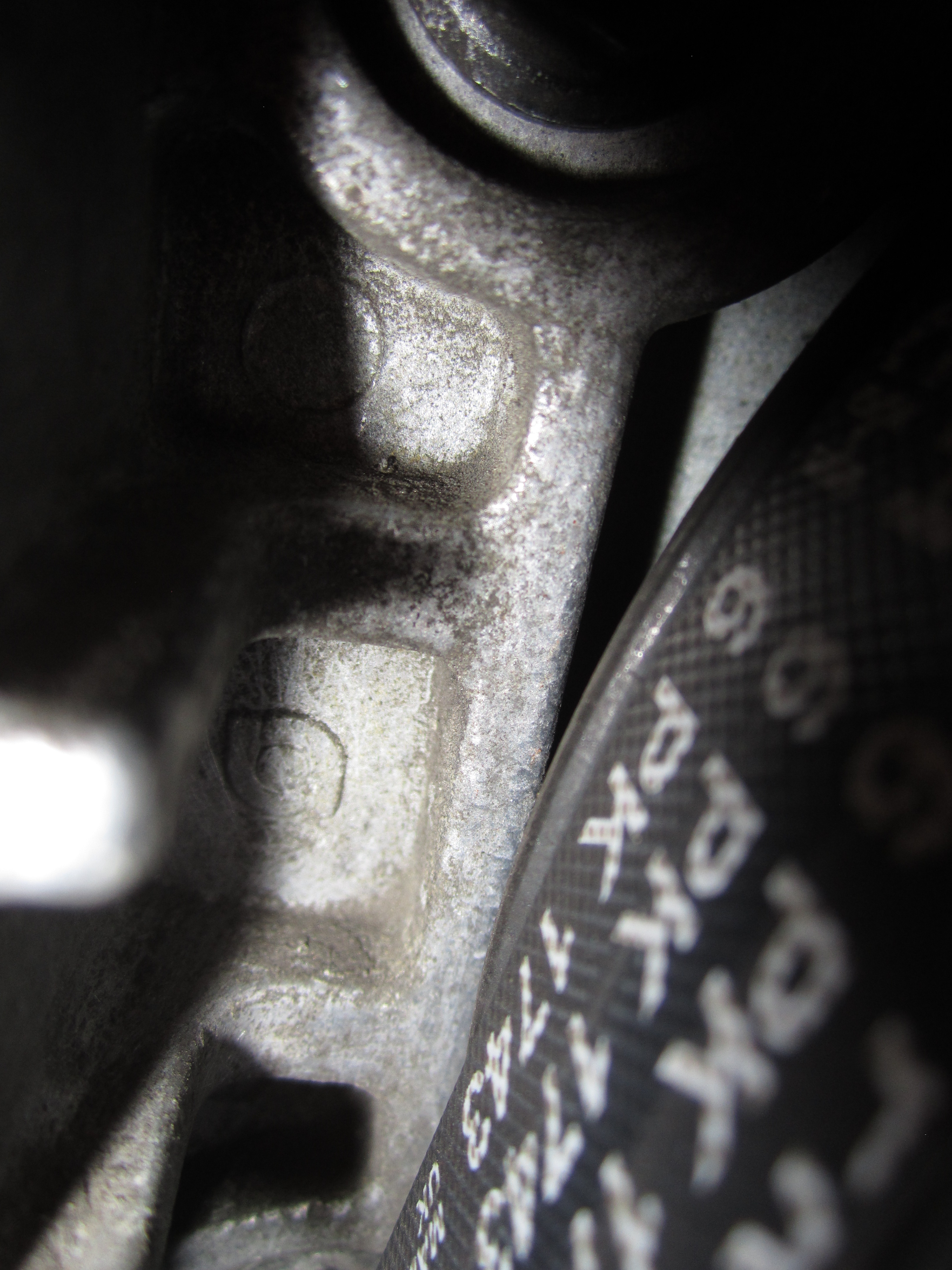

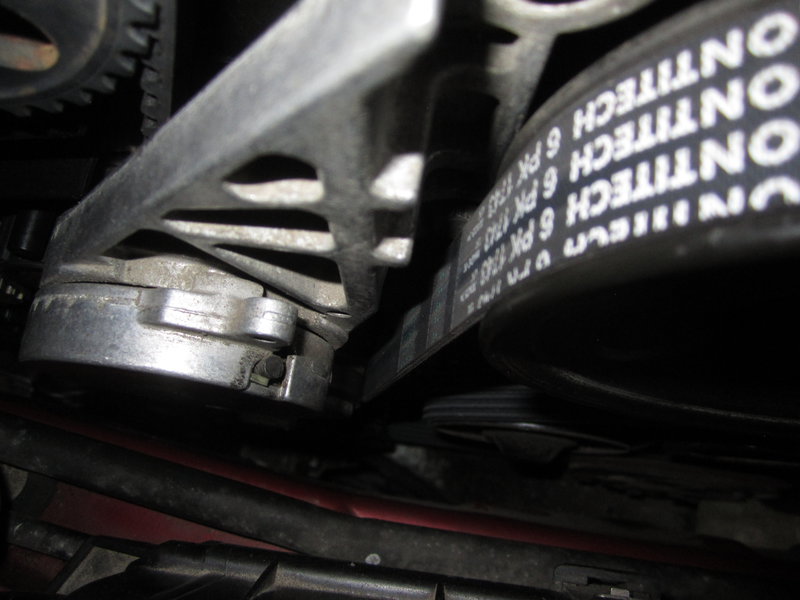

Hah, you beat me to it! Had to run a couple of Volvo related errands first, but I'll add a couple of other photos in case they help:
Not sure if they help with the pump and the belt tensioner. Last photo is not great, but tried to show lower bolt position in relation to the belt, but my camera is not as slim as eriks so couldn't get it to focus. Lower bolt head is just visible at bottom of photo.
- Posts: 36145
Wow, when the moved that ps reservoir over to the coolant reservoir in 1999 they really cleaned up a lot of hardware!
