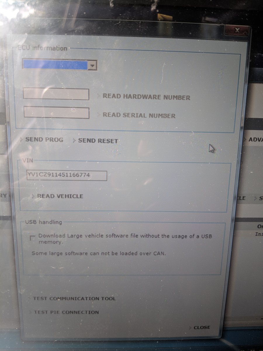

Compare the markings on both CEMs. It might be same software different data. As Precopster pointed out, you can read the software versions with VIDA.

Precopster I'll check and see... Everything seems to work as far as Vida communication. There were some communication errors between modules BCM to CEM , CEM to ECU( that went away) the ECU doesn't show any errors anymore.

The abs light goes away once the new CEM is installed, but start functionality goes with it lol.... I know any jacked up signals on the canbus can cause a no start... Has anyone seen doublebug our Yagger???? 🤕

@precopster yes the software versions show up...

I have spark but no injector pulse...fuel Pressure is at 60 while turning over, but only cranks when starting fluid is sprayed in it...
Posts: 35272
Has thanked: 1497 times
Been thanked: 3810 times
Check for 12 Volts at each fuel injector. If that is present, you have an immobilizer fault
