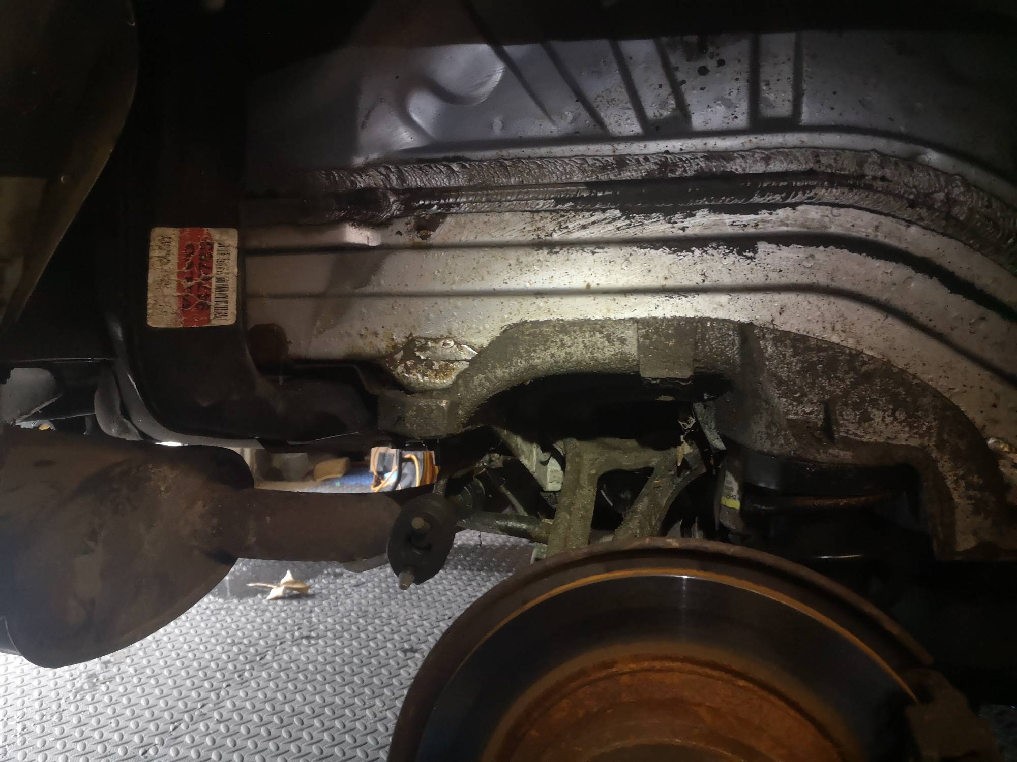

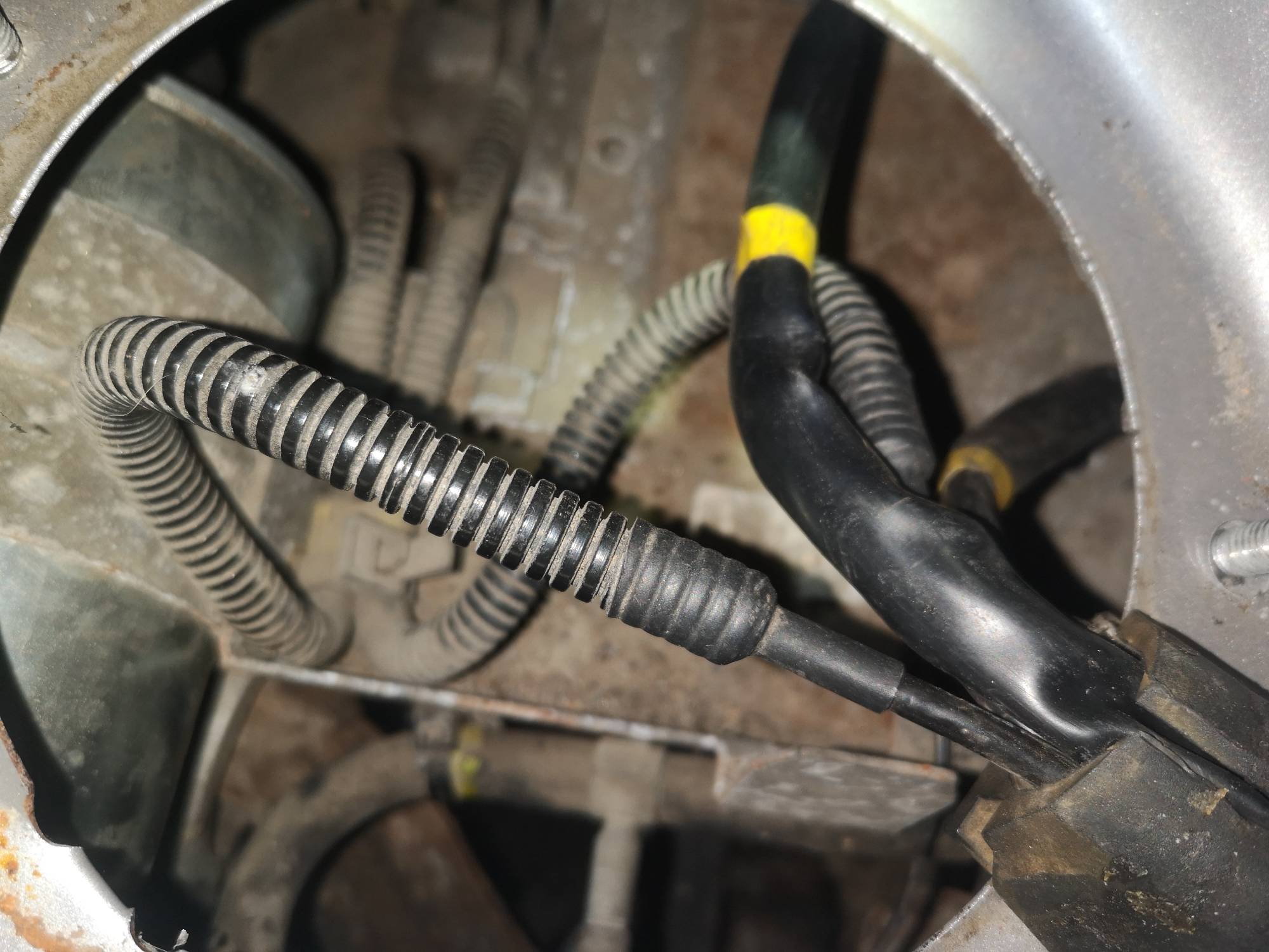

Ok so if I drill a hole into my tank cap, i'll receive a check engine light ?
I'm just in front of my car. Wheel off, wheel liner off, there is nothing I can access to.
My system seems a little bit different. There is no air filter, the air hose is coming directly to the fuel filling hose.
Under the plastic case there is nothing appart these 2 hoses.
So i'm wondering how can I unclogg this venting valve without falling appart the entire gas tank......
Edit: it appears that I don't have any canister at the place it is supposed to be:
Picture taken above the filter, in the trap inside the trunk.
Now i'm just lost lol.
