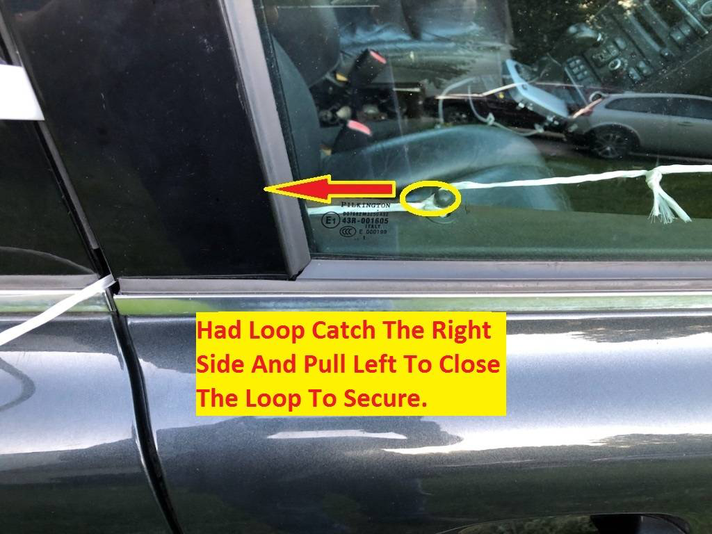

1) Used the thick blue bone tool at the upper left edge and then inserted two other white Volvo bone tools further down the door.
2) Gap was quite small and string would not come down from the left upper edge. Decided (Son) to thread the string in the bone tool hole and shoved it into the car with both ends still on the outside.
https://www.fcpeuro.com/products/volvo- … 90-9814071
3) The first attempt failed as the BLISS wouldn’t allow the string to come all the way down so as we pull to close the loop it came off at the very end. We centered the loop as we pulled.
4) On the second try Son got the loop to catch on the right side and pulled left to close the loop and it stayed on till the loop closed tight.
5) We did remove the blue bone tool to the Bliss end and wedge it into the door frame to provide the string with a little more gap to move up down in and out so not to the damage the seal.
