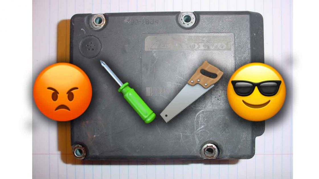

Matty Moo » I see the topic being beaten to death on the forum, and get about 20 emails a week with people wanting me to explain it to them, so I put all the resources in one spot.

ABS Module — everything you want to know for Volvo
