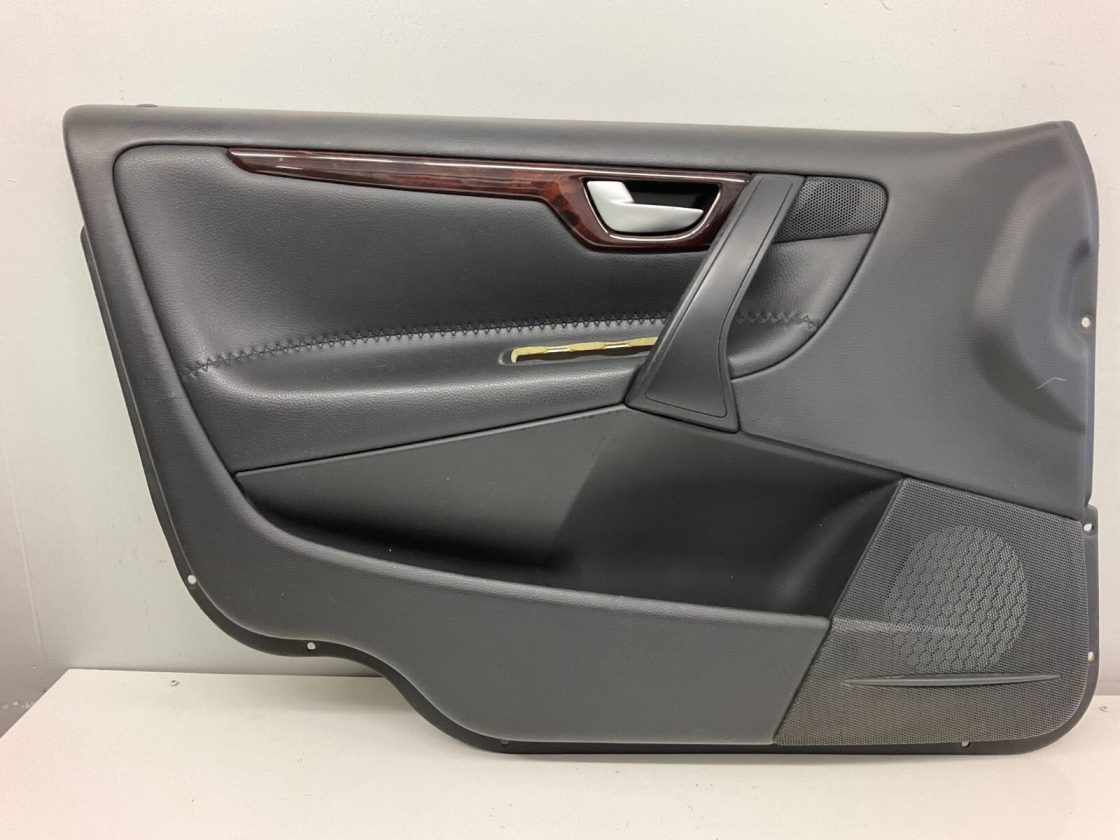

Removing the door panel to replace speaker grille
  1. little round plugs located along the perimeter of the door
  2. push in the centers of each plug, that releases the clips
  3. also 2 screws (Torx) hidden behind a beauty insert on the large handle you use to close the door
  4. lift straight up
  5. remove the door cable and the 3 wiring harnesses and viola’, it is off
2007 XC 70 door panel disassembly instructions
