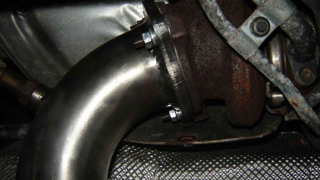

pauls60t5 » I have attached pictures of how you can fit a S60R downpipe on a 2001+ FWD S60 2.4T or T5, mostly the mods have to do with the brackets under the exhaust as AWD exhaust hangs lower then FWD exhaust. Also the earlier S60’s have a different mounting for the downpipe hangers, you just have to heat up the mounting hangers on the downpipe so you can bend them to fit the earlier mounting. These pictures are from a 2001 S60 2.4T.
How to fit a S60R downpipe on a S60 2.4T or T5 FWD
